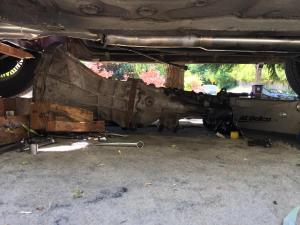

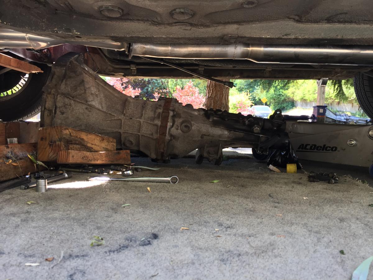

spent the day pulling out the broken 5sp and swapping in my old 4sp. while i was at it i replaced the clutch master, slave & hose connection. a miserable, wretched job to do - i'm pretty sure i invented some new cuss words in the process. probably a lot easier with a lift, a proper tranny jack and a fluid pump, but i did it on stands on my back using a floor jack and some wood blocks to lever and set the tranny. will see about getting the 5sp rebuilt and have a shop do the next swap - i've got my tranny-swap merit badge and will never do that job again. ever.

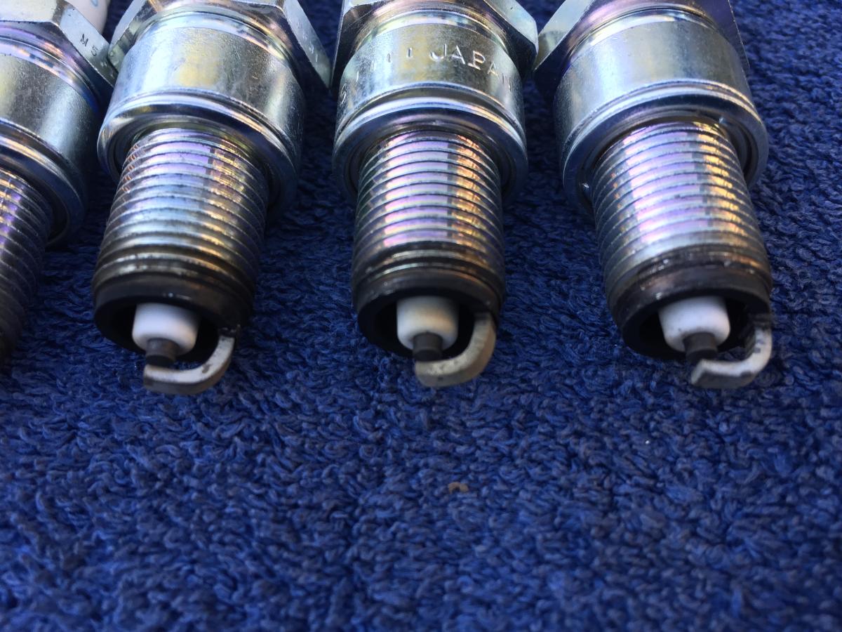

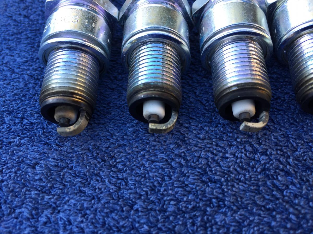

next will be installing the 02 sensors and tuning the carbs. after the first few miles i pulled the plugs and they look quite light - not sure if it's lean or if it's the ethanol in the gas. at least they're not covered in crud like the old oil-burning one did.
