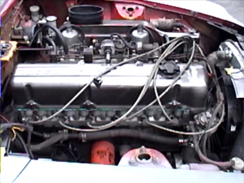

yea........ ive rebuilt the whole top half of the engine but never really got into the distributor area.... and yea i do have a shop manual so ill go check it out............ now i just gotta find it
here she is now
