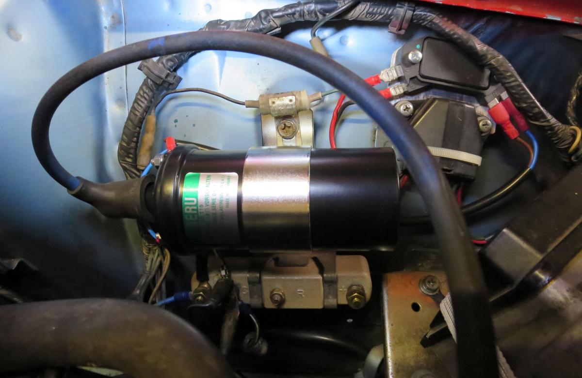

If you doubt the ignition box, you could try a GM HEI-Module. Its easy to install as a test unit, just four wires and its up and running. Doesn't need the resistor block. Here is a photo of mine when I was testing the HEI module.
post-25317-0-03929900-1421946768_thumb.j
The unit was a cheap china made unit (sorry Blue) for $10.00. After it all worked I changed to a Petronics module.
Here is the thread on my HEI mod. http://www.classiczcars.com/topic/49588-fitting-a-hei-module-in-transistor-ignition-unit-1977-280z/
If you follow the wiring diagram in post#2 it would be simple to sutup the module next to the coil on a piece of aluminium plate. Then you can piggyback of the coil positive to the module B terminal and the C terminal to the coil negative. The W and G terminals go to the distributor pickup. You don't need the resistor if you are using a 12V coil.
