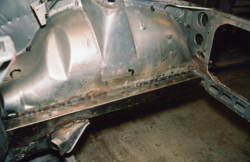

EDIT** wanted to include picture of the current status of the pans/rails if it helps.

I've used Zedd Findings floors and frames several times. They fit well and are easy to install. Based on your pictures you'll need their floor/frame kit. Last time I checked he also made the front frame rail and I think also the angled rail at the T/C rod. Those pieces look ok on your car. But you have some serious rust on the inner fenders and battery tray area that will have to be fixed. I've never used the Bad Dog parts but I've heard good things about them.

I have Charlie's floor pans and one rail in 26th. I had to locate the tension rod pocket and align the sway-bar mounts when fitting the frame rail. I was fully expecting the effort to cut and fit everything. That's metal work. I see you have some other patchwork to do. So did I. That's metal work! Take your time and do it right - it's well worth it. I can't over emphasize spending the time to make sure the chassis mounting points align.

Looks like you have some big patches that need doing, do yourself a favour and get your car up on a rotisserie. Welding on your back is akin to torture.
