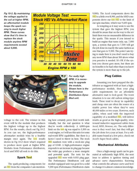

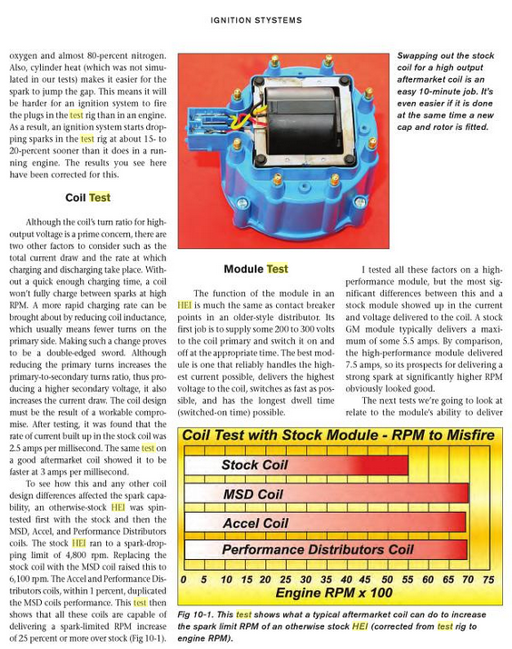

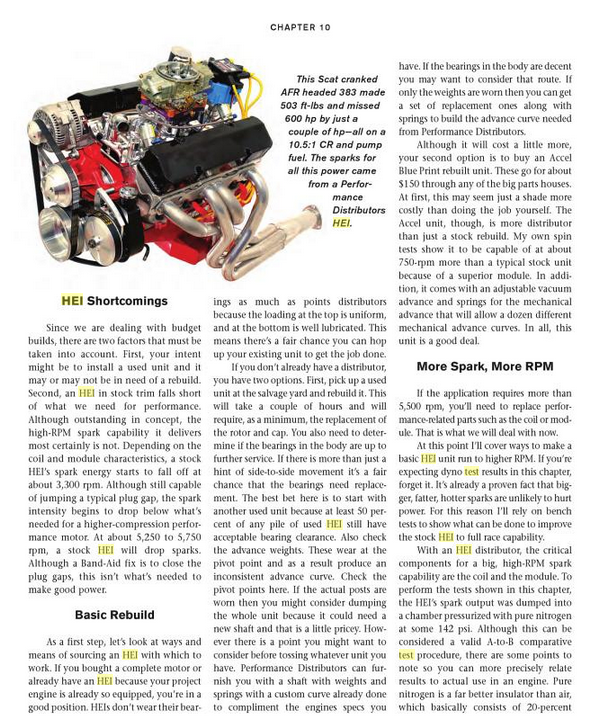

I've always wondered where the 4500 RPM limit "rumor" about GM's HEI module came from and finally found the source, in a book David Vizard authored called "How to Build Max-Performance Chevy Small-Blocks on a Budget". The relevant pages are actually available on the internet - [h=1][/h]
How to Build Max-Performance Chevy Small-Blocks on a Budget - David Vizard - Google Books
I was a little disappointed after reading all of the the various things that Vizard has written. In the end it seems like he's using the old technique of selling aftermarket products by pointing out "flaws" in existing product. I think that he started by selling MSD product, then went to DUI distributors. He even plugged Pertronix in one article. In some of his latest stuff he's lowered the "weakness" limit to 3300 RPM.

Just filling in some gaps before I lose all of the links. If you read some of his original writing, it reads like good science but is short on actual measurements. The weak spark limit seems to be a supposition based on "module voltage output". He never actually measured if there was a misfire, just said that there should be.
For the record...
Yeah, that sure starts to sound like marketing propaganda aimed at increasing your own sales by torpedoing someone else's product.
I used to take my GM to 6000 RPM every once in a while and it never gave me any trouble doing that.
Found another Vizard article where he shows actual dyno results with a module change (stock coil though, apparently). Above 5000 RPM (V8 engine, = 6,667 L6 RPM), he shows a dramatic change. But he's still promoting MSD and Performance Distributor products. Just odd that there's not more out there on this.
