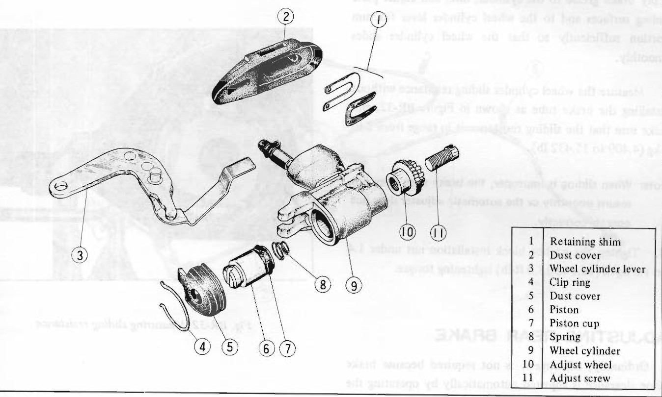

quick question. Ordered the left and right wheel cyl's from rockauto and they keep sending me the right side. What are the difference between the rear left and rear right? I have a 6/72 240Z.
Thanks!

it looks like the adjuster and parking brake hardware, not the bleeder
Great photo! Ok so no way I can use the right cyl for the left wheel? Looks like Wagner doesn't have the left anymore for 6/72 Z's. Might have to buy a rebuild kit then.
Most chain stores have the same. Not on their shelves but an overnight thing. Google the part number.
You will have to bend the hard lines as the port angle changed.
