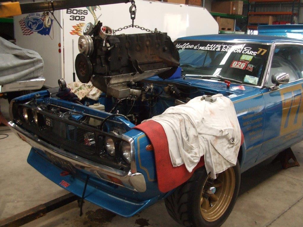

Well the plan was to just a simple freshen up, but that is not going to work. Engine out
and inspected.

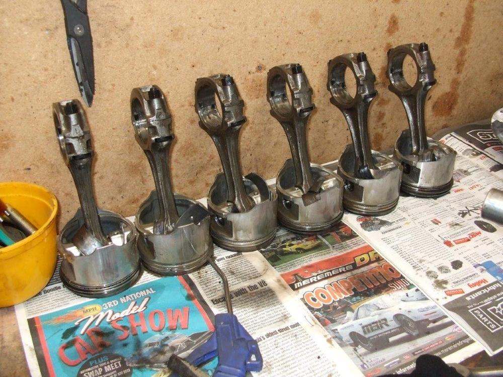

The block was already bored to around 89mm so after sonic checking, we could not even get a hone, the leaking headgasket has scoured the bores.
So luckily found a fresh unmolested block (thanks Don - who sold me the car for letting me have one out of his collection).  This is currently off being linebored and we are going to reuse the deisel crank and 260Z rods as they are in good shape.

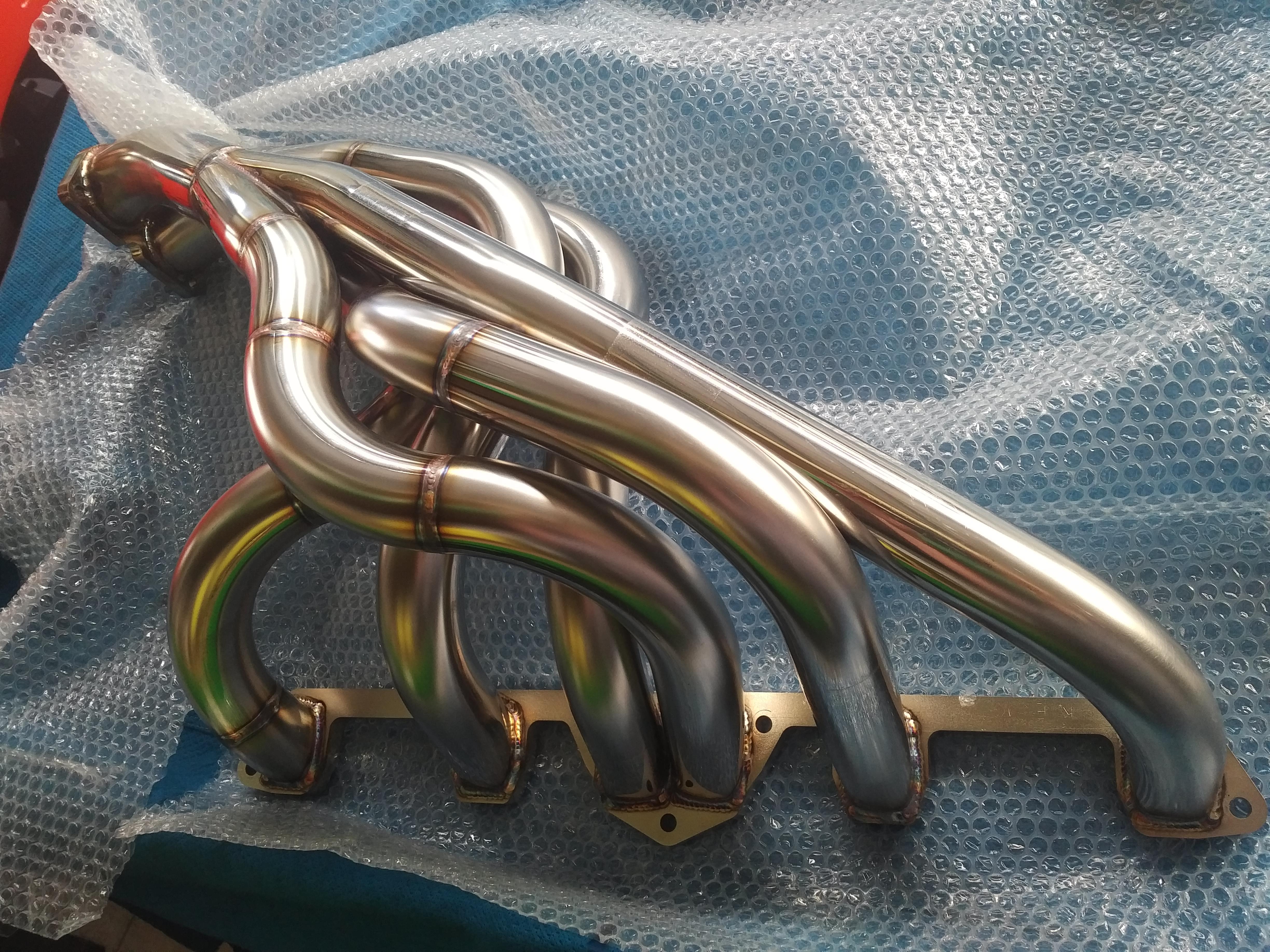

The old sump is looking a bit sad as it has been modified a lot of times and the exhaust headers are rusted out from running the leaded gas (and their ten years age).

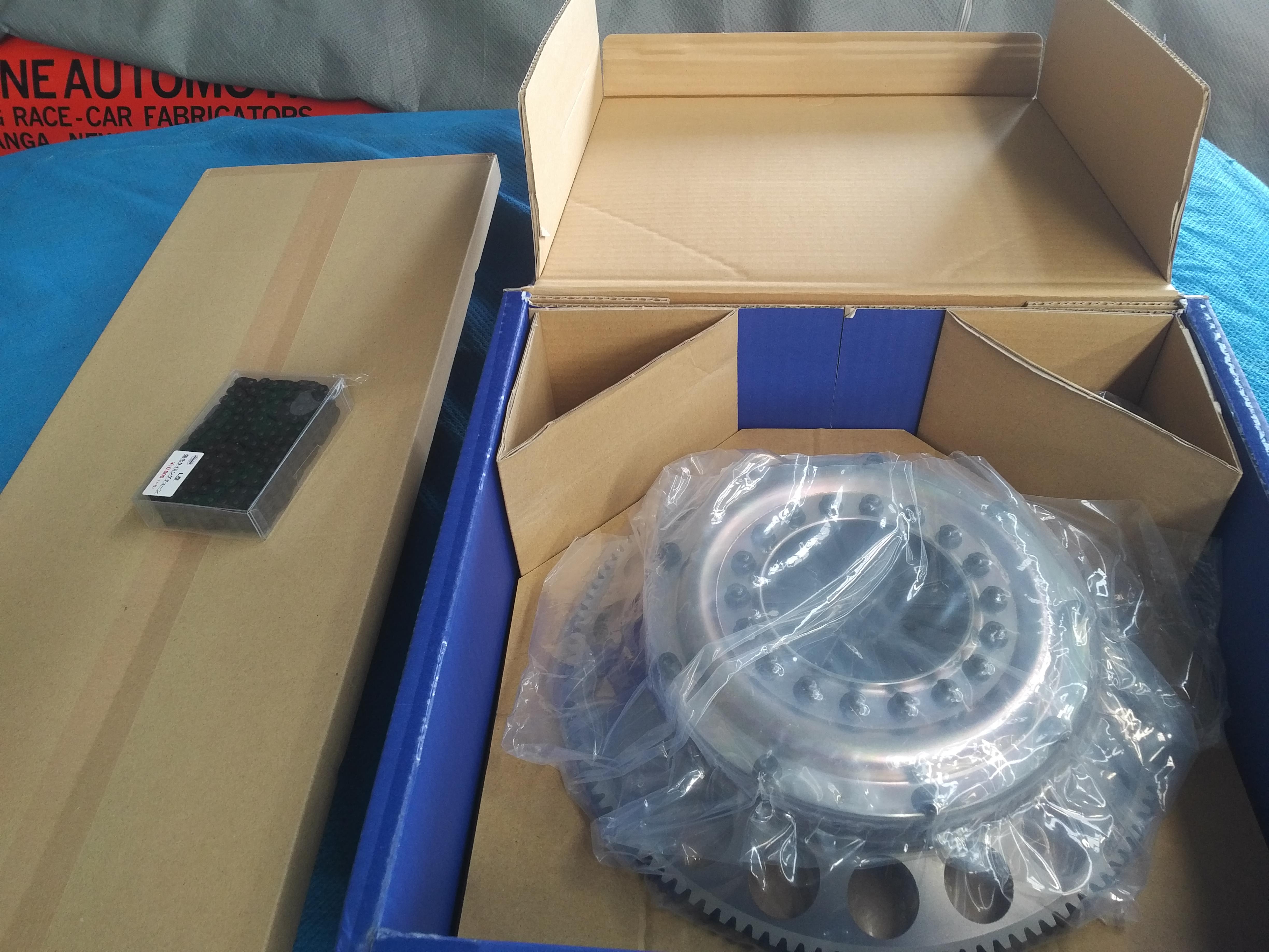

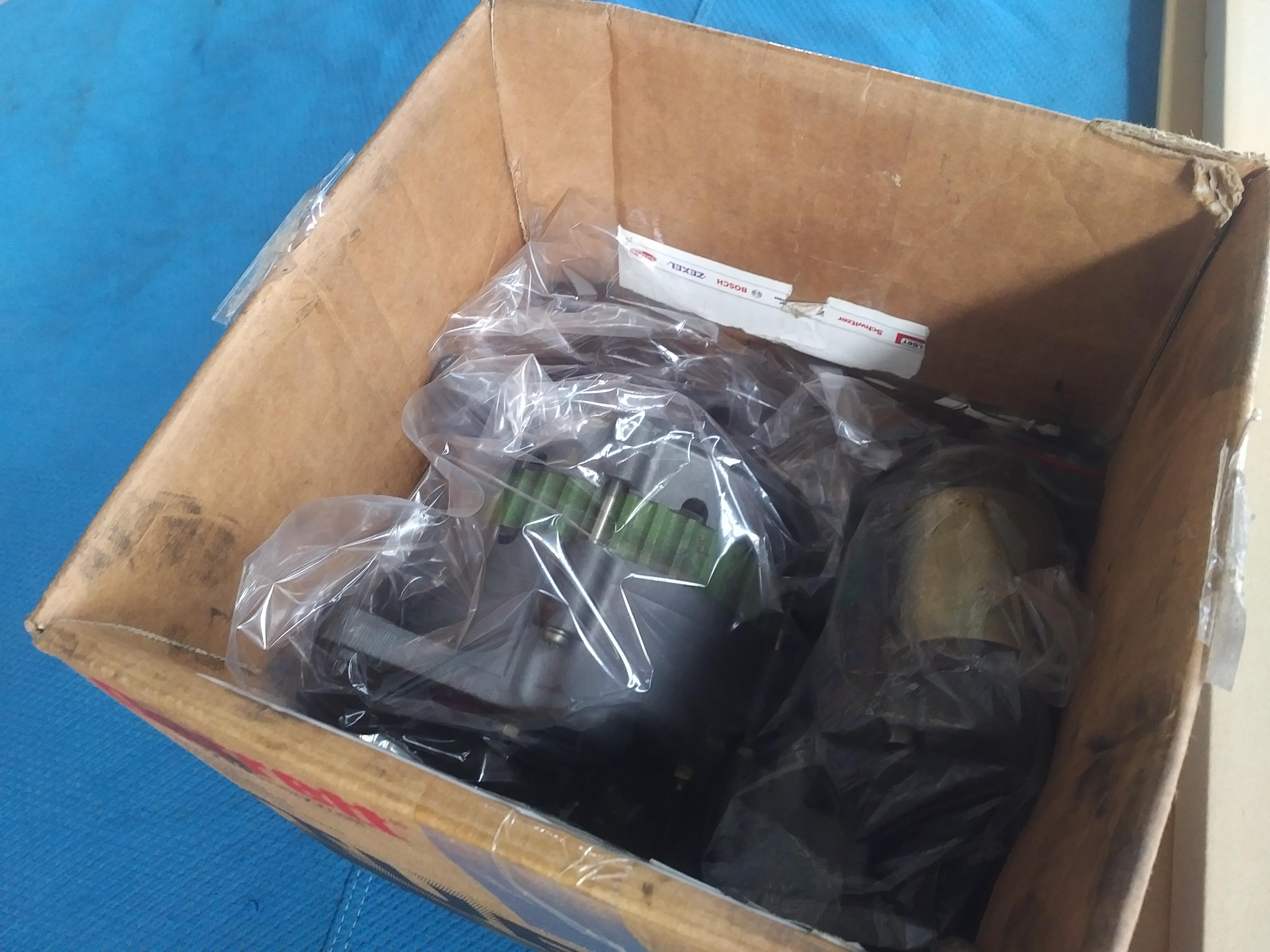

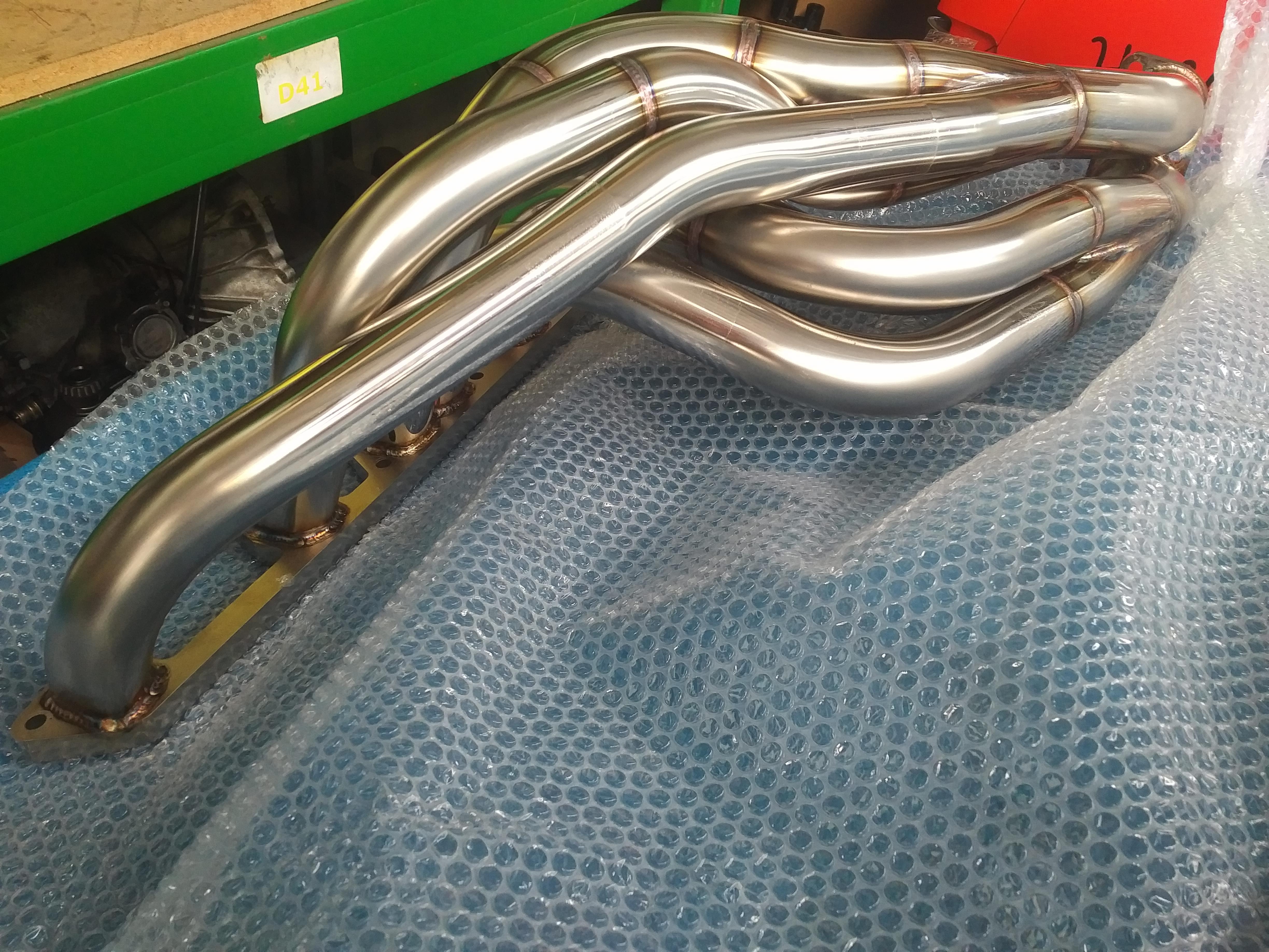

So had my first delivery from Japan. new exhaust manifold, new clutch and had the starter motor and alternator rebuilt.

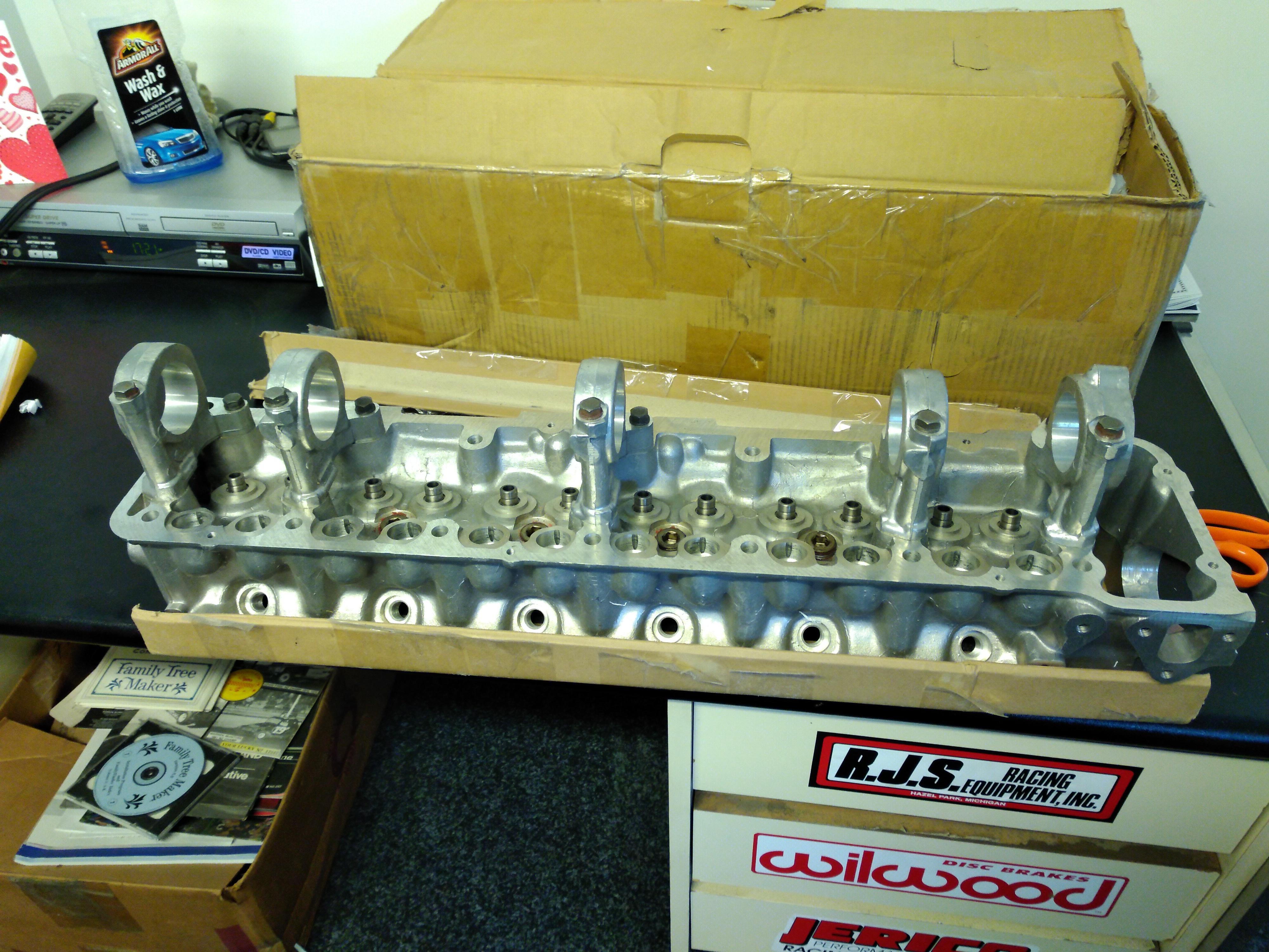

Bought a NOS head from this site, thanks so much Garrett (inline6), its a P90 so will require a bit of work to get high compression but great place to start.
Managed to buy NOS lifters and related parts from Nissan Japan and some Valves and retainers from Kamaeri.

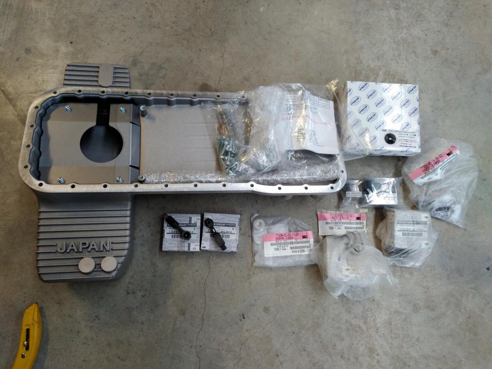

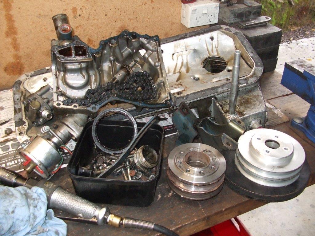

And i turns out the Hakosuka sump fits the Kenmeri, so got one of those with a kit that ties into the gearbox.
