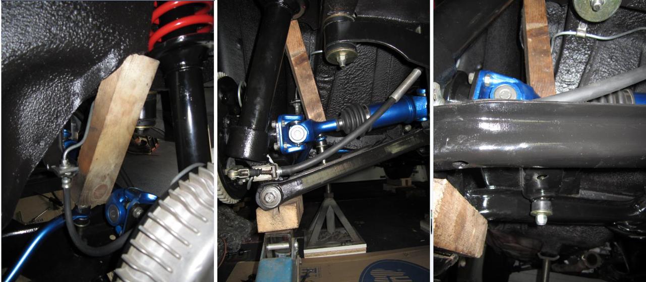

I managed to get them to fit with the bolt supplied with the energy suspension kit. I put the bolt in from the top and wedged a piece of wood between it and the body. That way I could compress the bushes enough to fit the nut.
