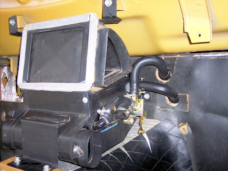

Here's a pic to let you know what the hoses look like with everything else out of the way. Agreed that pulling the dash is a PITA and possibly a step too far. With your A/C in the way, you still have a quite a job ahead of you to clear out the blower assembly to get to the hoses. Get the passenger seat out for some room to work on your back. Don't forget to replace the water **** valve while you're in there. Good luck!

Thanks for all your pics and tips. I'm going to replace all the hoses with steel braided I think depends on the cost diff. it'll probably be cheaper to get all OG from the dealer. Is the water **** valve that fitting that the hoses are attached to in the picture?
Yes that's it, a cable from your heater control panel hooks there and opens and closes it. Mine is frozen up and crusty. I just got a new water ****-heater valve yesterday from my Nissan dealer, $45.78 tax and all. Part #27116-E4400. After reading everyone's comments on standard heater hoses I may get the original equipment braided ones. They're out there, price wise for sure, $100 for 2 hoses and the firewall grommets. Maybe I'll use the Gates that I have already?

I'm gonna say that stuff would be hard to bend enough to hook to the heater valve. Mine has some off the shelf lines on it now and they're pinched off from the sharp bends. They need to be pre-formed or bent. The big ones for the top and bottom radiator hoses would be super nice! I'd like to have those too.

I can see from above interior pictures the hoses used for the interior heater core are wrong and way to long. Check both the valve for leaking and the heater core. I've been there myself and have taken it out, without removing the dash. It's a few hours work. The picture jfa.series1 posted above is how it should be connected :)
OEM style radiator hoses would be enough, stail braided isn't really necessary.
