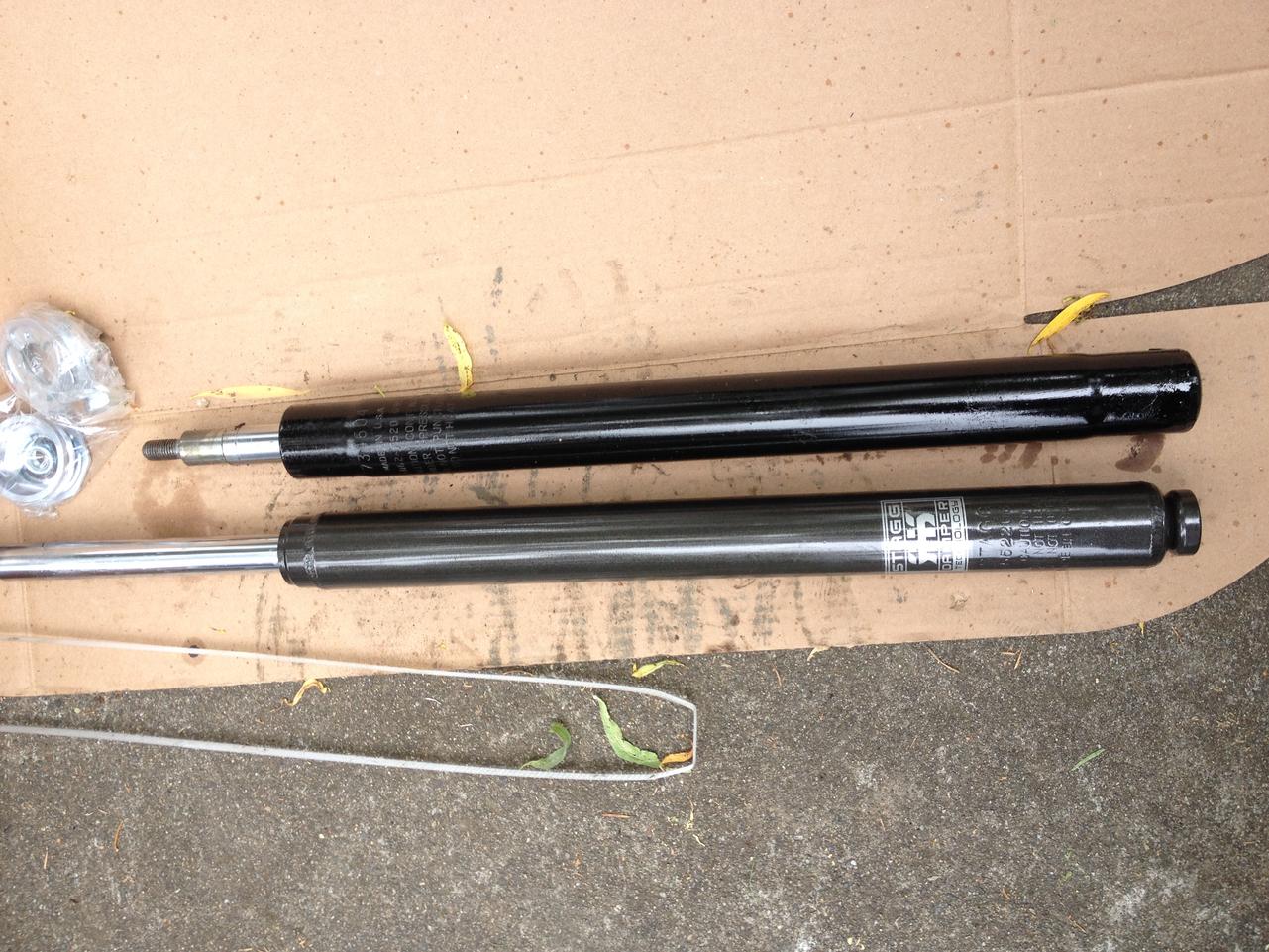

the original struts were toast – no gas left, fluid leaking, useless.
the rear boots were filled with crumbled purple stuff, i believe it was the disintegrated bump pads. the staag struts seem just fine – no, they are not adjustable, track-ready units, but they were shockingly affordable and fit perfectly. the kyb boots were pretty cheap - plastic vs. the oem rubber ones. i actually wound up cleaning and re-using the stock boots on the rear, mine were in great shape.

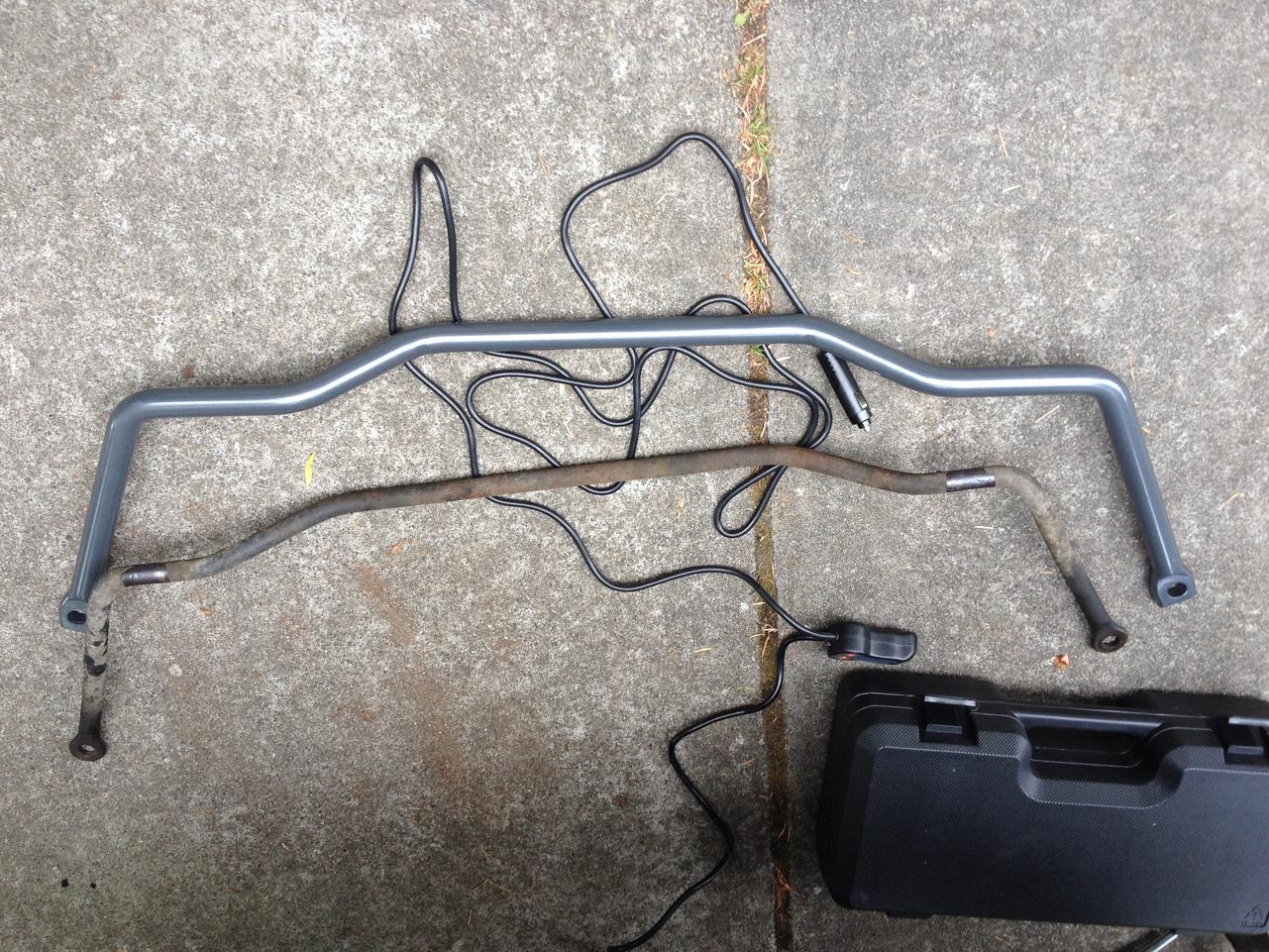

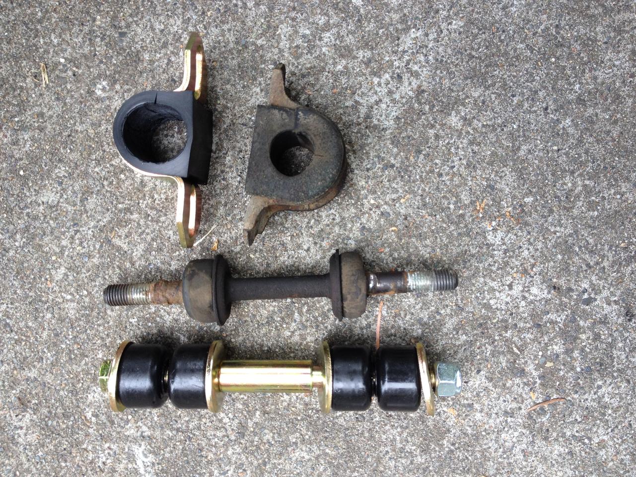

the swaybars were simple and installed w/little drama – only tricky part was have compressing the pin bushing sandwich enough to get the nut on the end. wound up using a c-clamp to get it done. needed to split the exhaust at the center flange (between center resonator and rear pipe) to get clearance for the rear swaybar removal/install, but no biggie. nice quality kit, very happy with it.

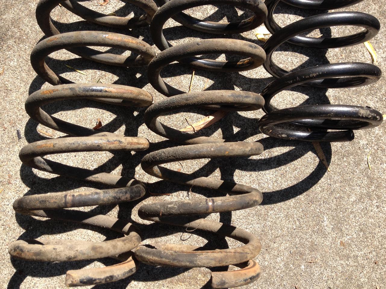

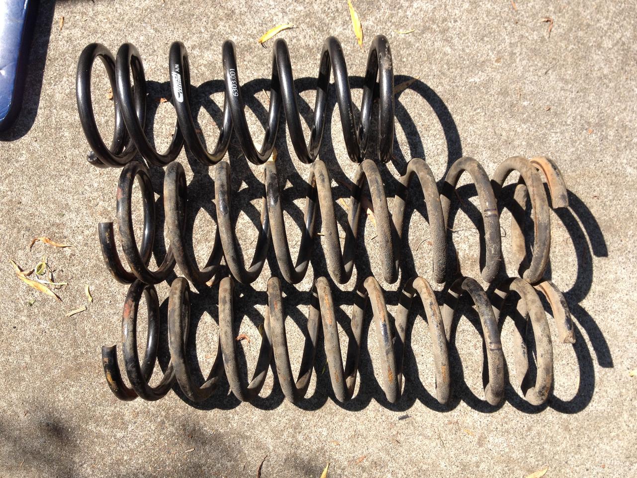

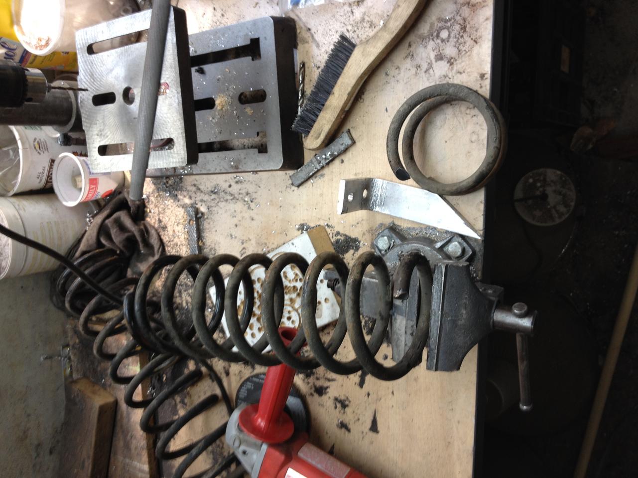

had an “oh, sh*t” moment when i took the eibach springs out of the box – the rear springs are waaaay shorter than the stockers, so much so that they don't even touch the perches until the car is lowered down. i thought i had been sent the wrong kit, but a few looks online and apparently that’s the way they are.
put her all together and was very disappointed to discover the rear was way lower than the front, and the handling was crappy – harsh, jumpy, not good.
so i decided to go the old-school route and cut a couple of coils off the stock rear springs. 5 min. w/an angle grinder and all was good. took me longer to clean and paint them than to cut them.

So you pulled inserts out? You were thinking that you might have the original factory strut guts, but apparently not. What brand did you pull out? I can't read it on the pic.

the struts that were in the car had no branding on them - just black casings and a warning about pressurized gas (no longer applicable).
the car feels really nice now: well planted and quite settled. the swaybars make all the difference in the world when cornering (thanks for the tip Blue!) and have all but eliminated body roll - a total transformation from before (felt like a minivan in comparison). the springs/struts seem to do a better job of keeping the car from getting wobbly over bumps... just seems more settled, balanced, with less translated to the steering wheel.

I may have discovered your initial "Rear too low, front too high" problem after the initial Eibach install.
The 6203-001 springs are the fronts, the -002's are the rear... The picture you show in post #1 where the 6303-001 part number is visible on the very very short spring next to the stock rears was the clue. Many many of us have been caught by that little detail in the past.
You likely accomplished much the same spring rate by using a shortened rear spring anyway. Someday when you're bored you can switch the Eibachs around and see if you prefer the ride and likely somewhat lower ride height any better. It looks just fine the way it is.

oh crap - you mean i now have the rear springs on my front end?!? does anyone know how different an eibach progressive rear spring is from a stock front spring?
the surprising thing is that this arse-backwards setup dropped the ride hight about 1" and seems to be riding really well... but of course now i'm wondering if i should swap everything back out??

Here are some rates: http://atlanticz.ca/zclub/techtips/springs/index.html
Most seem to have rears at ~ 13% stiffer than fronts.
You are now at front: 212 lbs/inch and rear ~ 151 lb/inch (approximation with the 2 ring cut factored in).
So you are skewed with rears ~ 30% weaker than the front.
It would be good to correct as this may make the car twitchy.
