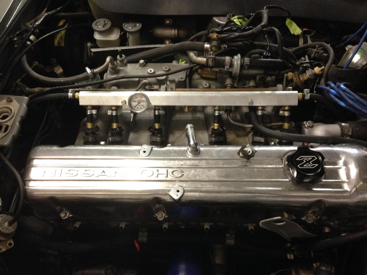

May 11, 201411 yr comment_447628 As I mentioned earlier, here's a pic of my Pallnet fuel rail I just installed. Very simply design, you could do it yourself if you wanted to. For me it was just easier to pay $150 then try to drill and tap all the holes straight and correctly spaced. Right now I just have the FPR near the firewall, I need to find a permanent place to mount it. Link to comment https://www.classiczcars.com/forums/topic/49170-fuel-rail-questions/?&page=3#findComment-447628 Share on other sites More sharing options...
