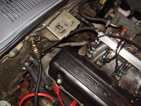

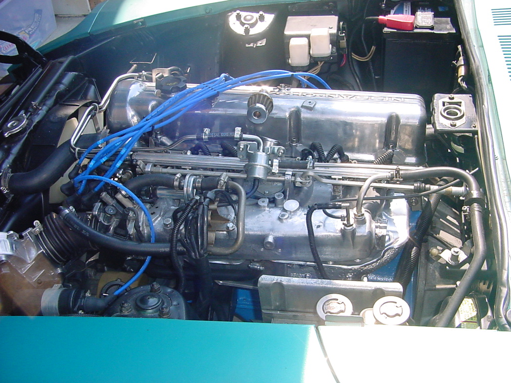

May 6, 201411 yr comment_447307 Well, mrj45, it doesn't really have to go on the firewall. If you can direct your eyes to siteunseen's photo just prior to his extraordinarily top-heavy fishing companion with the small, golden bandages tied to her body, you'll notice that the return line comes off of a "T" at the back end of the fuel rail. The hose coming off the driver side of the "T" feeds the cold start valve. An alternative configuration might be to have a hose running from the back of the rail to a "T" near the cold start valve. Then mount a FPR to a bracket in that same area, fed from the "T" and emptying to the hardlines that run around the front of the head. If you want to make it neater, put a barb connector into a 7th hole just behind the #6 injector, so that the return hose drops down beside the line of injectors. Then put a plug in the end hole. Better still, figure out some way to bracket a hard, stainless return line in parallel with the fuel rail. There's something seductive about the plumbing of an engine if done neatly.-----------------------And speaking of "clean," Tomo, those hardlines and your FPR look quite fetching! Do they just polish up like that, or are they chromed? Edited May 6, 201411 yr by FastWoman Link to comment https://www.classiczcars.com/forums/topic/49170-fuel-rail-questions/?&page=2#findComment-447307 Share on other sites More sharing options...
May 6, 201411 yr comment_447313 http://www.summitracing.com/parts/msd-2222?seid=srese1&gclid=COGdjrL3lr4CFU4R7AodJSAAAw, I think that's what is on the car in the picture. Or this Bosch,http://www.summitracing.com/parts/bch-0280160001/overview/ I had a lot of sleepless nights thinking about this, not really, boost vs. vacuum and how it would work on my car. Never could find a good enough explanation so I went with the single "IN" FPR for the '78s. Zip tyed to the firewall wasn't my end goal but as you can see from my pictures, looking past Billie Jean Dance, once I got it running right with the coolant sensor tweak I haven't even cleaned the engine bay up. Just driving it and enjoying the rides with my dog, it's funny as hell watching her try to anticipate the shifts. When my hand goes to the shifter she leans forward, then I pin her to the seat until 6,000. If I leave the door open just for a second she's in there, and loves it my PETA friends. After some coffee and my meds kicking in I think it's the Bosch in the picture. It has to be the Bosch, I don't see any vacuum source. Edited May 6, 201411 yr by siteunseen Link to comment https://www.classiczcars.com/forums/topic/49170-fuel-rail-questions/?&page=2#findComment-447313 Share on other sites More sharing options...
