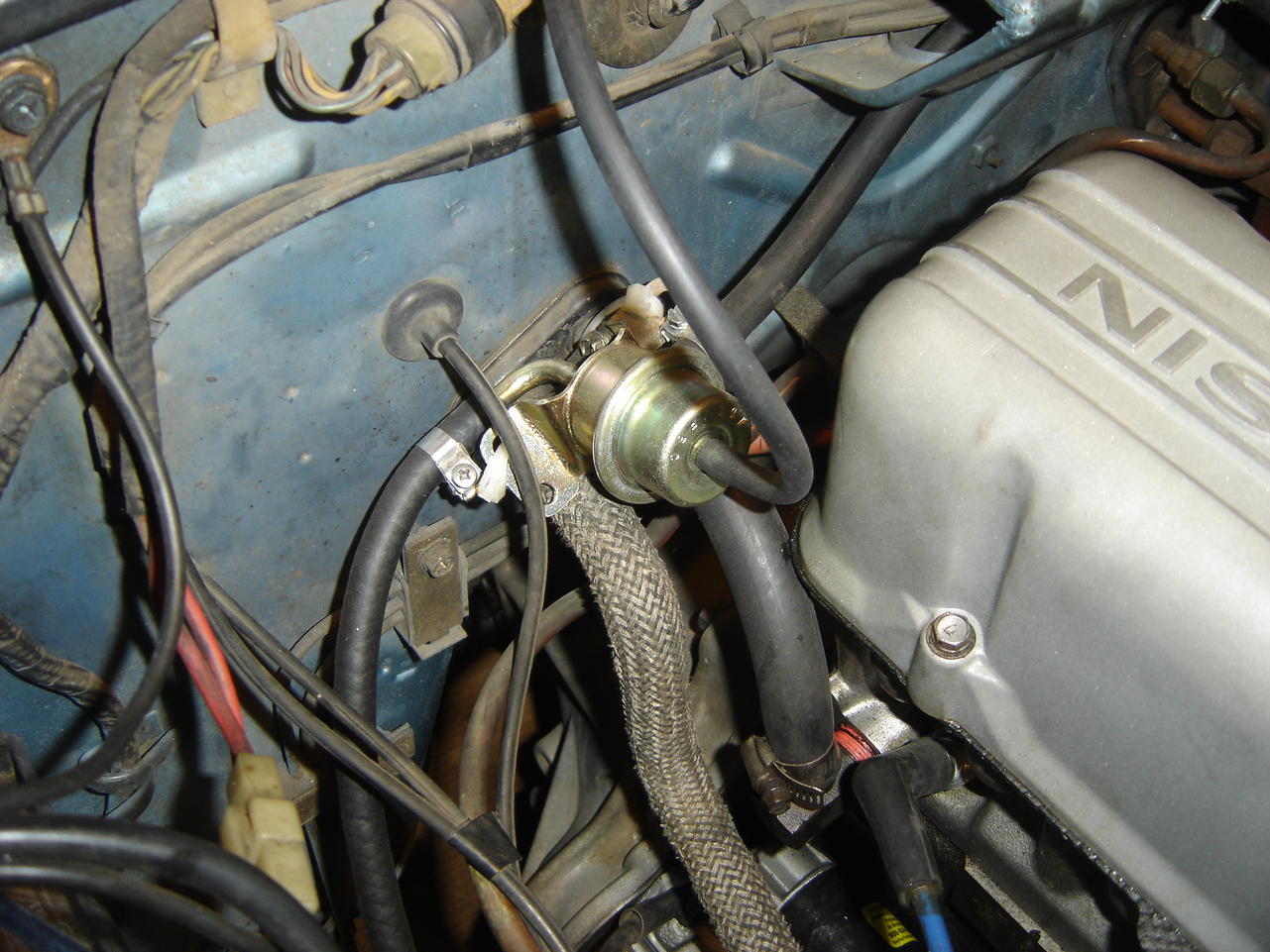

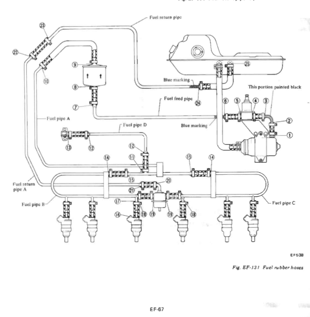

You might be looking at the ports on the FPR backward. The center port on the bottom of the FPR is the return port. Fuel is fed in to the rail directly, then the FRP acts as a pressure relief valve, bleeding excess pressure off through that center port.
If you have old hoses on the stock 1975 rail they might have longitudinal cracks that will seep or squirt fuel. I had an episode of a tiny three foot stream of fuel squirting out of an old injector hose once. A 1978 rail is solid steel (no connecting rubber hoses like on the 75-77 rails) and will bolt on directly, but it will need the FPR it came with also.
Attached a drawing...

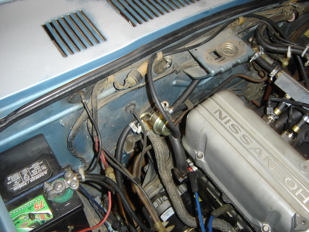

siteunseen's link has all of the relevant information. I assume you''l be using it as a guide? One area I made a mistake on mine that needed fixing, was I left it too long in front. There's only so much space available between the injector and the thermostat housing. I had to grind a corner on mine to get it to fit. I could have recut and retapped but I didn't even know if it was going to work. Future fix. Good luck.
My only mistake (:stupid:) is I didn't check the levelness and the up and down plumb? when I tapped the 6 injector holes. 4 are straight and 2 aren't, but they're separated so only a OCD person like myself would notice. I would, of course, not get in a hurry and check the levelness between each drilling. I guess the force of my drill press caused the rail stock to move in between holes. Clamp it with cardboard or luan wood works best on the press. Use plenty of oil or spray lube on the drill bits and the taps. This is the only thing that wouldn't melt down onto my heat shield, Permatex High-Temperature Thread Sealant (.2 oz) 59214: Get the best Pipe Sealer & Teflon Tape at Advance Auto Parts.

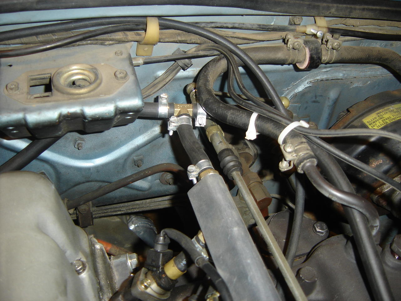

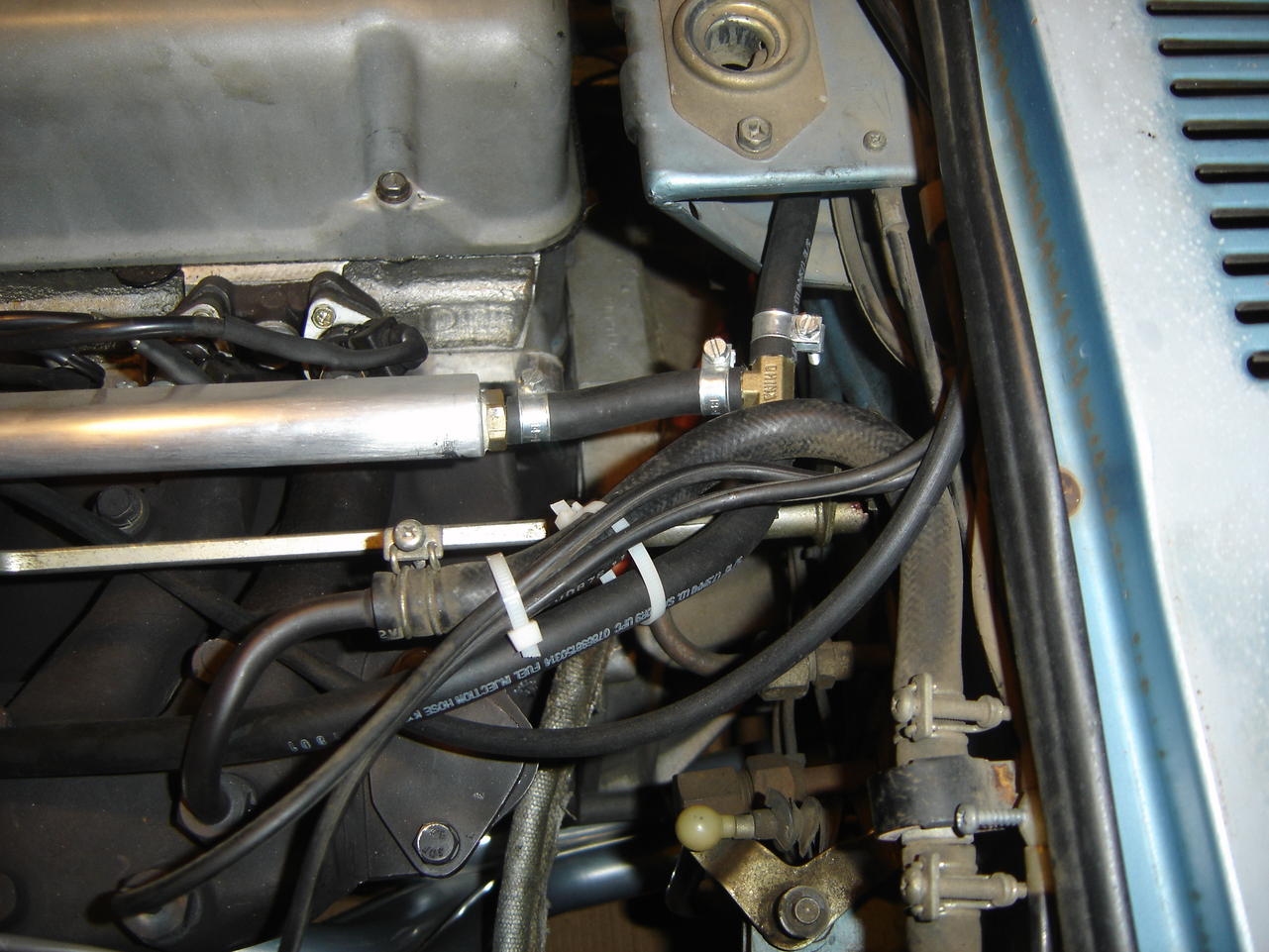

Oh yeah, I didn't drill the ends just tapped the threads. The hole is already perfect from rossmachine.
Oh yeah again, I didn't do a barb for the CSV, just T'd out the back. One goes to the FPR the other side to the cold start valve.
