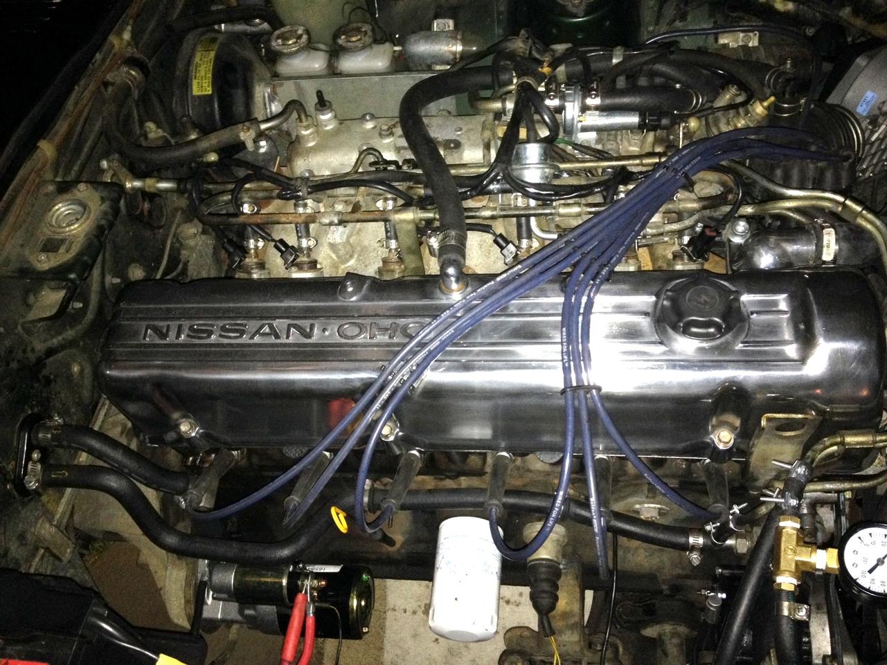

adjusted valves last weekend and the gasket tore a bit, so needed to go back in to replace it.
we used the "cold" spec when adjusting, but the engine was still a little warm and i went back for a quick check while i was in there. got the engine right up to good & hot then got my feeler gauge handy. turns out 7 of the 12 were tight, so i spent 10 min. w/the crowsfoot and torque wrench and now she's all good.

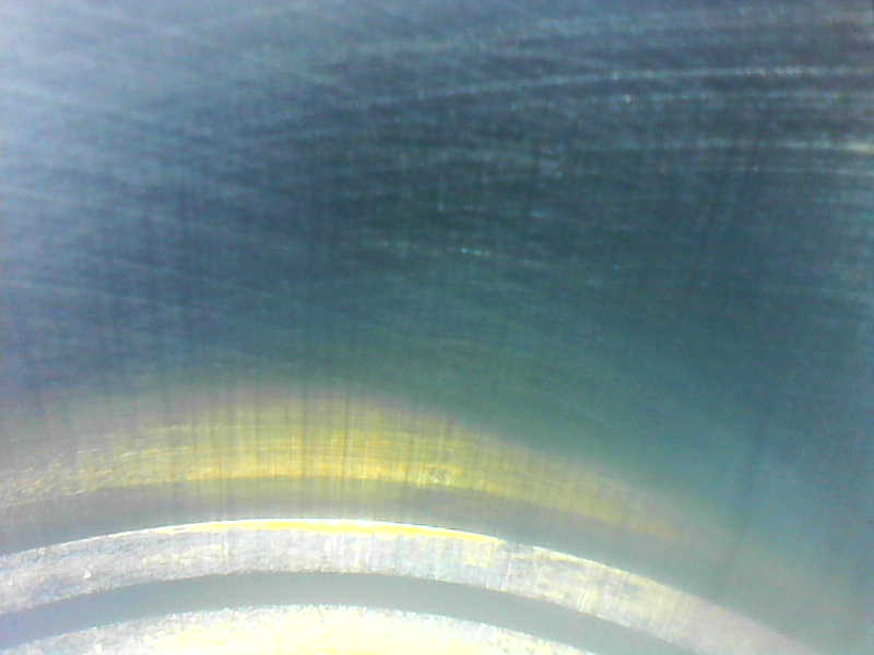

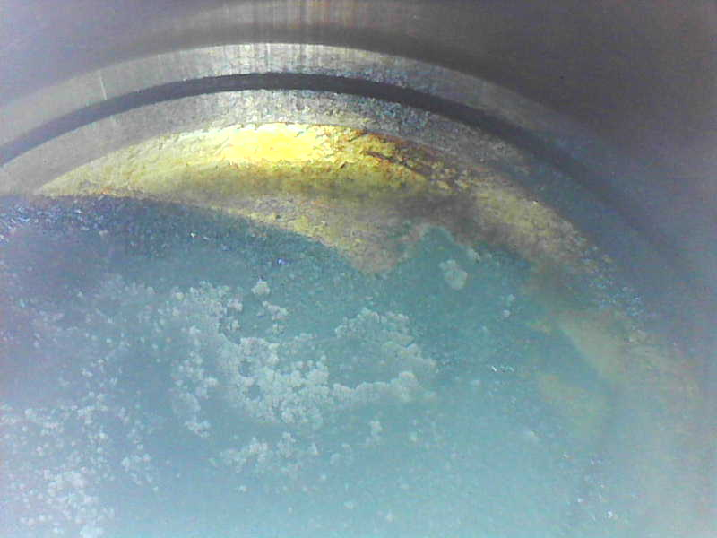

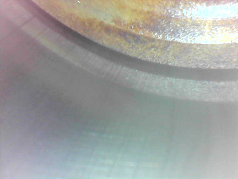

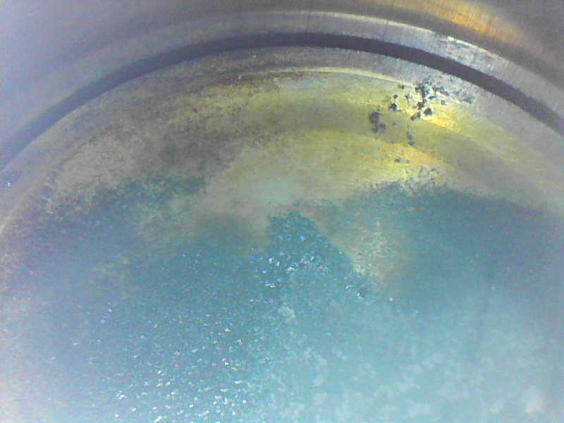

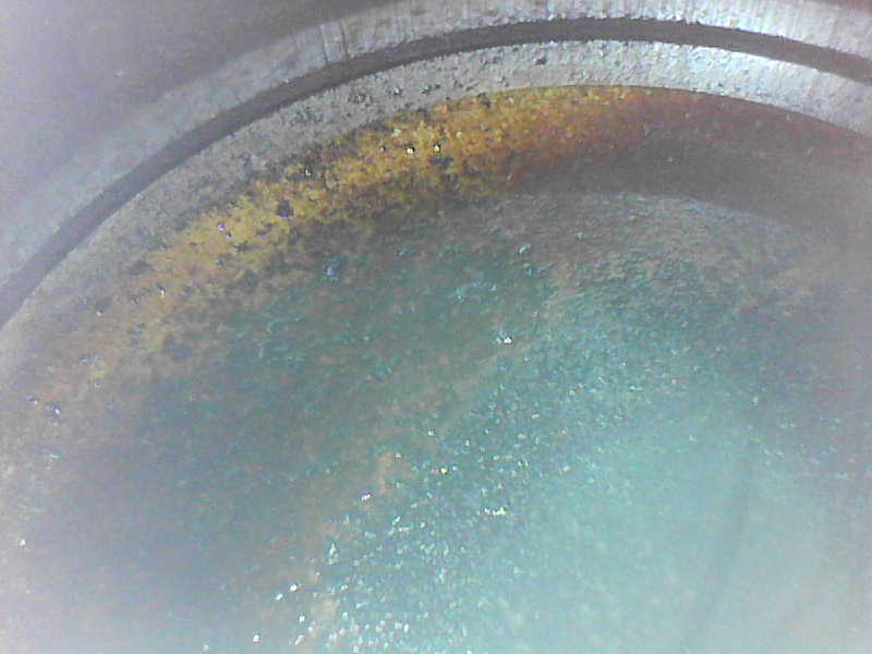

prior to the valve adjust i got some low compression readings, and was wondering about the condition of the cylinders. ordered an inexpensive wifi borescope online and it had just arrived, so i poked around inside the spark plug holes and took a few pictures. it was pretty cool to be able to see the piston tops and i was excited to see that the cross-hatch pattern was still visible on the cylinder walls on a +35 yr old engine with 148K miles on it! it's not a professional grade tool, but you can clearly see the dished pistons and the carbon patterns. the camera head is a little big, so there's limited mobility once it's in the hole, but i'm happy for $70.

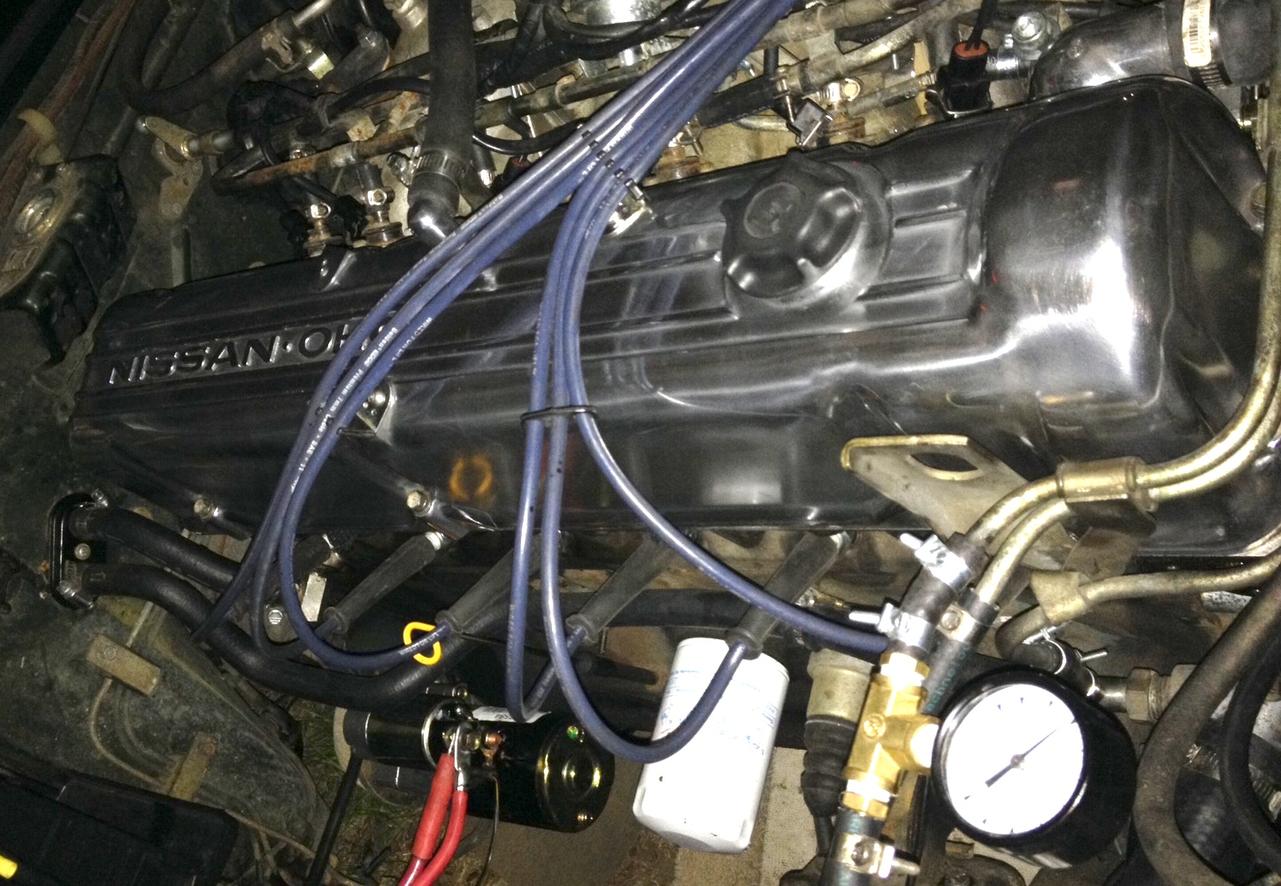

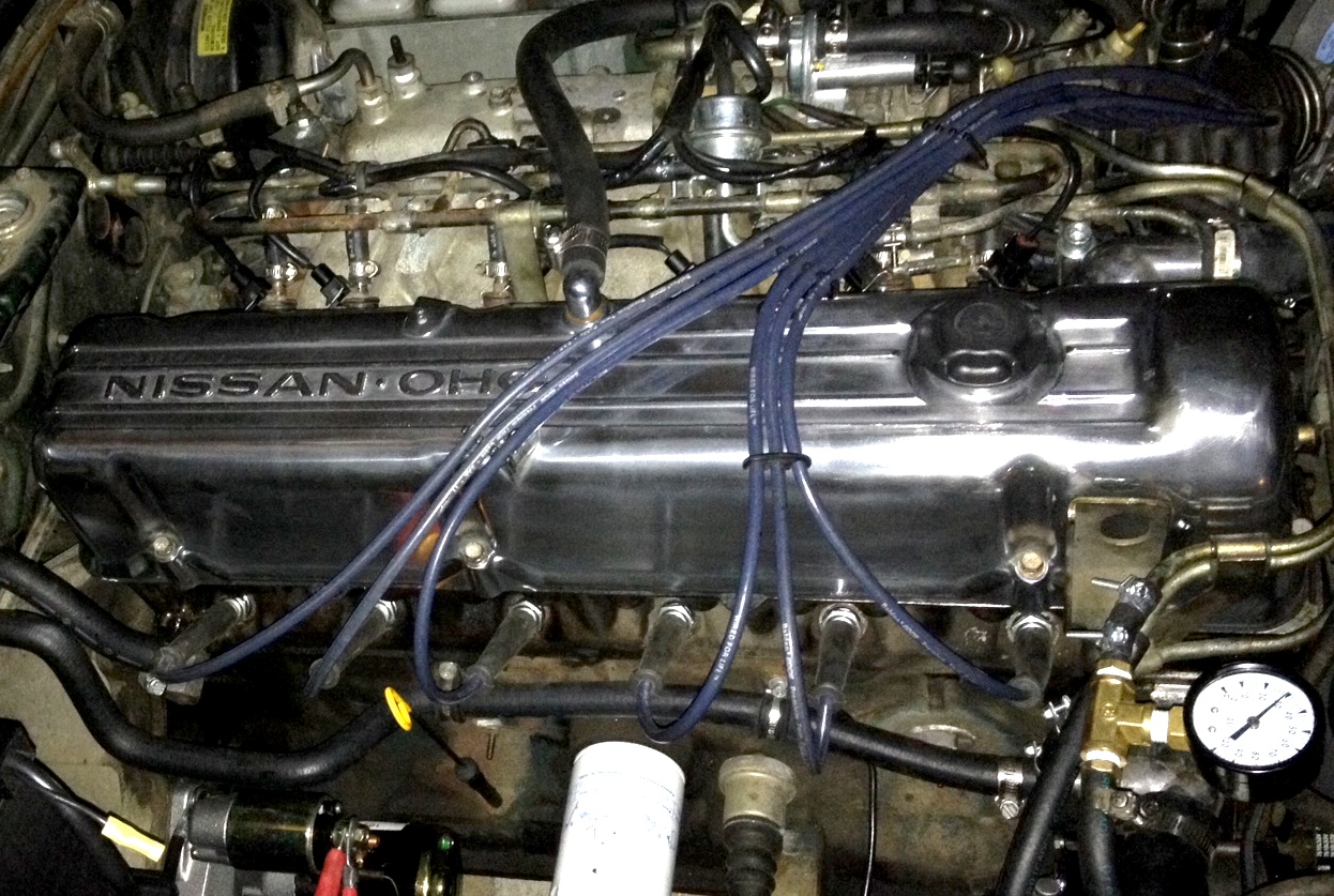

in celebration i decided to treat her to a little valve cover polish - a half hour of sanding and a few minutes on the wheel and presto! shiny bits :}
only problem is now that manifold is suddenly looking shabby by comparison...
Edited by rossiz
Actually the piston tops look pretty clean too. It would be interesting to do the seafoam treatment to see how it cleans up the pistons- if it does
WOW fantastic! Love the shots.

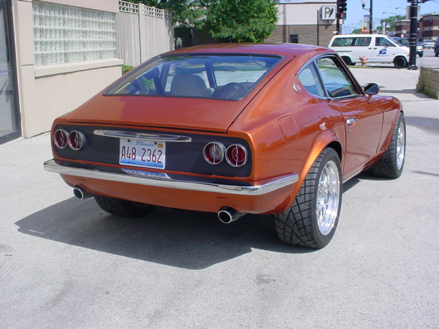

@ gnosez: beautiful car - love the look, but i'm thinking of something a little different, maybe send the twins through the valence w/an escutcheon trim ring, kinda like i've seen on old jags/corvettes/mustangs. the concept is evolving the more i look at what other folks have done. lots of great inspiration out there.
