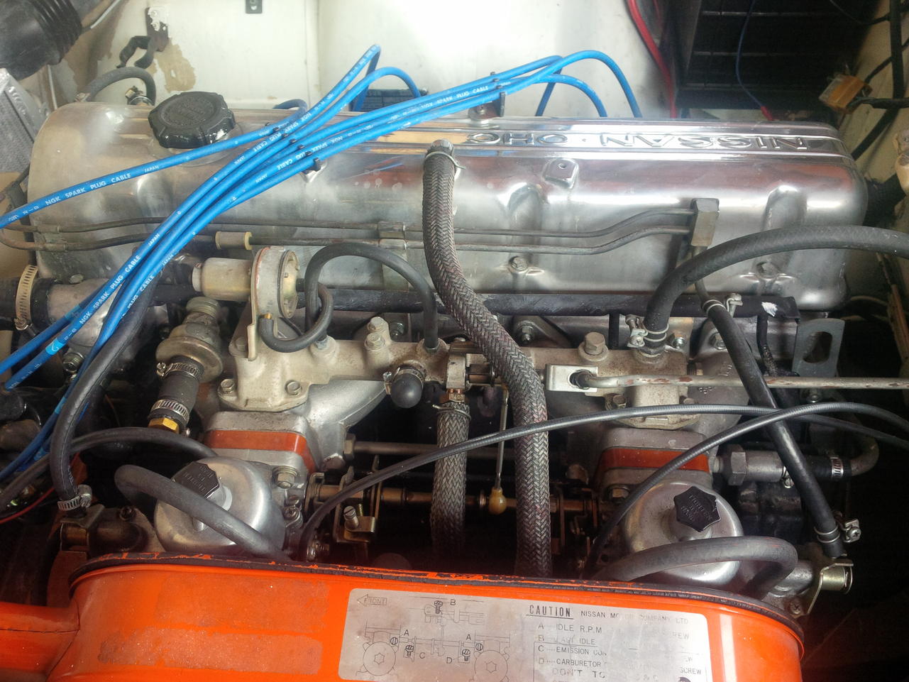

Its a bit rough. The symptoms are the following:
Start the engine, drive on free way and everything is fine. Under this circumstances it idles between 1,100 and 1,200 rpm. However, if i get caught in a heavy traffic jam the car starts stalling and decreasing from 1,100 to 800 rises again to 1,100 and occasionally goes to 500 rpm tending to shut the engine down. In this situation i reach to my destination and let the car idle at the parking. RPM starts lowering and eventually shuts down. It does start back again but i have to give it some gas pedal.

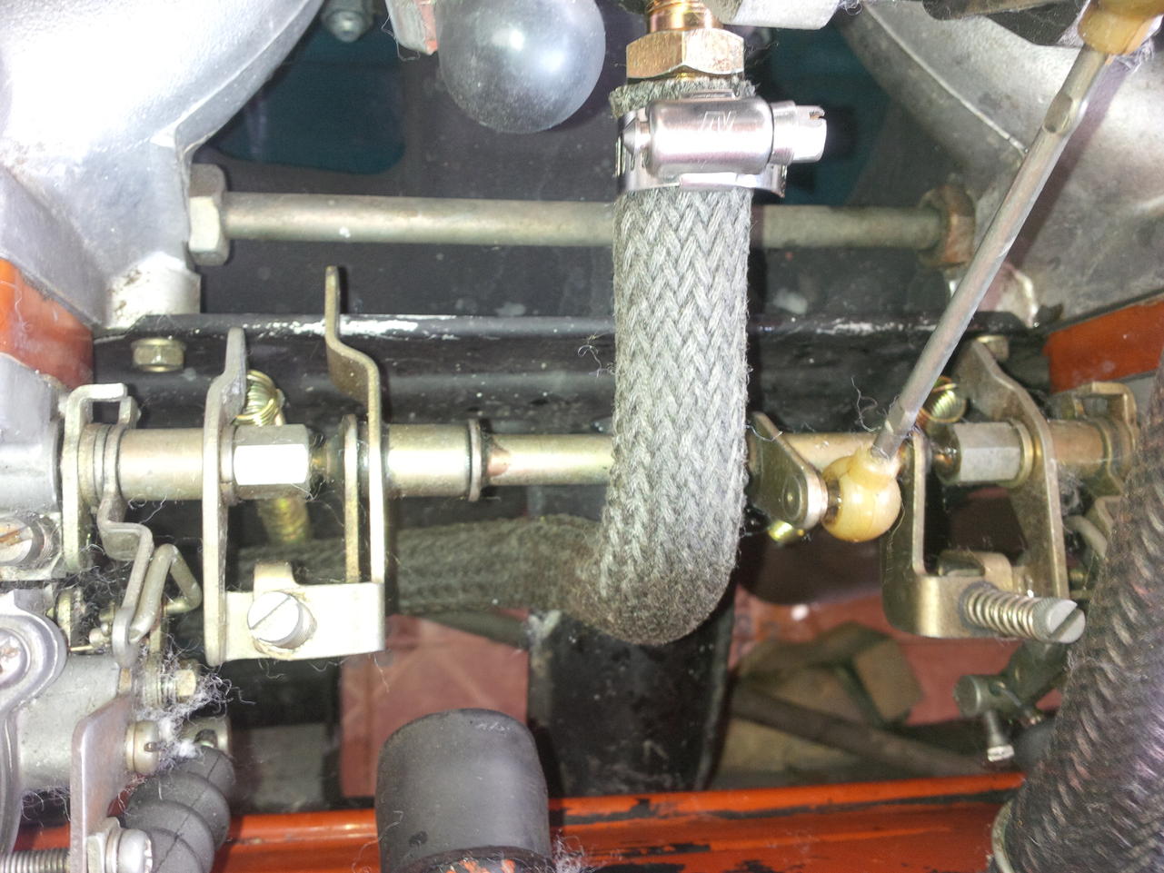

I have already sprayed carb cleaner to all the hoses and connections looking for vacuum leaks and have found none. I did remove the EGR system including the servo diaphgram as it was broken as shown:
Hope one of you can point me out to the correct direction so i can solve my problem.
