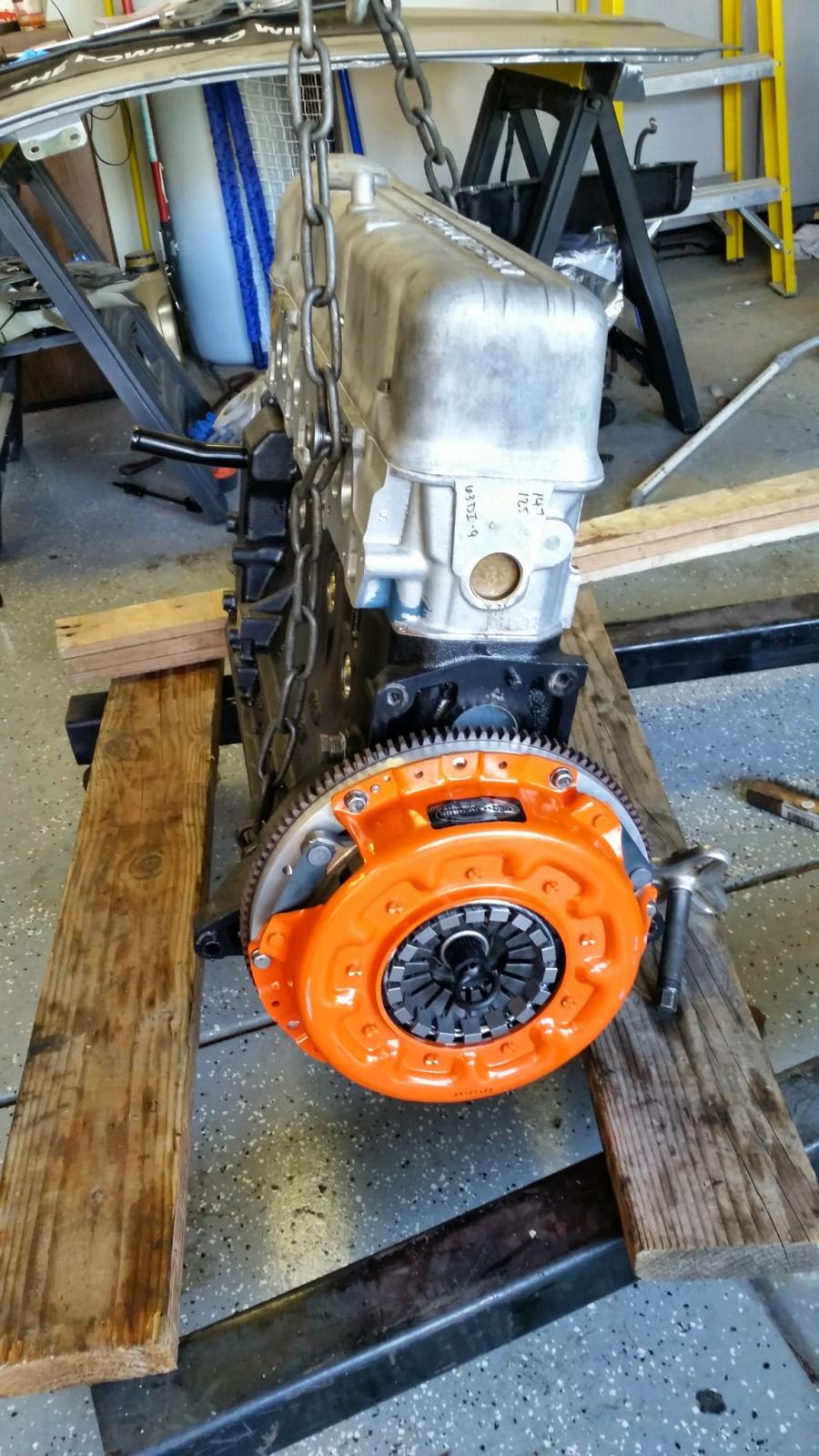

It sounds like Ill have to get the wife to crank the motor by hand while I investigate.  I didnt measure but if I had to guess I am seeing interference at every 1/2 rotation of the crank.  I do have an automotive stethoscope, I'm sure it will come in handy.  Ill also try and get in touch with rebello today, I dont intend on tearing this down myself if theres some fatal flaw within it.
Clucking sound solved! One of the clutch slave cylinder mounting bolts were too long and rubbed against only part of the clutch causing the intermittent clunking. The bolts were in the car when I bought it and did not rub on the OEM clutch so I'm not sure if these bolts belong here or were incorrectly installed by the previous owner.
