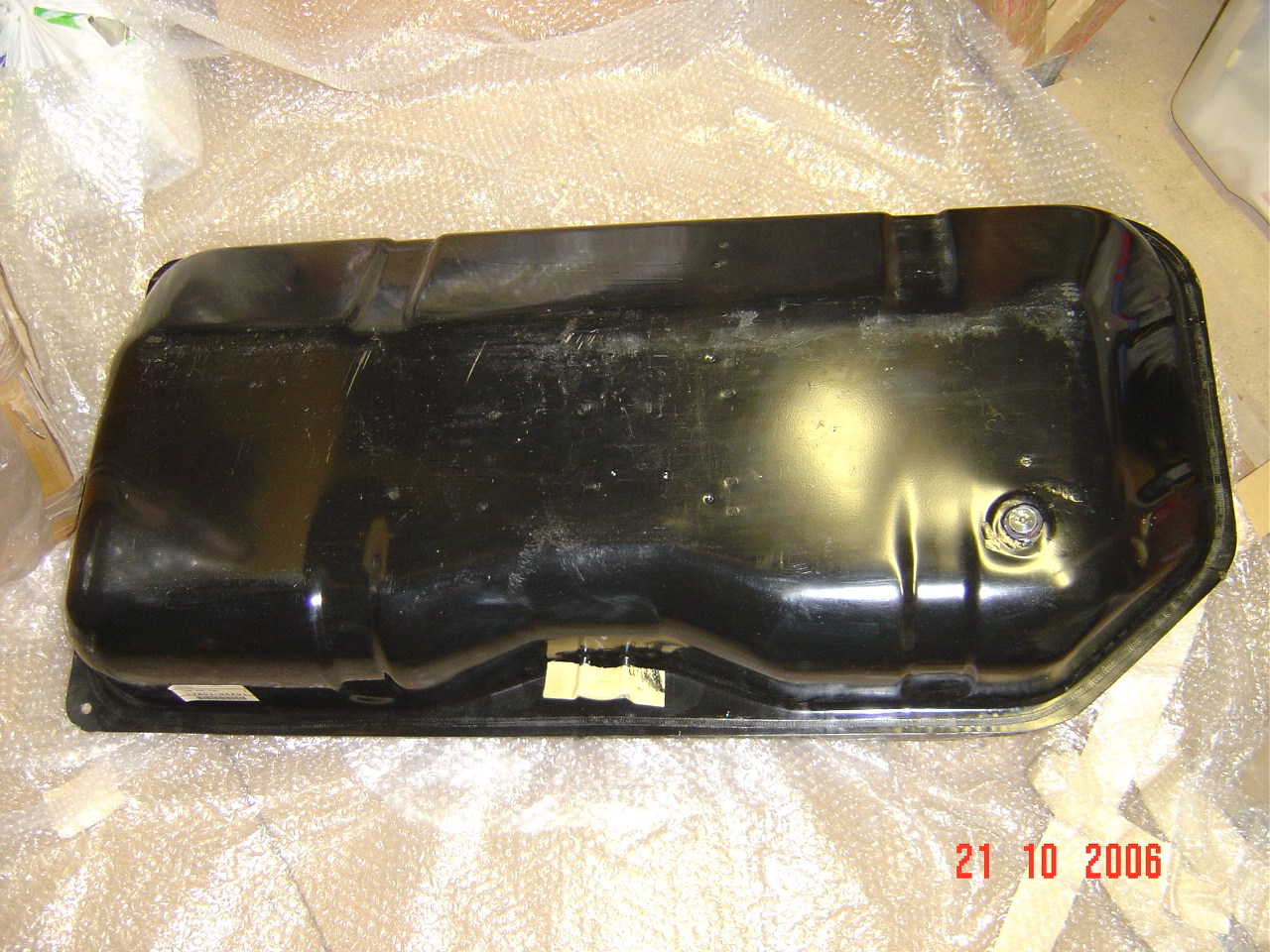

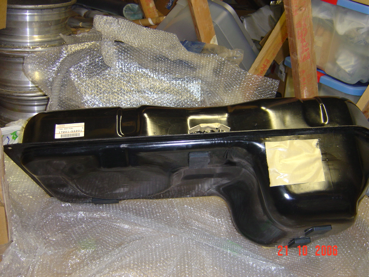

A very quick question for you wise folks - is the paint finish on the gas tank of my 1971 240 a gloss black or semi-gloss black ??
Thanks
Hank
I'd call it a gloss black - because when it was new, you could wash and wax the gas tank to bring out a high gloss.
FWIW,
Carl B.
Thanks so much for the quick reply Carl. As always, you are a wealth of knowledge.
Hank
Here are a couple of photographs of a NOS S30 tank for reference, albeit a later version, but the same finish as on a 1971 model.
Excellent. Thanks for the pics jerz.
