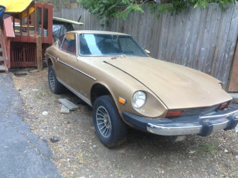

Here she is !!!!:D:d:d:d:d:d:d:d:d:d
She looks like a monster truck. :) Nice and solid looking.
Oooo front overrider... I lost the one for my 78 during one of my several moves.
only 71k miles......has the rear as well.....was in truckee california,
blown away by the lack of rust and overall condition.....
we do ALOT of bartering.....traded a 1993 kx125 for it !!!
(dad and i definately feel this is a keeper and worth some putting som time and $$ into)
paint code 304 gold metallic
Congratulations! My first Z was a gold '75. It's a pretty color!
