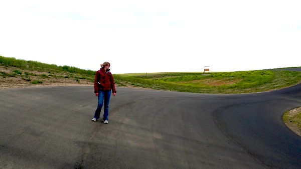

Here is a plug and picture of the turn at ORP. We were running anti-clockwise and I was transitioning the weight when it went. I think I was hearing the clunking around other turns as well but I'm still learning the car so I haven't quite figured which noises are good and bad yet.

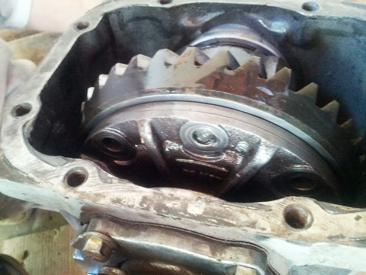

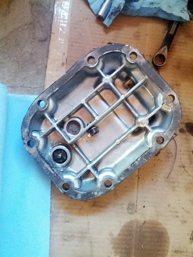

Heres the damage. My guess the safety wire went at some point and a bolt was able to wiggle it's way out.

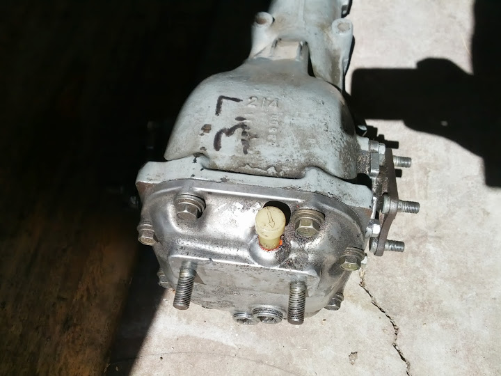

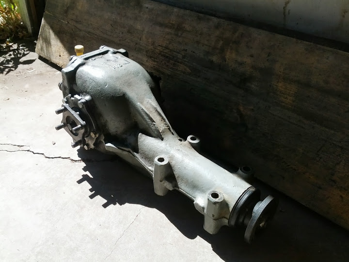

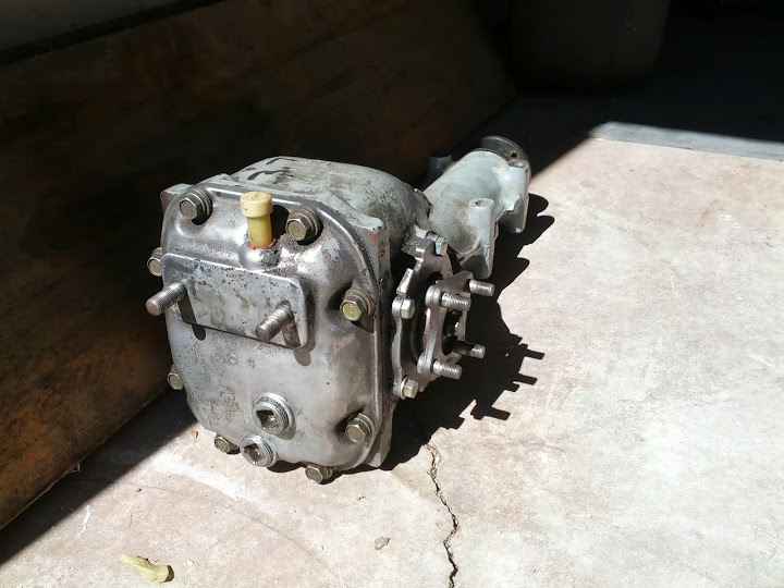

The new diff that went in. Question about the vent? at the top of the diff. Does that need some sort of cover is it fine to run it like so?

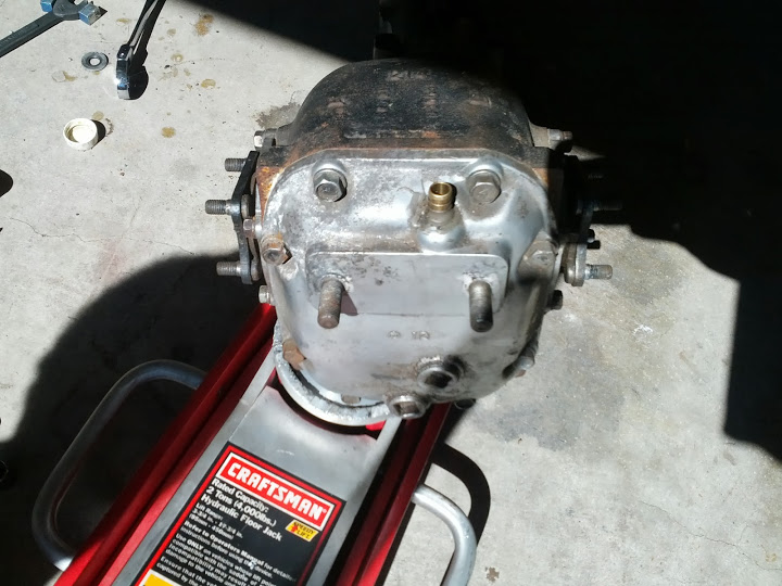

The old diff. Any thoughts on having the diff rebuilt vs buying another used one?

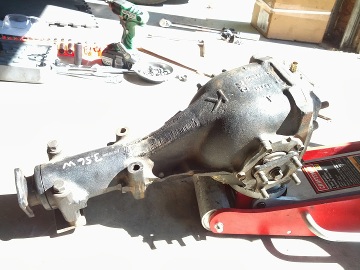

That's an R180 diff. Don't know what its from. That K on the case is a clue, I remember someone discussing that recently. Subie maybe? Is there an LSD unit in the case?
The vent on the new one looks like a brass pipe fitting that's been epoxied in. Likely had a hose of some sort attached that performed the vent function. It has to be open (to be a vent) but must prevent moisture and debris from entering.
What's facinating about your old diff is two things. There appears to at least 3 missing ring gear bolts (is the center one sheared off?), and is that the remains of one of the ring gear bolts stuck through on the casting web on the rear cover?!?!?!?! (picture 2)

The pictures are a bit misleading. We removed some of the ring bolts by hand that were loose along with broken saftey wire. The center bolt is sheared and the other half was found in the cover. The metal drain plug also had a good amount of metal shavings but I didn't notice much in the fluid as it drained.

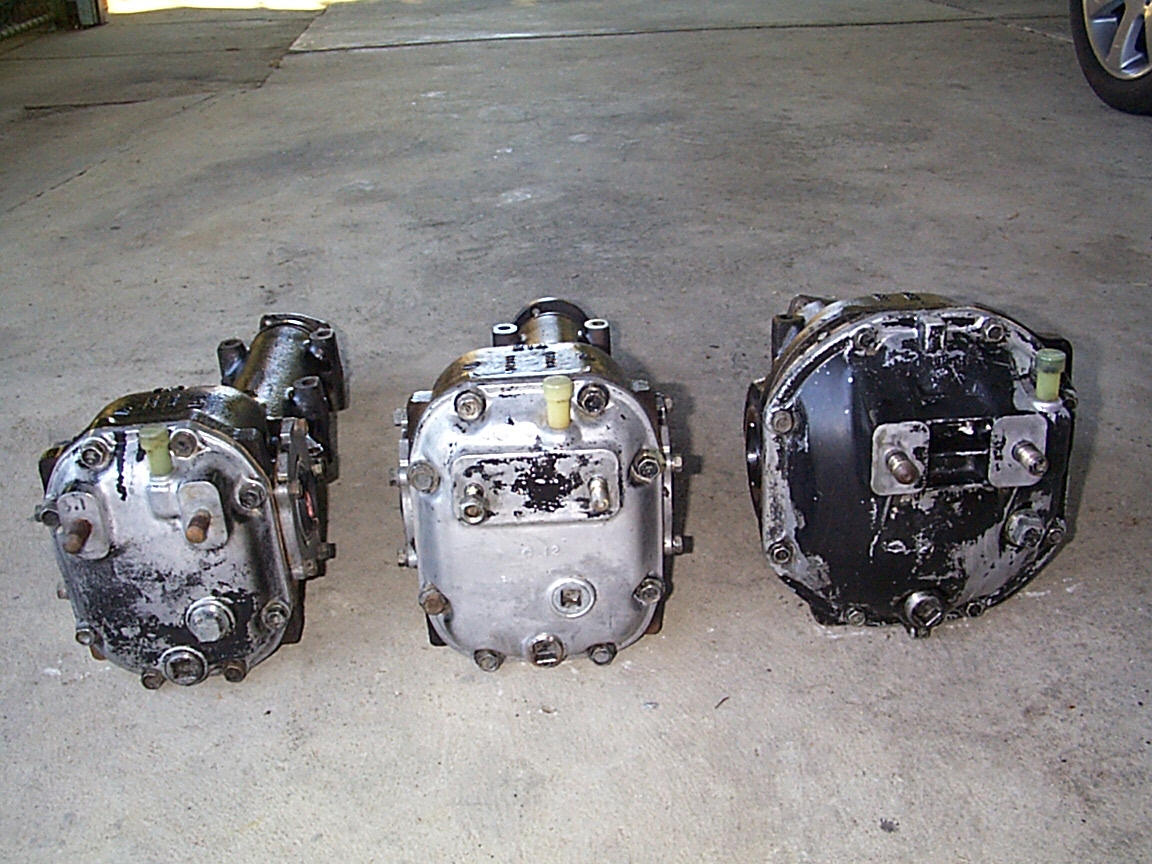

The shape of the cover is the give away for me, and then the overall size. The rear covers of the R160/180/190's are quite rectangular, while the R200's are much closer to round.
Makes you wonder how only one bolt shears off. Were any of the other bolts loose? Maybe they weren't torqued correctly, or that one was way too tight, or was damaged from a previous over torque. Might be worth an inspection of the other bolts before re-use or just get new ones.
R160 R180 R200

The one that broke could just be an open diff that broke its spider gear shaft (might be called a pinion shaft also), and the broken piece bounced around and tore up some wire and a bolt head. I had one shoot completely out of the diff, on a GM car. Left a scary looking hole in the diff cover.
A picture of the differential itself from the other side of the ring gear might show something. Take one each of the broken and the new/old.

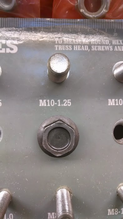

I took the diff apart and found some metal pieces. I'm currently looking for a set of these ring bolts and I'm not having much luck. Any suggestions?
I stopped by home depot to measure it and it's a m10 1.25. I did think of pulling one out of the welded diff but they're different. After thinking about it maybe it's not such a good idea to reuse ring bolts.
Why not buy a full set from Nissan? There are two part numbers available. P/N: 38102-22900 (€2.43ea) and 38102-P0100 ($2.80ea)
I dont know what the difference is and not knowing which car your diff originally came from doesnt make it easier. Maybe the parts guy at your local nissan dealer can help you sort out which one to use. Or just buy 8 of one P/N and fit them.
