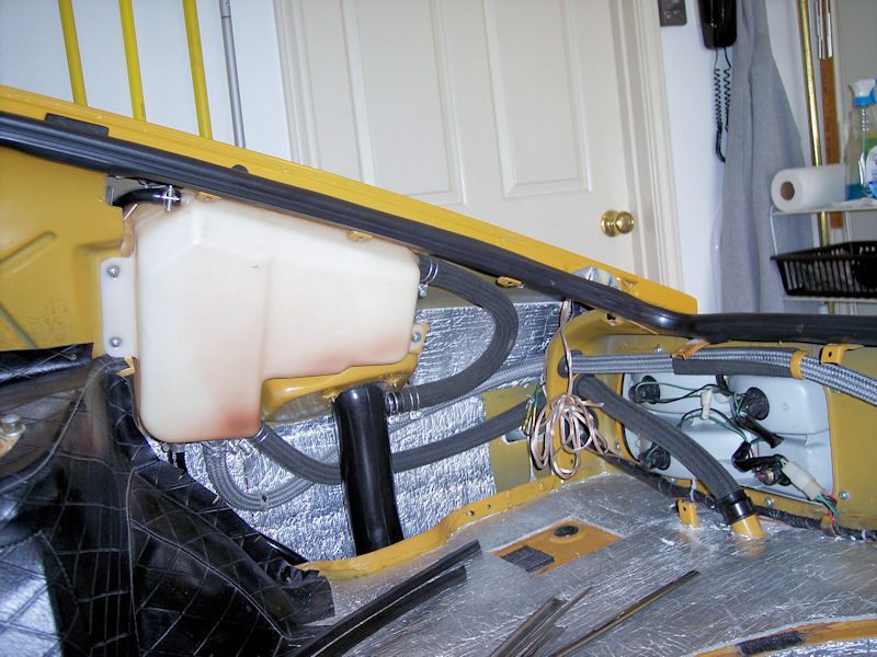

The right should have about a 5.5" speaker and there's none on the left. The right side has the gas vent tank the left has the power antenna. There's not a lot of room back there. There's a box you can buy that will replace the tail light panel and is cut out for 6x9 speakers. That might be a better way to go.

From what I remember it was tight with the speakers that I installed. I just had surgery or I'd go down and measure it on my 72 240Z. You might be ok with the depth but the diameter could interfere with the vapor tank and hoses. The holes in the plastic panel are for a smaller speaker and adding holes with the same spacing will be a little tricky. Wish I could be of more help.

Here is the right side of my '71, I'm not sure how it compares to your '76 (had to get it from your profile). You can see it is a pretty busy area, not much room for big speakers - or much of anything else for that matter. Hope this helps.
