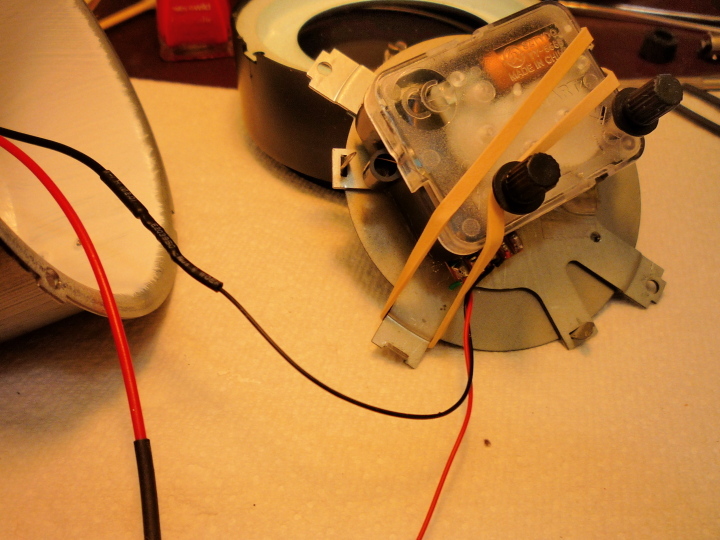

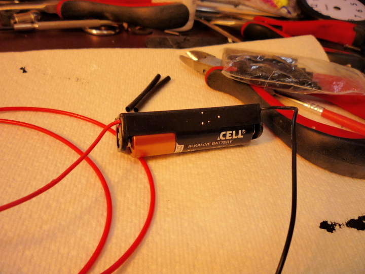

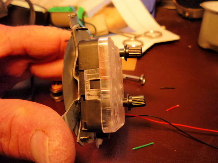

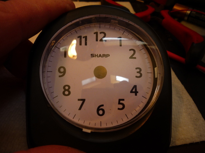

I read a lot of the threads on the Z clock repair and so I pulled out the clock and went to work. My clock was unfortunately toast, so I went back to looking at clock threads and decided to just replace the guts with a battery operated clock. I bought a Sharp clock from Wally World for $3.99 and a battery adapter from Radio Shack for $1.10. The swap was fairly easy even for someone as unskilled as me. I kept the hands from the Sharp including the second hand (I just liked the look of the second hand sweep). The Sharp clock had a short enough stem that it didn't need any trimming, I attached the clock to the Z clock backing plate with double sided tape and a couple of drops of super glue, the rubber band I have left in place as a backup to hold the guts of the clock in place. Here are some pics of the process with one (pic #6) of the empty Sharp clock. I believe the pics are self explanatory.

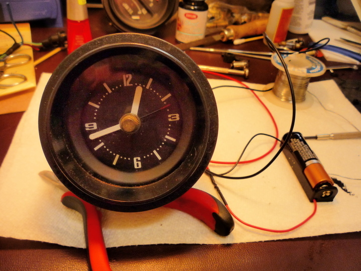

The final product(pic #4) doesn't look to bad and I was able to trim the second hand to accept the Z clock time adjuster(?). I will attach the battery holder to the inside of the glove box to make it easy to change the battery. I'm also putting LED bulbs in all the gauges and painted the inside of the cans.
Nice job! How difficult was it to trim the 2nd hand to accept the stock time adjuster?

Real simple, its made of plastic and I just cut the sides off to fit the time adjuster, it makes it a little harder to adjust time, because it only turns the second hand, so you have turn it a lot.

One of the things I forgot to mention is the Sharp clock has a bunch of wires for the alarm, snooze and switches, the only ones you need are the black and red that go to battery holder in the clock, I just cut the rest off.
