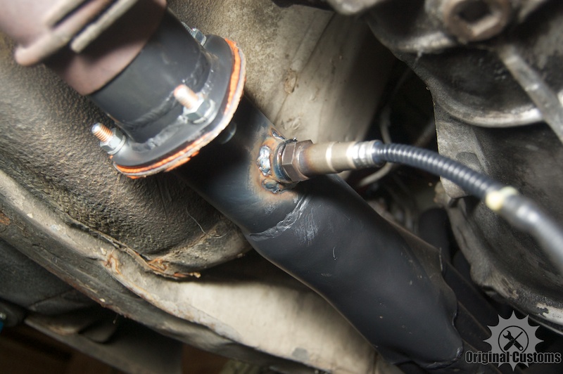

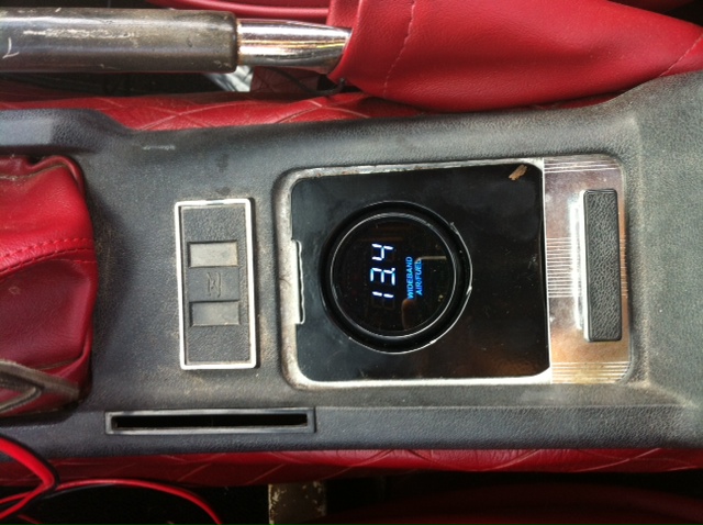

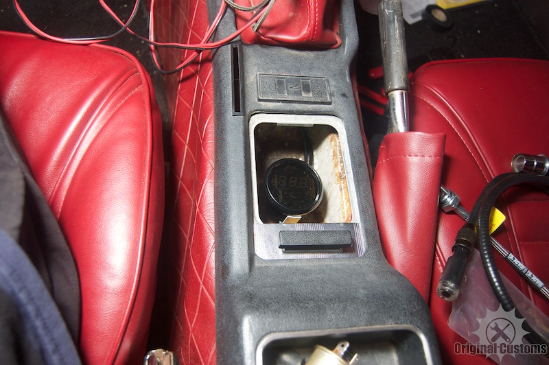

I'm not really impressed with the narrow band color change gauges. Things happen pretty fast in the A:F ratio world. I used a wideband gauge and installed it as you see below... It works like a charm and I have tuned it so that I am at a good performance A:F ratio of 13.5:1 for the most part.
Correct me if I'm wrong, but a narrow band O2 sensor is only able to tell a computer (or gauge, for that matter) whether an engine is operating above or below an (typically 14.7:1) air/fuel ratio, where as wideband gauges read the exact level. Definitely good information to have, but probably somewhat more expensive. Regardless, thats a very cool re-purposing.

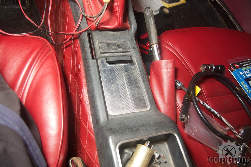

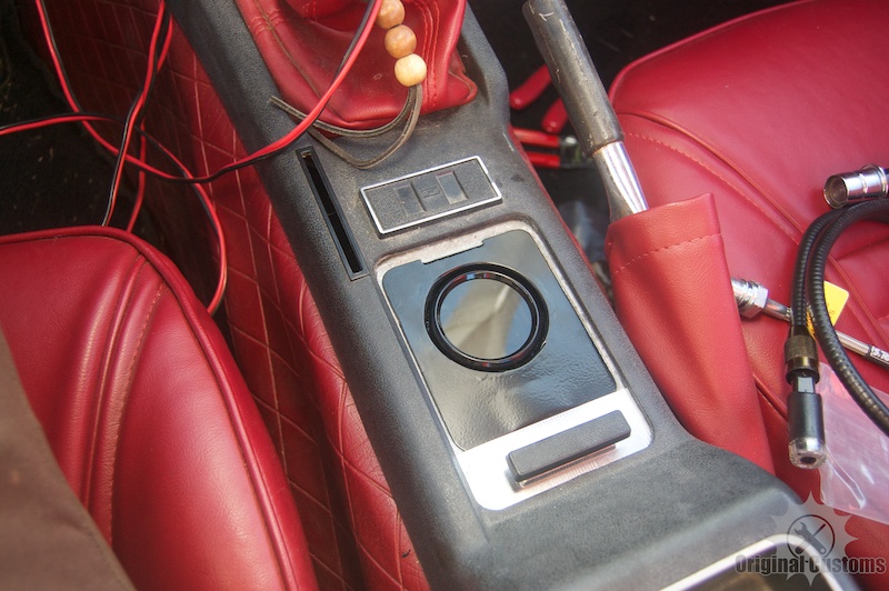

I have my AF Gauge mounted in the glove box along with my Retrosound Sound System. Removed the glovebox - used a black abs mounting board. the Retrosound has a remote control so I don't have to reach over to open the door unless I am monitoring the AF ratio. This is a color coded sweep dial with a digital middle- to the left is too rich / to the right is too lean / straight up is dead on. Total cost was approx $275.00

The narrow band systems are a pretty light show. When I say things happen fast, consider this. Our Z cars idle slightly rich. This is going to show an out of range color on any of the narrow band gauges. If things are tuned correctly, they should go rich when you tip in to accelerate. This is going to show an out of range color. You should be running on the rich side at WOT. This again, is going to show an out of range color on the gauge. Just not very useful to me. I have wideband in both the Z and my 914. I can tune for idle, cruise, and WOT with pretty good accuracy. Add to that that I am using Keith Franck developed jetting on my triple Webers and I am getting accuracy that was unheard of back in the 1970's. I just think those narrow band gauges with the color changes are amusing but not terribly useful. As for cost, I'm sorry. I don't really remember. I take my car down to Original Customs in Sonoma, CA and just give Mark the owner a list of things I want to accomplish. When I come back, he gives me a bill that I usually throw away to keep that information from my wife... 8O

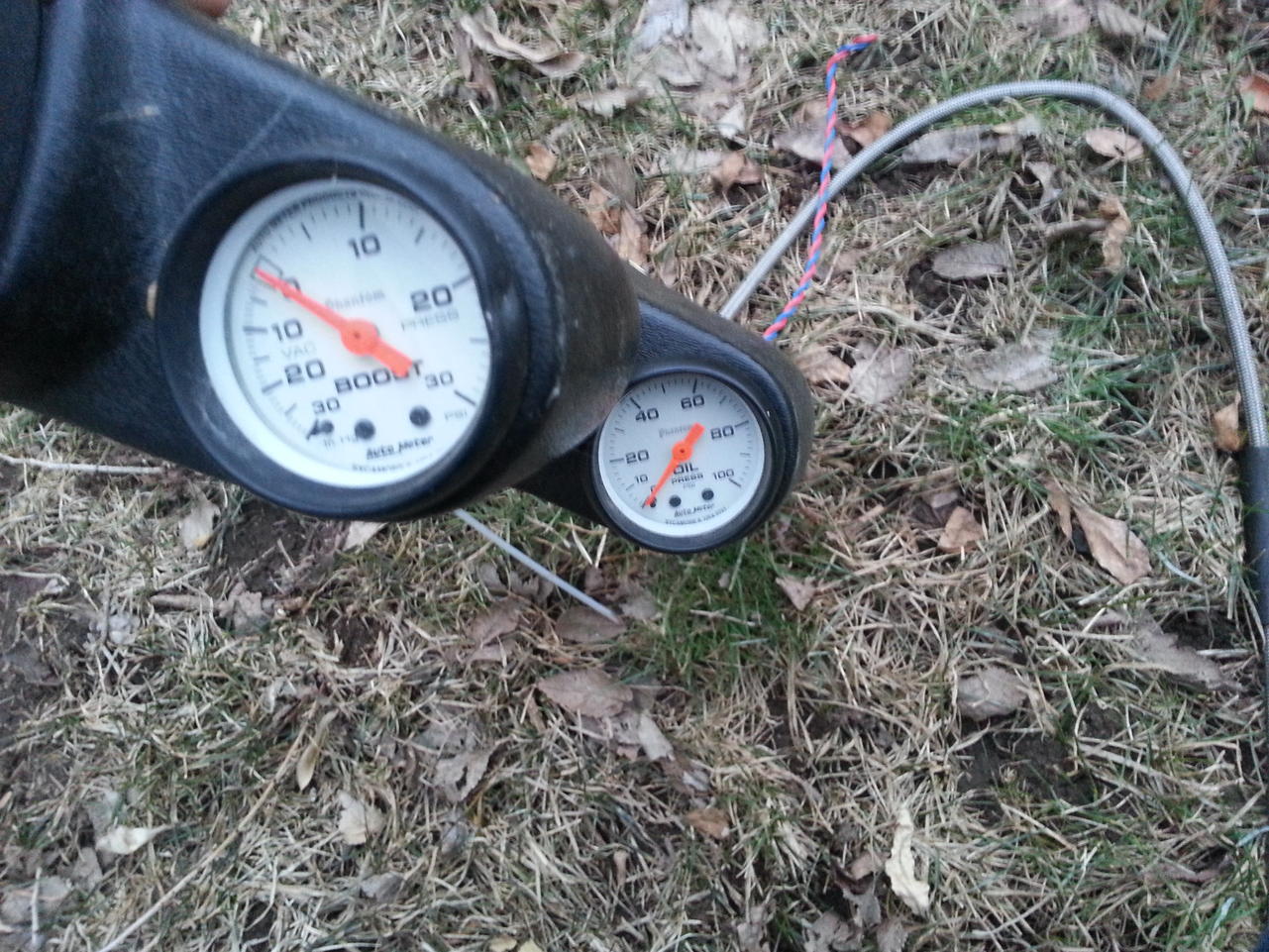

Oh, and I got some pictures of that gauge thing.
Anyone seen it before? Came with the car but wasn't hooked up. It looks to me like it is a modified stock door frame vinyl, with the gauges as an add on, but I don't know.
