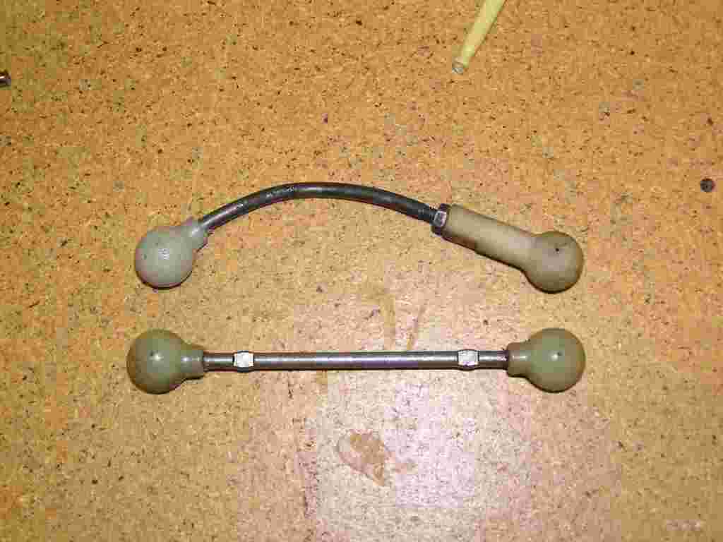

Right-oh...I've finally performed and tested Daniel's "hockey-stick" throttle modification and I can also confirm a significant improvement in throttle usability. It is now possible to sneak gently away from the lights and also to perform handbrake starts without wheelspin! (i'm going to miss those :devious:). Below are two pictures that show (1) an unmodified linkage alongside a modified (curved) one and (2) showing the new linkage in-situ...
I made my new linage by bending and cutting to length the long linkage from a 280zx. I retained the threaded (ie adjustable) end and pressed on a socket cap on the other end after I had the desired shape. My main aim was to introduce a nice curve and leave some future adjustability for in the new part.
The result is about an 85% improvement on the original setup...still not as good as a cable-operated system. I think I can further improve things by cleaning and lubricating all of the ball and socket joints in the whole assembly.

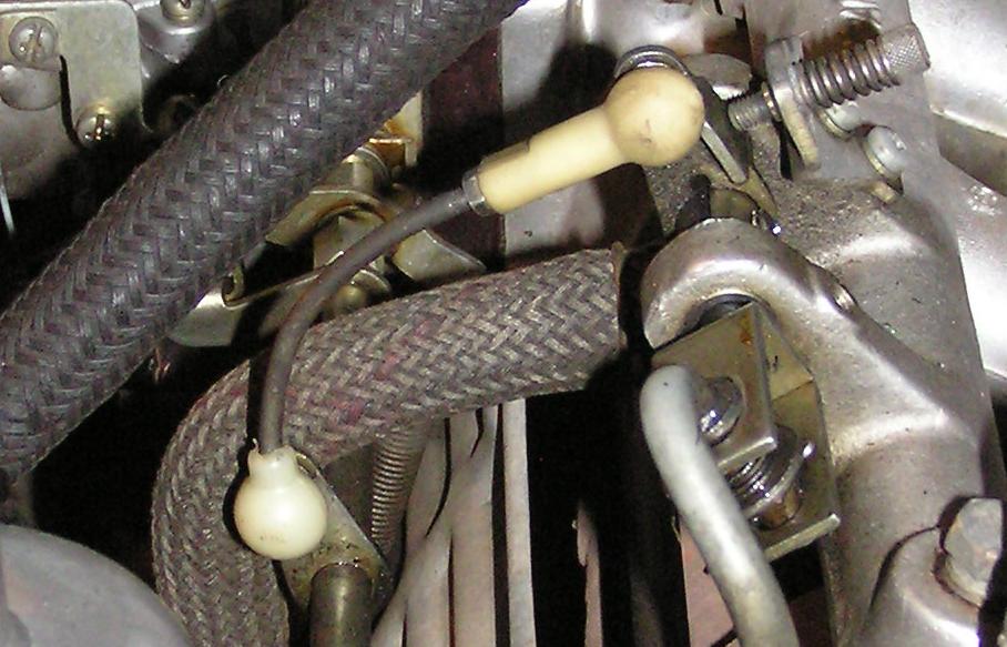

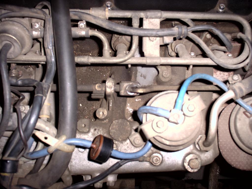

Are all these fixes described so far only for carbed Z cars? I have a 78 280. Mine is fuel injected and it is driving me insane trying to take off from a stop light without immediately hauling arse. It's just like everyone has described. When I try to give it gas from a stop light it's as if the pedal won't budge, like it's stuck or something. So I give it a tad more pressure and then BAM! I'm layin' freakin' rubber everywhere. After reading some other posts it seems maybe my problem isn't quite the same. I see where people have bent the linkage to take up slack but my problem isn't the initial slack it's that the linkage as a whole feels like it's stuck when it's in the off position. Turning it by hand produces the same results. It's hard to move at first but then it finally does. I've circled points in the pictures that are maybe a problem. In the first picture with a circle, is it normal for that area to have slack in it as well? The place where the two rods connect which is held together with a cotter pin has some slack in it. Don't know if that's normal or not. In the second picture with a circle, that area as well as the others like it maybe need grease? I'm guessing it needs to be disassembled and cleaned and regreased. How do I get the ball joints off? What grease should I use to lube it with? I have some general purpose bearing grease. Anyway here's some pictures.
Also, is it normal on these cars to have the e-brake pull up so far? This is my first manual transmission car so I've never even bothered to use an e-brake before. I know my Pulsar's e-brake only goes up about 3 clicks.
I don't know why or how but in that third picture, the torsion rod is installed backwards. The one that connects the back part of the linkage to the front should go in through the top of the opening. Seems to me that that would cause it to bind. I'm taking a picture of mine as we speak to show what I mean.
