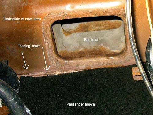

[ATTACH=CONFIG]61572[/ATTACH]
Here's what I found yesterday after removing the black rubber compound that apparently filled this area with at the factory. There is another smaller hole at the other end of this crevice. Looks like removal of the air intake duct in this photo will be part of the solution. This hole is actually a bit larger than it appears here. Once I started scraping around there was more rotted area.
I think mine is leaking also on that spot, I can't see it really good right now because that plate is above the air intake for preventing the rain from going in. I also have the factory seal still on it, but like you it might be leaking under there...

@ hr369, yes that seam ! When I look with a flash light on the inside driver side firewall, I can see that seam is wett on the inside. ( maybe because the water couldn't drain properly to the sides and was along the seam all the time ? )
I'm currently getting everything dry and then will see what to do, maybe I just need to reseal everything again.
