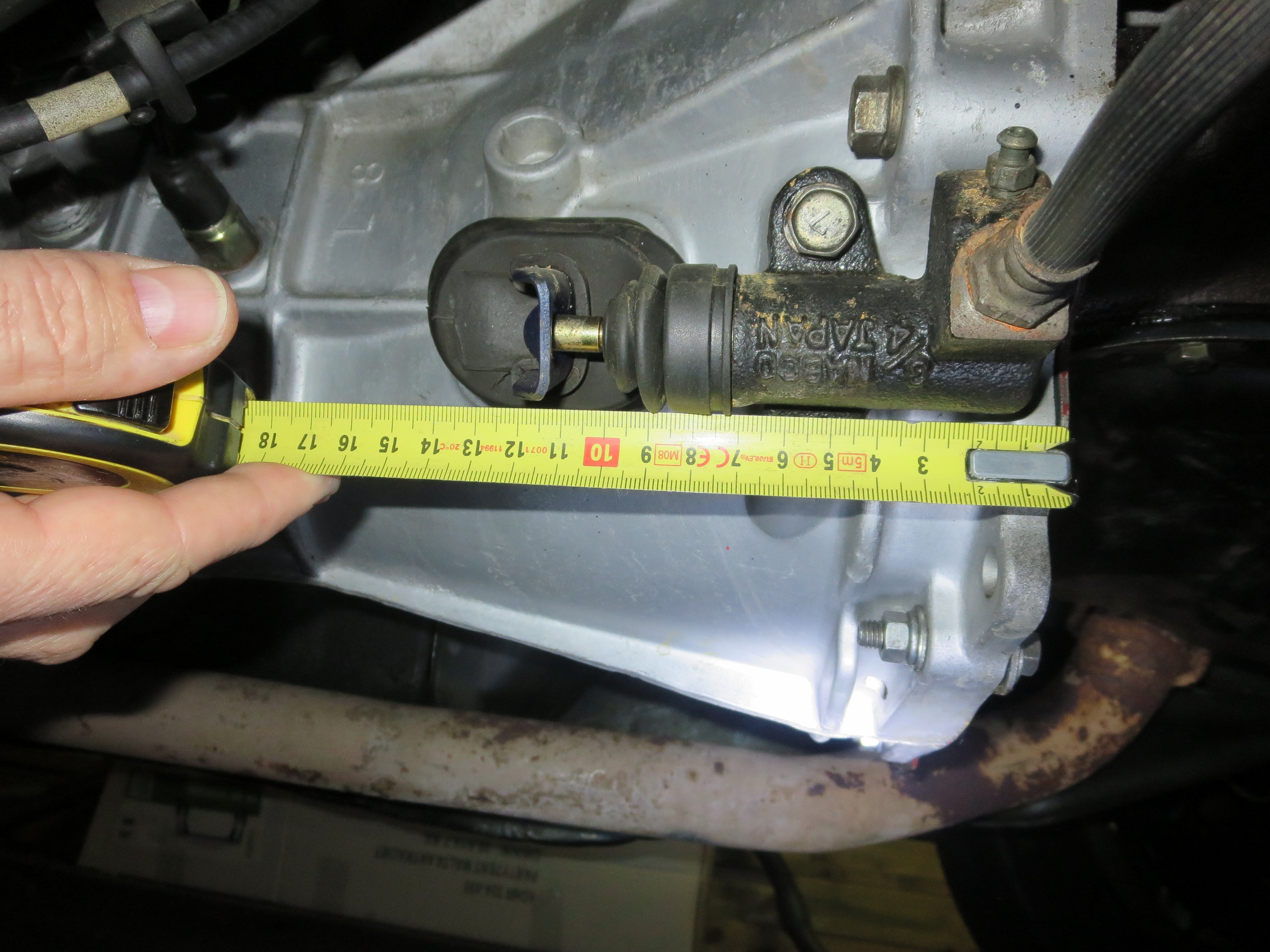

You can tell if you have the correct (or one that should work) by measuring the distance between the fork and the bell housing. It should be around 110 - 115mm. See photo.
If you are getting less than 120mm, you are in trouble. The collar doesn't match the pressure plate. It is the pressure plate and collar the have to match and add up to the holy number of 92mm. Clutch disc, clutch fork, slave cylinder etc are for all intentions the same. With a new clutch disc and the correct collar you should be down around the 110mm or even a little lower.
The collar you should have for the 280Z orriginal pressure plate is 29mm. If you have a pressure plate for the 2+2 it will need the 25mm.
You should be able to push the slave cylinder push rod back into the slave cylinder about 10 - 15mm. Just push firmly on the back of the clutch fork with the palm of your hand. This will tell you a couple of things: 1. The master cylinder port is open to its reservoir, and 2. The push rod is the correct length and allows for clutch disc wear.

I not sure which collar you now have, but it sounds like you have the longer one. If you open the transmission link in post#8 and scroll down to the clutch forks. You probably have the left one in the right photo. Its 28mm from were the fork fingers sit to the back of the bearing. The right one is 24mm. You could ask the company that supplied the clutch for info on which collar to use.
I think, but not certain of it, that they changed from 280z to 280zx, but that could be onlt the turbo model. It the clutch is for the 280ZX then that could be where your problem is.
