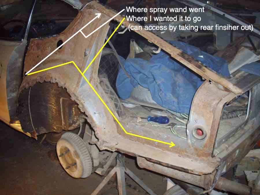

There may be others, this one I remember because I posted to it. The Transtar wand I used in that post is stiff and when I removed the finisher behind the driver's seat and sprayed back towards the rear wheel as described in that thread I found out later that the wand went up towards the roof but likely still did some good for the wheel well. With further removal of inside finishers I will be able to do further spraying with Transtar amber to get areas I missed before. See picture, I apologize to whoever has this car I can't give credit as I don't have a name saved with it. I had hoped the wand was going to go over the wheel well arch as pictured here but to do that additional finishers need to be removed I believe. I will get to that area over the wheel well later with more spray. Hope this is useful.

You are welcome EuroDat. I'd love to make an animation of spraying the inside of the frame, front and back. Still have more to learn though about accessing the back frame rails.
