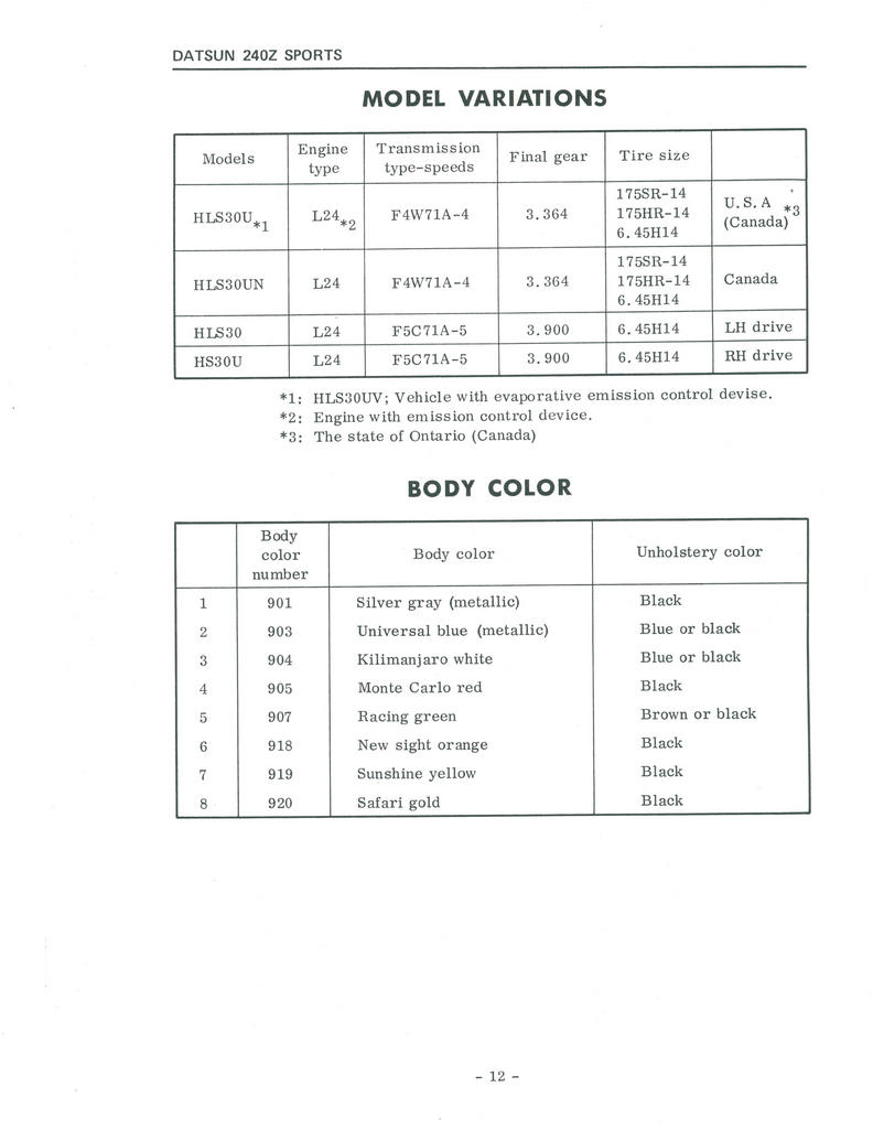

The Haynes manual is correct*. You guys are just not understanding the differences between an HLS30U and an HLS301 ( or an HS30U ).
*Shocking, but true in this case.....
Alan, would care to elaborate? There is no "U" in the US VINs, and I do not currently have access to my Haynes manual to read the VIN explanation in context.
I don't want to sound rude, but this is pretty basic stuff we're talking about here....
The north American market 'Datsun 240Z' didn't have a 'U' in its VIN prefix, but it had the 'U' suffix in its factory model variant code. In Japan they called it the 'Katashiki'. For the 'U' suffixed models, there were extra sub-variants depending upon the sales destination. The ful codes were not affixed to the car, and are not to be confused with the full VIN number / body serial number / 'Shatai Bango'.
The RHD export 'HS30U' models also didn't have that 'U' in their VIN / body numbers, but it was there in the 'Katashiki' and that's why Haynes - following the example of the factory workshop manuals - put it in their manuals.
The 'HLS301' was the LHD export market 'Datsun 240Z' which was manufactured specifically for the mainland European market. It had the FS5C71-A 5-speed transmission as standard equipment ( as did the 'HS30U' ). It was only the north American market cars that didn't get a 5-speed trans as standard equipment.
Having said all that, GeoJoe's car - if it's a north American market model - would almost certainly not have been equipped with a 5-speed trans when it left the factory.

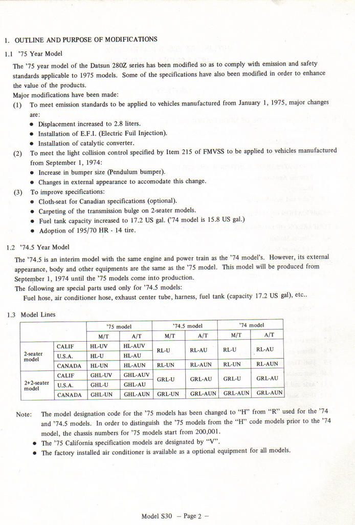

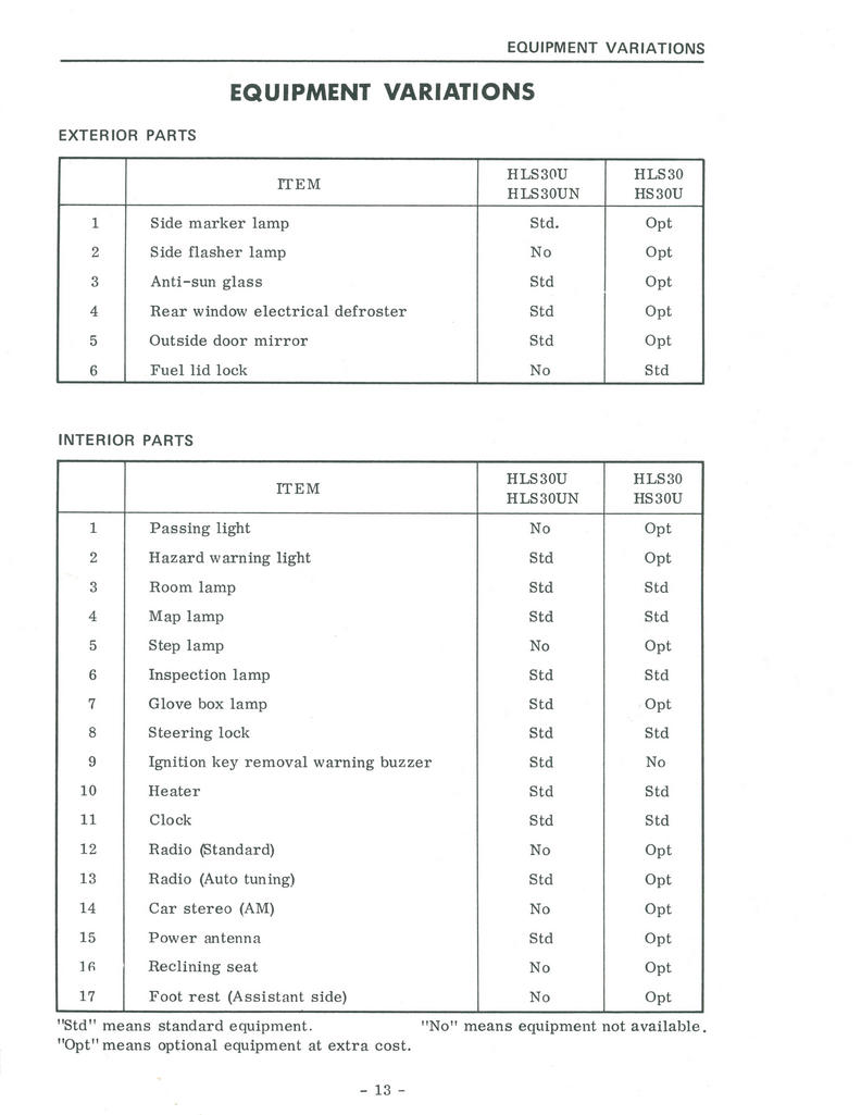

I don't believe the average consumer or Z enthusiast in the US ever had much of a need or desire to know what the individual market designations were/are. It is very important in the manufacturing process to ensure the correct parts are being installed. Each model designation is defined by design as well as mandated vehicle conformance to individual markets. The guy behind the parts counter would certainly be aware of the different "sub models", but the customer, not so much.
This information is interesting and if you look at this page taken from Nissan's "Outline Specifications", you can see how helpful this info would be for someone who is trying to make sense of their transition year Z. I believe it would take a lifetime and then some to learn all the secrets and intricacies of the S30.:ermm:

To be fair, historically the situation was probably pretty much the same outside the US too. However, we've spent lot of time on this forum over the years discussing this very topic and these very terms. It would be nice to think that some of that would have rubbed off, and that people would not be quite so incredulous to hear that an HLS30-prefixed 'Datsun 240Z' might have come from the factory with an FS5C71-A trans and 3.9:1 diff as standard equipment somewhere in the world ( "impossibly rare"....? ). After all, as yourself and 26th-Z have shown, it's all in the factory manuals and service bulletins.....

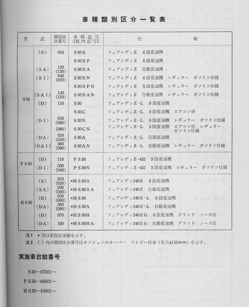

On the subject of suffixes, spare a thought for the Japanese market. In October 1971, there were more prefixes and suffixes attached to the 'S30' series code than you could shake a stick at:
