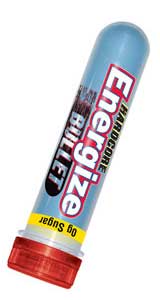

If a new lens is needed apparently one can be made by sawing off the bottom rounded end of an empty energy drink tube someone gave me. Unfortunately I don't know the kind of drink it was but I will get that this week from the guy who gave me the empties. The old lens per my measurement is 32.53 MM in DIA and the energy drink tube is 33.78 MM in DIA if I am reading the caliper right. The new lens material can be ground with a bench grinder where the retaining tabs are on the metal body for a tight fit so it won't fall off though there are variations on this idea. One of you may have a better idea on how to captivate the lens that is more like how the original mounted than what I came up with. I plan on sharing anything further on this VIA my blog when I get done with it in case anyone else wants to try this. The old lens shown here and the two engine bay light assemblies came from JY 280ZX's; my car is missing this item. The pictures vary in brightness but were adjusted for maximum readability of the caliper.

Mike, I think I found the brand.

Thanks! The shape looks right, I still can't remember the brand for sure as I threw away the packaging a couple of months back. I have a nice looking new lens for my engine bay light now, I spent the afternoon finishing the one I started. Had to use a dremel to grind it down and to cut the slots in it. Will have to clean and paint the metal part the ones I have are very dirty. I love making this kind of thing. Heh heh. I have another one I will mail for postage if someone wants to try making a lens. May have more lens making energy drink containers somewhere, thought I had 4 of them.

The guy who gave me the empty tubes of drink said he doesn't remember what drink it was but he thinks it was a nutritional drink.
