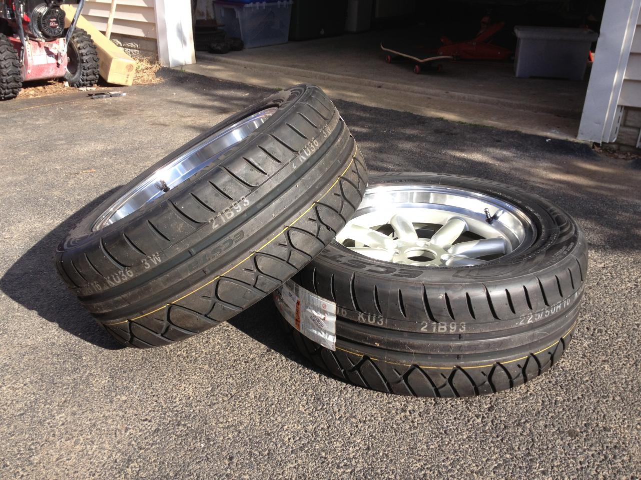

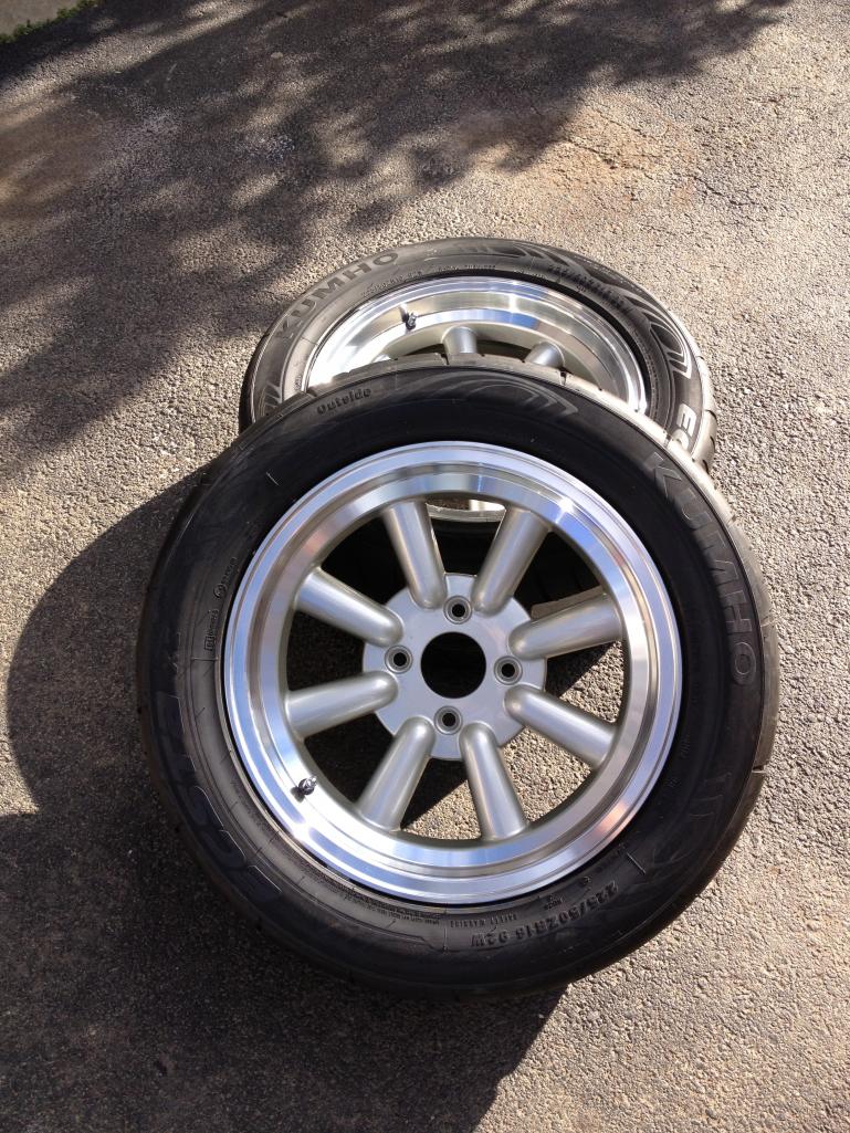

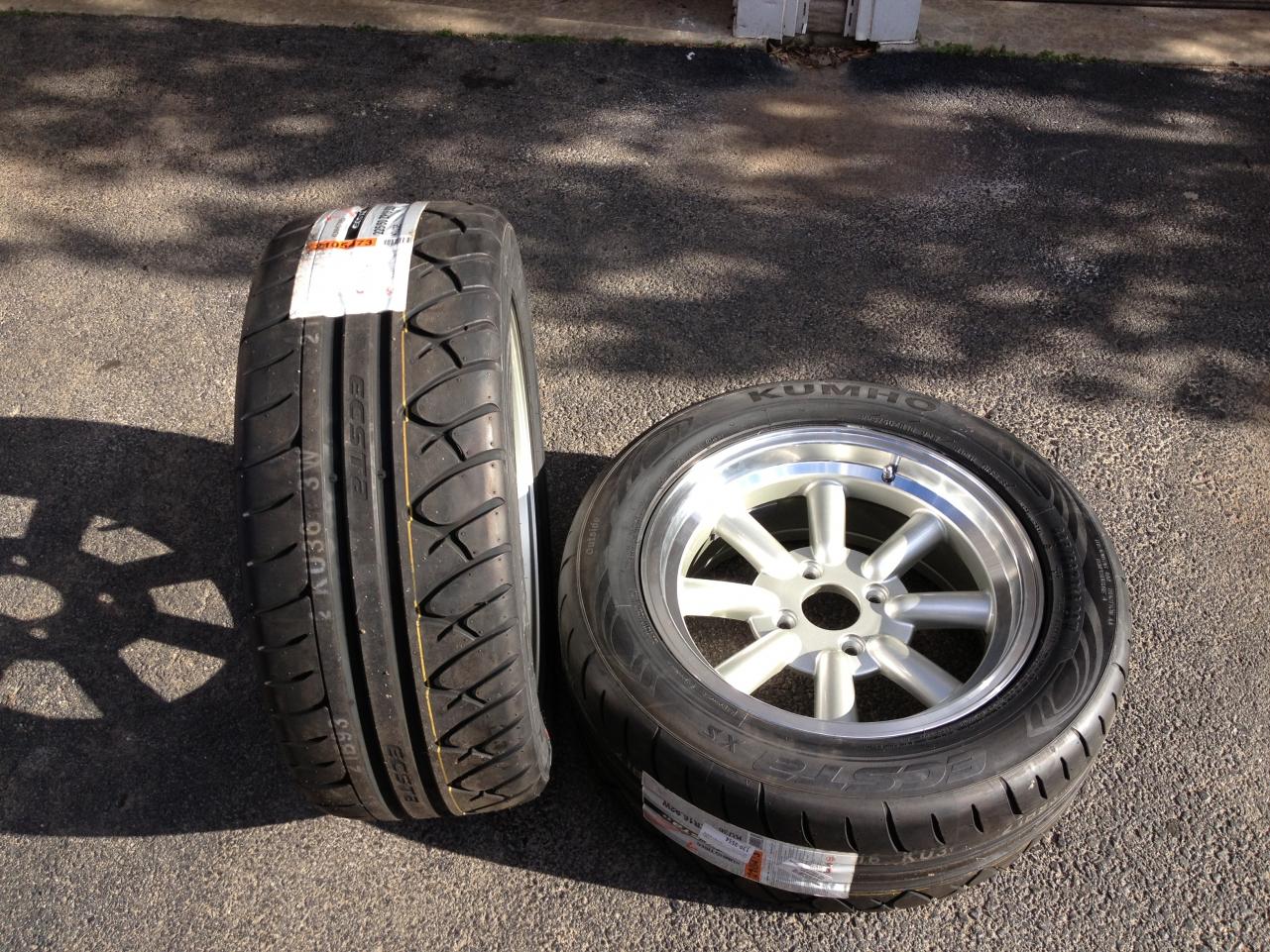

The tire shop called me last week and said my tires were in; Kumho Ecsta's 225/50R16. So Friday I dropped the wheels off and got them mounted. I'm pretty excited, but unfortunately my car has no front suspension and is on jackstands so I can't give you any pictures of them on the car. Here are a few teasers, though...

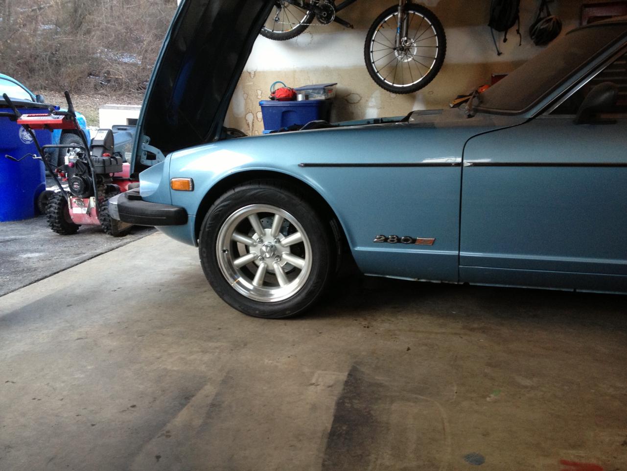

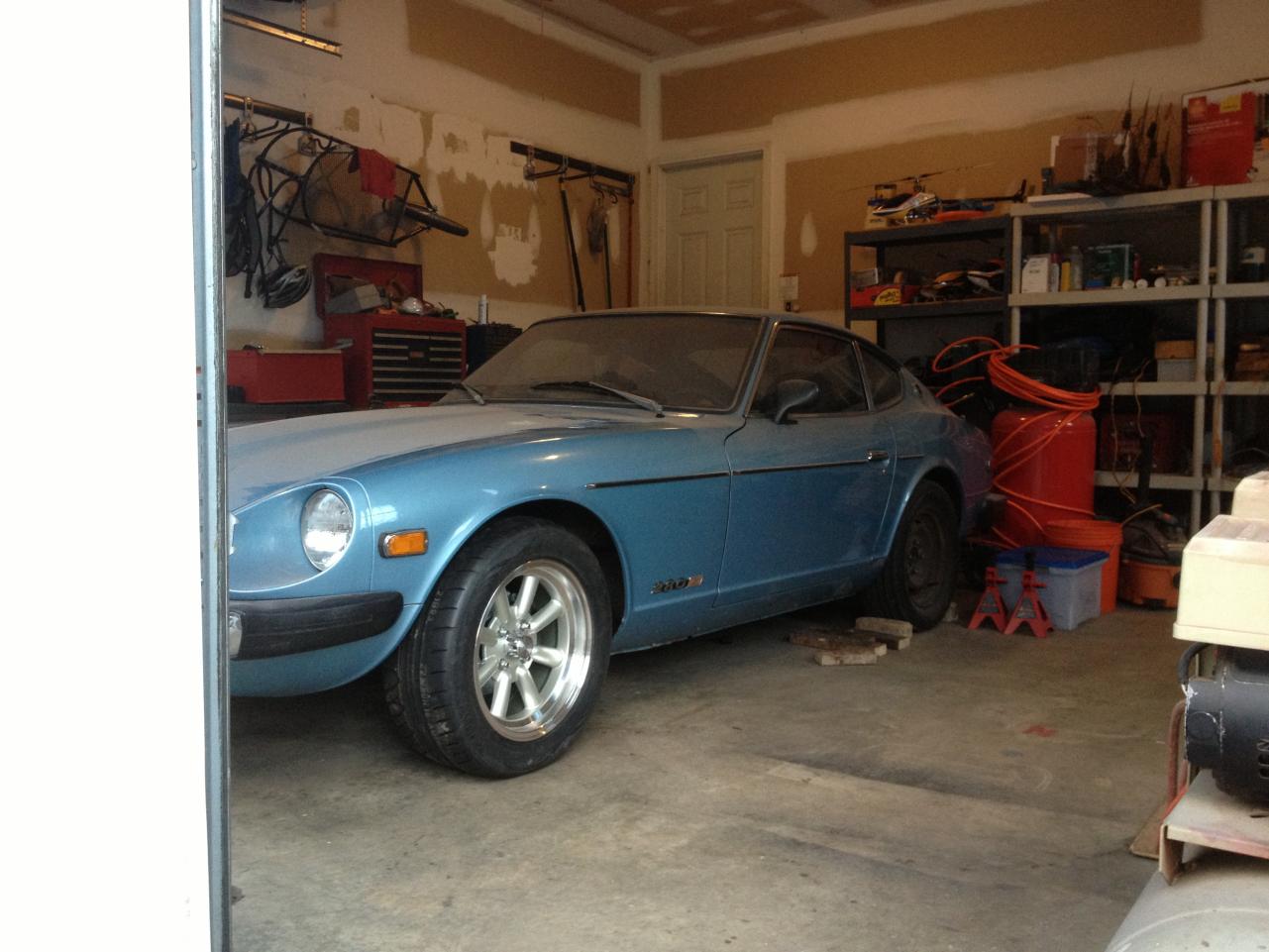

I havent' been able to get the car out of the garage because I hadn't hooked the steering up yet. I hooked it up today, though.

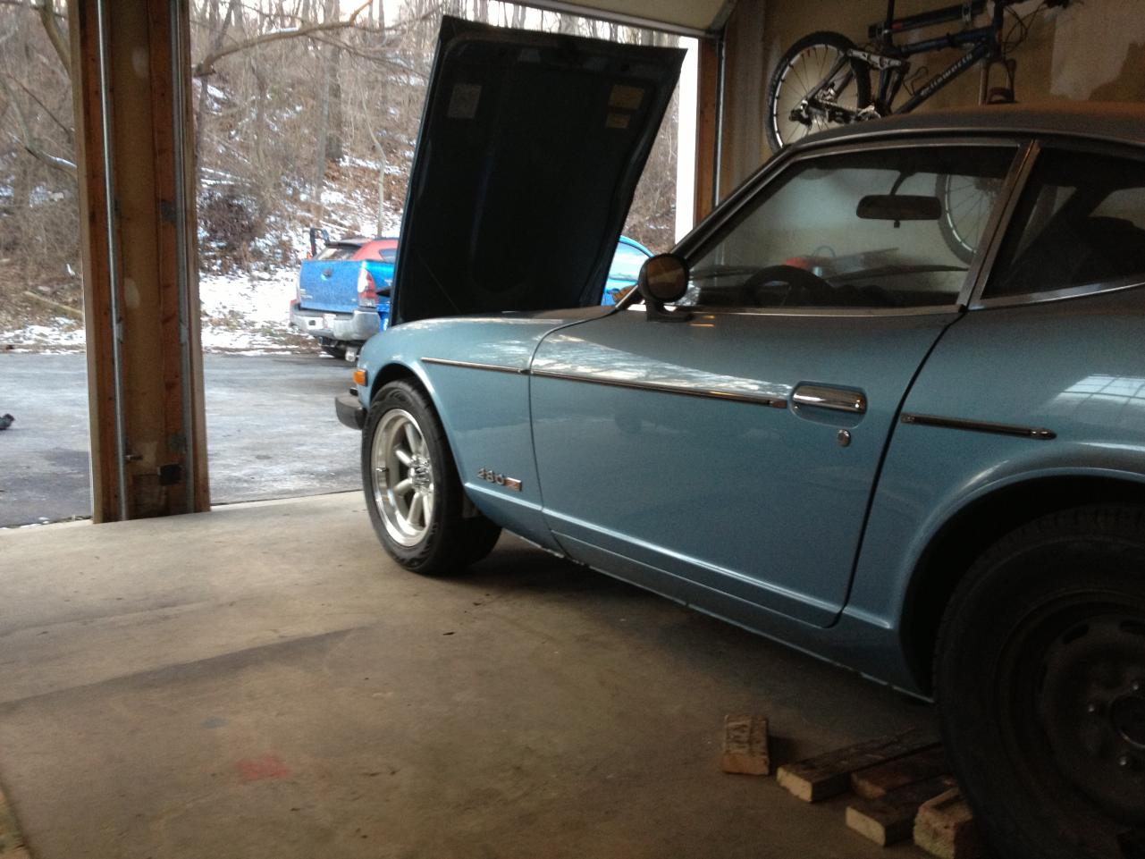

Here is a teaser with the front wheels installed.
I have the back on now, too and will take pictures tomorrow if the weather permits. It has been snowing off and on and cold as heck (for Maryland). I will say, though, that the back absolutely will rub. I will first try rolling the fender (at a later date), but I'm not even sure if that will be enough. it's tight!
