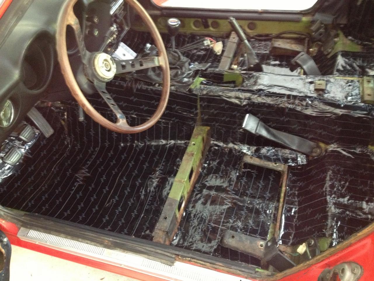

April 2, 201312 yr comment_419430 Okay, so I thought I would have the Murder Mat in a week ago but just finished it today and couldn't be happier. It adhered to my version of Lizard Skin very well and once it is rolled down is very difficult to remove. Although the surface facing inside the car is slick after it is cleaned with an alcohol wipe, it takes spray on 3M adhesive very well. I'm a long way from getting the sound system going but the echoee sound inside the cab is gone. I'm sure most of the stick on sound deadeners would do the same thing.I bought 40sq. ft. and was able to cover everything I thought needed it.Chris Link to comment https://www.classiczcars.com/forums/topic/45302-sound-deadening-and-heat-shielding-materials/?&page=3#findComment-419430 Share on other sites More sharing options...

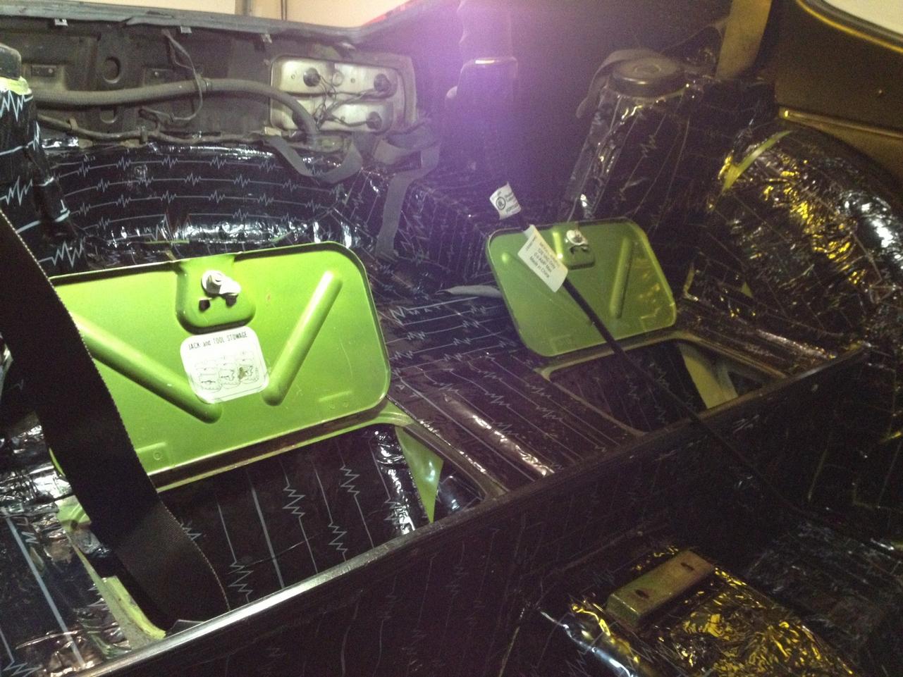

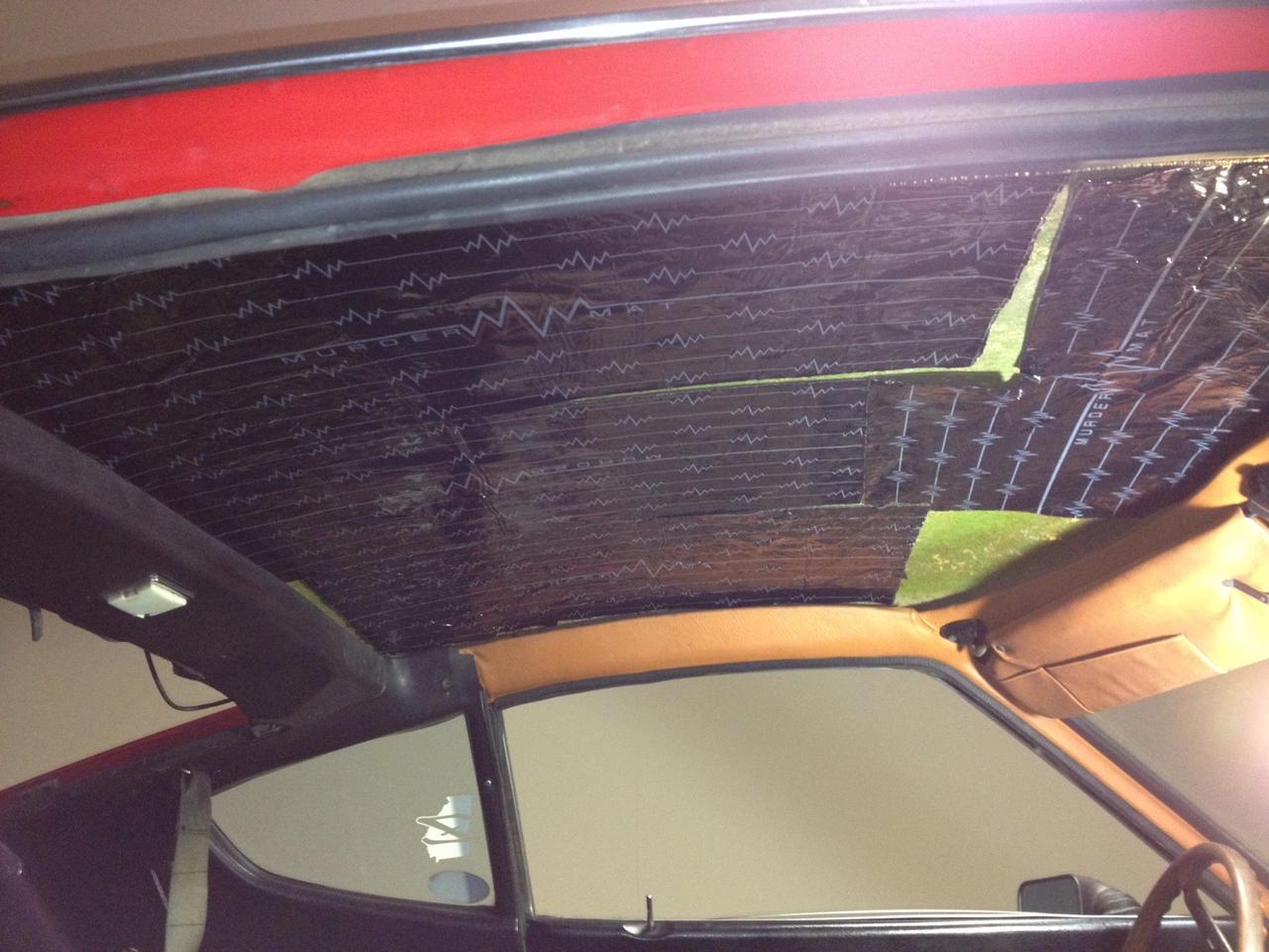

April 3, 201312 yr comment_419466 Bring the pics! Here are a few photos of the hush mat in my 260Z.. Try not to laugh.. I know it looks like a first grader did most of the application, I was trying to get maximum coverage while minimizing waste.. The roof was completely covered as well as the insides of the doors. This is great stuff, I highly recommend it. Link to comment https://www.classiczcars.com/forums/topic/45302-sound-deadening-and-heat-shielding-materials/?&page=3#findComment-419466 Share on other sites More sharing options...
April 13, 201312 yr comment_420481 This looks great ^^^^^. Nice puzzle work. Link to comment https://www.classiczcars.com/forums/topic/45302-sound-deadening-and-heat-shielding-materials/?&page=3#findComment-420481 Share on other sites More sharing options...

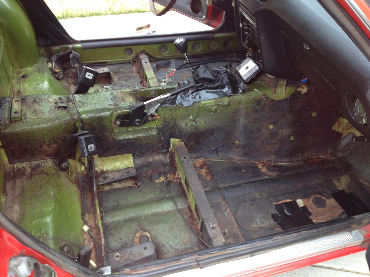

April 18, 201312 yr comment_420936 I've ordered 80 sq ft (2 40' packs) of the BL version of Murdermat for about $225 with free shipping. The sales rep said that it would probably take 60 sq ft to do the whole car. I'm talking floorboards, tranny tunnel, firewall, doors, roof and trunk area. He also said that there isn't a reason to buy their thicker stuff, as I'll probably have some left over and can easily double up on concerned areas. My problem was getting all that nasty, hairy jute off the bare metal. Check out the green monster! Link to comment https://www.classiczcars.com/forums/topic/45302-sound-deadening-and-heat-shielding-materials/?&page=3#findComment-420936 Share on other sites More sharing options...
