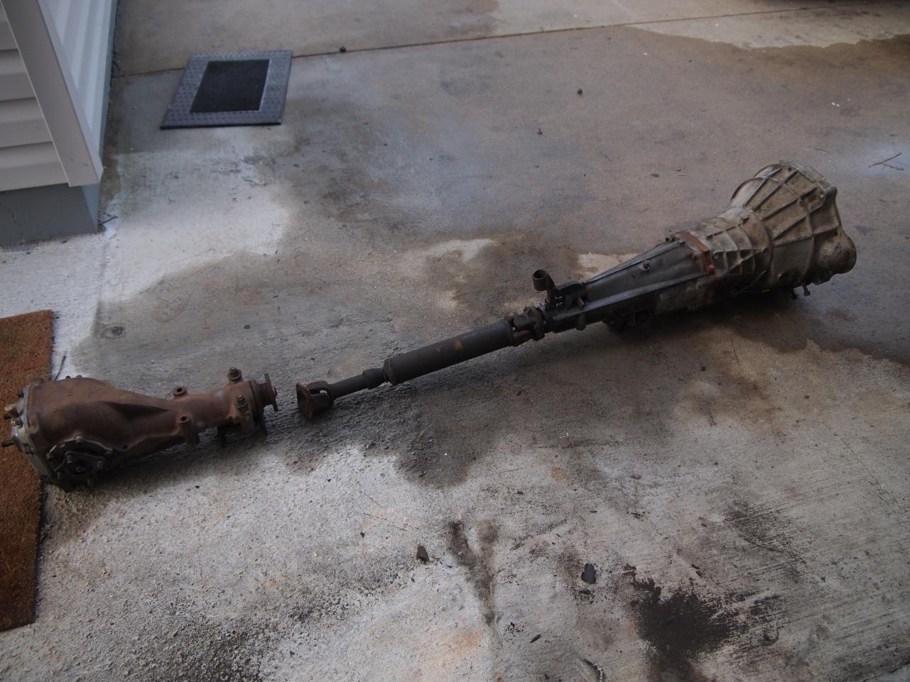

Car is a 3/'70 240z. I'm fairly certain I have an R180 diff, but it's alleged to have 4.11 gears. I have a 280zx transmission on-hand that I plan on dropping in. Which drive-shaft do I need? The transmission & drive-shaft that are currently installed are going to go in my '70, so I can't start there. I need to find a drive-shaft - is there a particular year/length I should be looking for?

The 70 Z's had the angular half shafts with the short driveshaft. Use what comes out of the car......Or, go ahead and do the conversion which is a late diff mount, a long driveshaft and reversing the mustache bar. I'm only two hours away.....I like IPA's from the keg. All of this assumes the PO didn't already do the swap.

Like Diseazd said; you got the short shaf already. In the series I 240Z the diff sat 35mm forward. You can move the diff back to the series II position and use the driveshaft. I think there are issues with the tunnel not clearing the gearbox on the early models. The rear gearbox mount needs to be modified because the 5sp is 50mm longer.

I believe the 3/71 is an early model (short driveshaft).......If the previous owner didn't do the update, you simply use the same length driveshaft that came out of the car. Measure it.....if it's the short driveshaft, he didn't upgrade the drive train....if it's the longer driveshaft, he did. The dimension of the late and early trannies are identical except the location of the shift lever......that will require mods to your console or shifter if you indeed have the early Z. Do you have an early ashtray etc.? Someone else could chime in regarding production dates for the early cars.

Hopefully it's the updated series (longer driveshaft), but with the early ashtray, I doubt it. My 71 is the same thing...early ashtray but everything else including pillar emblems are late Z items. My driveshaft was the short one. I'll check the build date, but I believe it's 5/71. Just checked.....it's 5/71 which means you probably have the short driveshaft unless updated. To upgrade to longer driveshaft, you need a late diff mount, a long driveshaft, a 72 diff hanger and you'll flip the mustache bar. If you don't want to do that, you'll need the short driveshaft and as Eurodat stated, you're going to need to either modify your console or shifter as Zedyone just finished doing to keep the shifter from hitting your early console.The tranny mount in your 3/71 will fit the ZX tranny and bolt right up.

I can't really tell which car has what parts in it and where they're going, with a 70 and 71 240Z and a roadster, but I think that you can easily identify the forward shifted differential in the 240Z with the short drive shaft by looking at the angle of the half-shafts to the wheels, from the side of the car. The later 240s, 260s and 280 half-shafts will be perpendicular to the wheel and side of the car, the early 70 cars have an obvious forward angle. I seen it with my own eyes, in the wrecking yard. Might have to remove a wheel but it seemed obvious when I was looking at them.
Or you can measure from u-joint cap center to u-joint cap center (easiest measurement if it's installed). The short one's are ~21 1/8", the longer ones are ~22.1/4".
