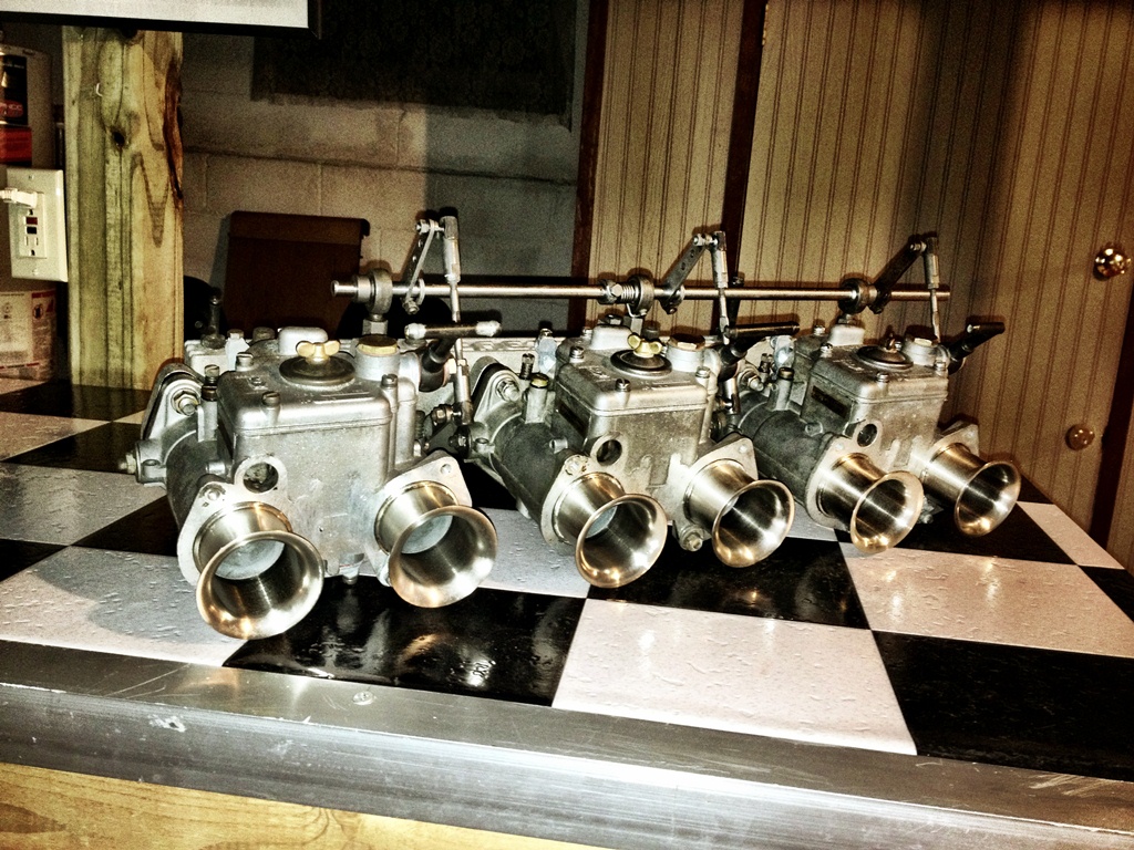

I picked up some 40 DCOE tripples of a parts car I bought, cleaned them lemony fresh and rebuilt them using rebuild kits from pierce manifolds

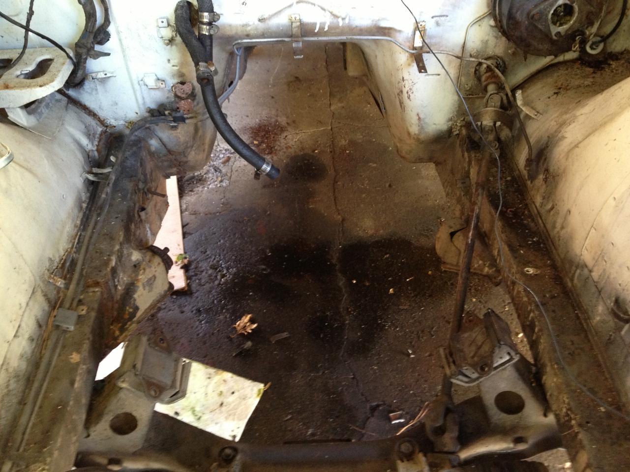

But I have managed to cut out the passenger front frame rail. Of course this uncovered more rust that has to be repaired... but what else is new.
I've got the Zedd finding front rails and they are really high quality and stretch all the way under the core support. Also Charlie is a great guy to deal with and even though we had a slight issue with the customs we were able to work it out to a point where everyone was happy. Also I will be buying my floors from him when I get to it.
Currently I've been working on a jig to make sure that when I weld in my new rails they will be square and true. I'm still not 100% sure on what to use for a point of reference for centerline of the car but most likely it will be the rear cross memeber.
I did get some air horns for the carbs and repaired the throttle linkage so just for sake of some pictures in this reply:

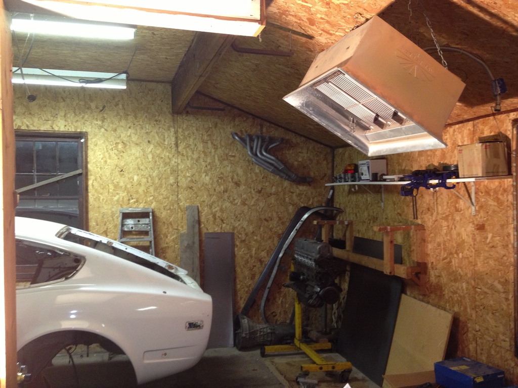

Friend from work donated an industrial heater he had laying around, which made working on the car so much easier during these freezing months:

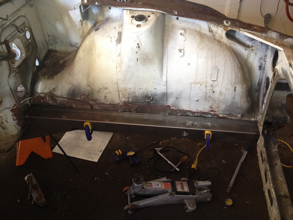

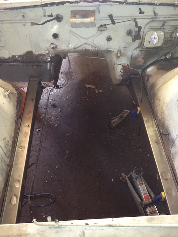

After much cutting and spot weld separation I was finally able to test fit the Zed Findings front rails, here is a quick before and after.

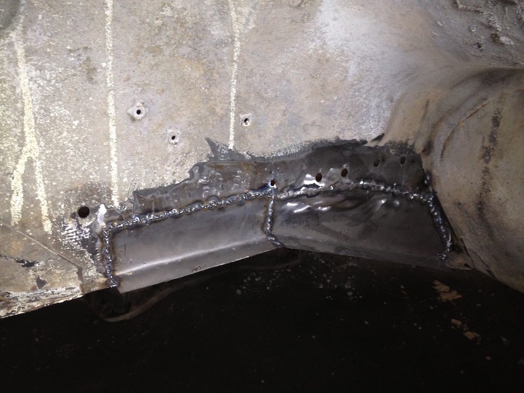

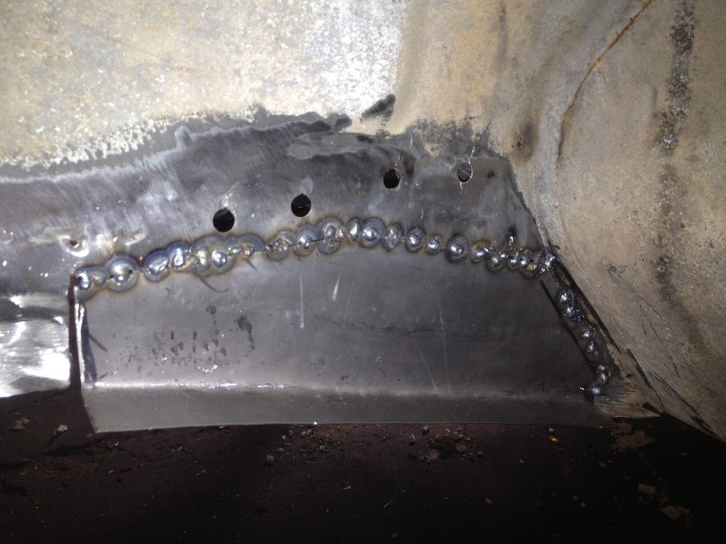

Before the new rails go in I had to make some repairs to heavily corroded areas.

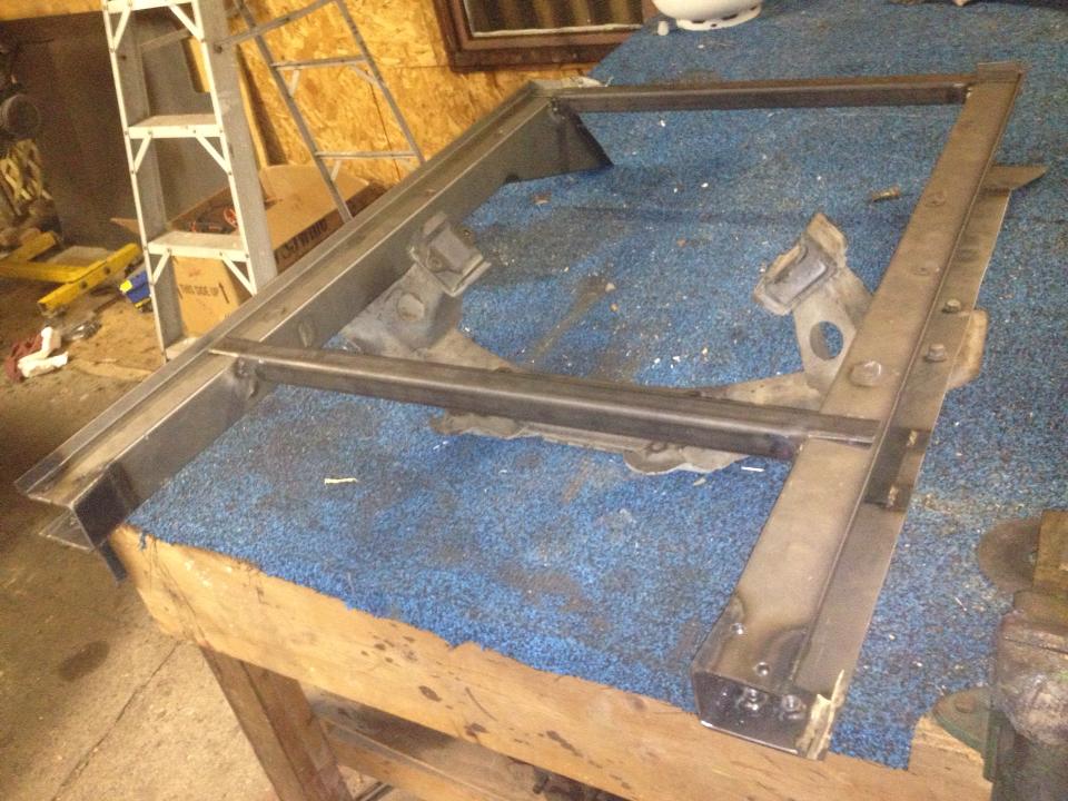

I put together a jig to hold the new frame rails in place.
