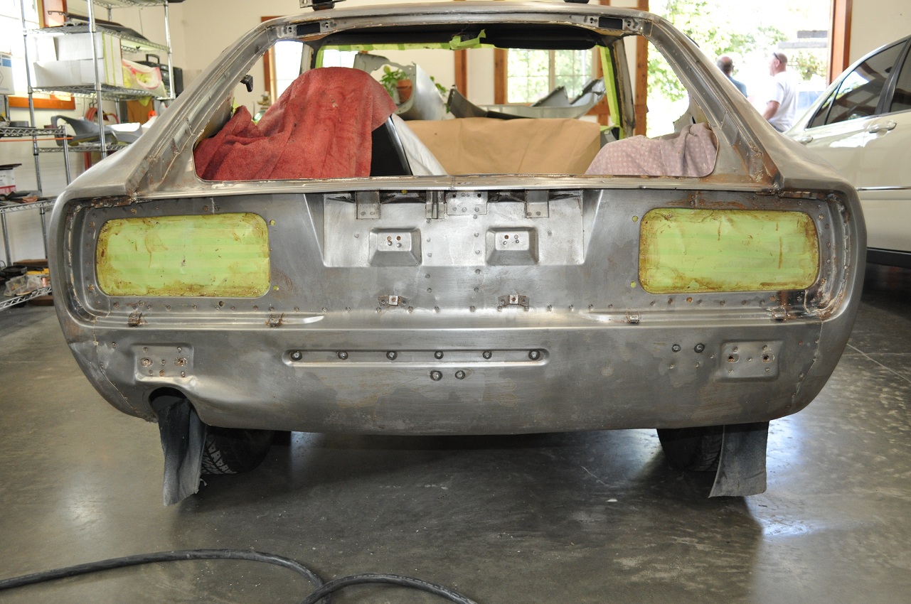

Could someone tell me what is on the rear lower panel below the bumper. There is a strip a foot or so long with 5 or 6 holes in it below the bumper. I can't remember and I can't find any pictures of what goes there. there are 2 holes below that and 2 holes off to the 1 side also. Any help on what goes there? I'm not talking about bumper holes. Thank you.

I know, I forgot to put year. 71 series one, thanks

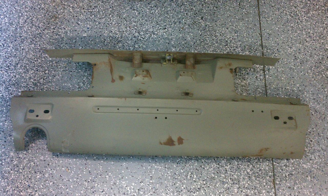

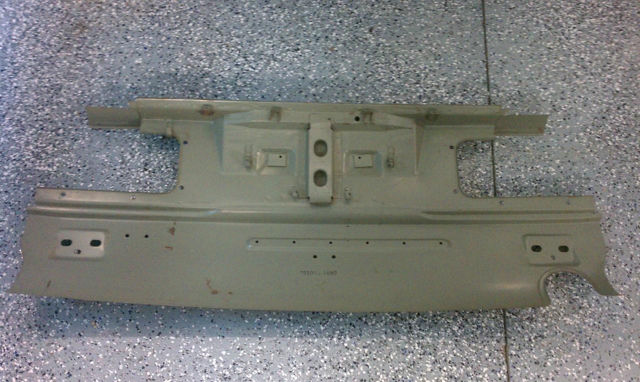

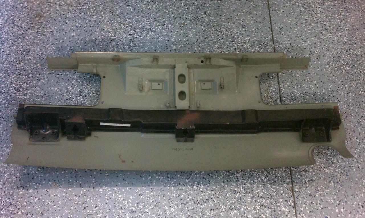

It sounds to me like you referring to the welds that attach the rear panel to the rear cross member. If that is the case, nothing goes there. If you are referring to other holes, they are not stock.
-Mike
Mike,
I really appreciate your pictures of both sides of the valence as I have been trying to decide if I have the welding skills to replace mine.

Thank you very much Mike, and others. The PO had done something to it, but I had to cut my back panel out completely and do some repairs. It's welded back in and looks great. Except for the welds your talking about. I guess I should have known that. Thanks again.
