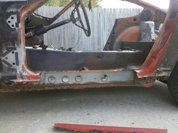

Brief update: I checked out the drain areas at the front of the channel, you're right, it appears that they were blocked by some caulk or sealer or something, which would have pooled water in there an eventually rusted through. Like it has.
I've decided to take out the front windshield to try to trace the water source back to it's origin, it appears the seal was not very good and water was able to get in around the top there is also a spot on either side that looks like it would have allowed water in, so I'm going to get some new seals and really seal it in there.
Also, I've decided to weld new sheet metal into some of the areas where the water was pooling, but also to leave some open for better drainage. Then I'm going over it all with some anti rust paint like POR or something to that effect.
Again, thanks to everyone for all your great help!
  • 4 weeks later...

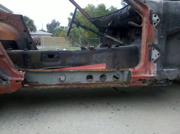

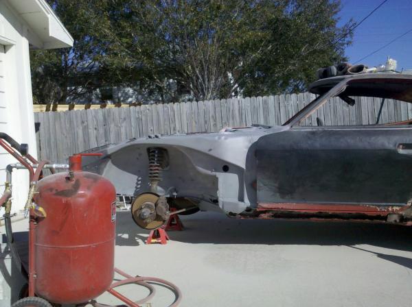

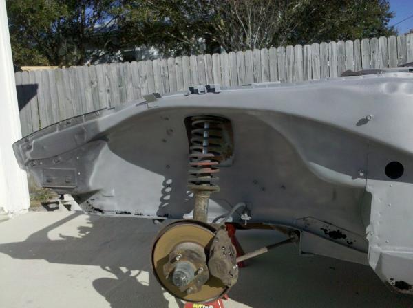

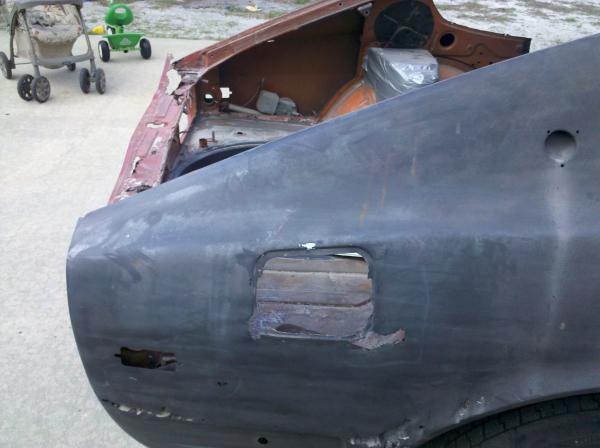

Another quick update: decided on and finished most of the following:
open everything I can up, take off as much as possible and find source of rust.
-it appears to be coming from the roof, so all new seals are now here
cut out worst of the rust and grind away at more. fill with epoxy or weld in metal depending on size. Bondo over that and sand down bondo to get smooth surface
lightly sand entire body and wrap in vinyl (I'm going with matte black)
-this will be cheaper than a good paint job, and will last until I can afford a good paint job
Everything is done now except for the wrapping, which is tricky, but will only take another day of solid work.
-this is taking so long because I'm working double shifts and just got on break from school, which meant finals and studying for them through last week.
I have pics of most of everything, not sure if anyone is interested to the level where I should post them. For the most part, I wanted to keep them as a record, but if anyone wants to see, I can post them here or link you to them on my dropbox folder.
