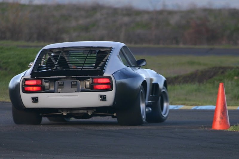

A simple roll and I run 245/45/16 on 8-inch rims - street. With CP flares we run 10-inch wheels with 275 Hoosiers - race car.

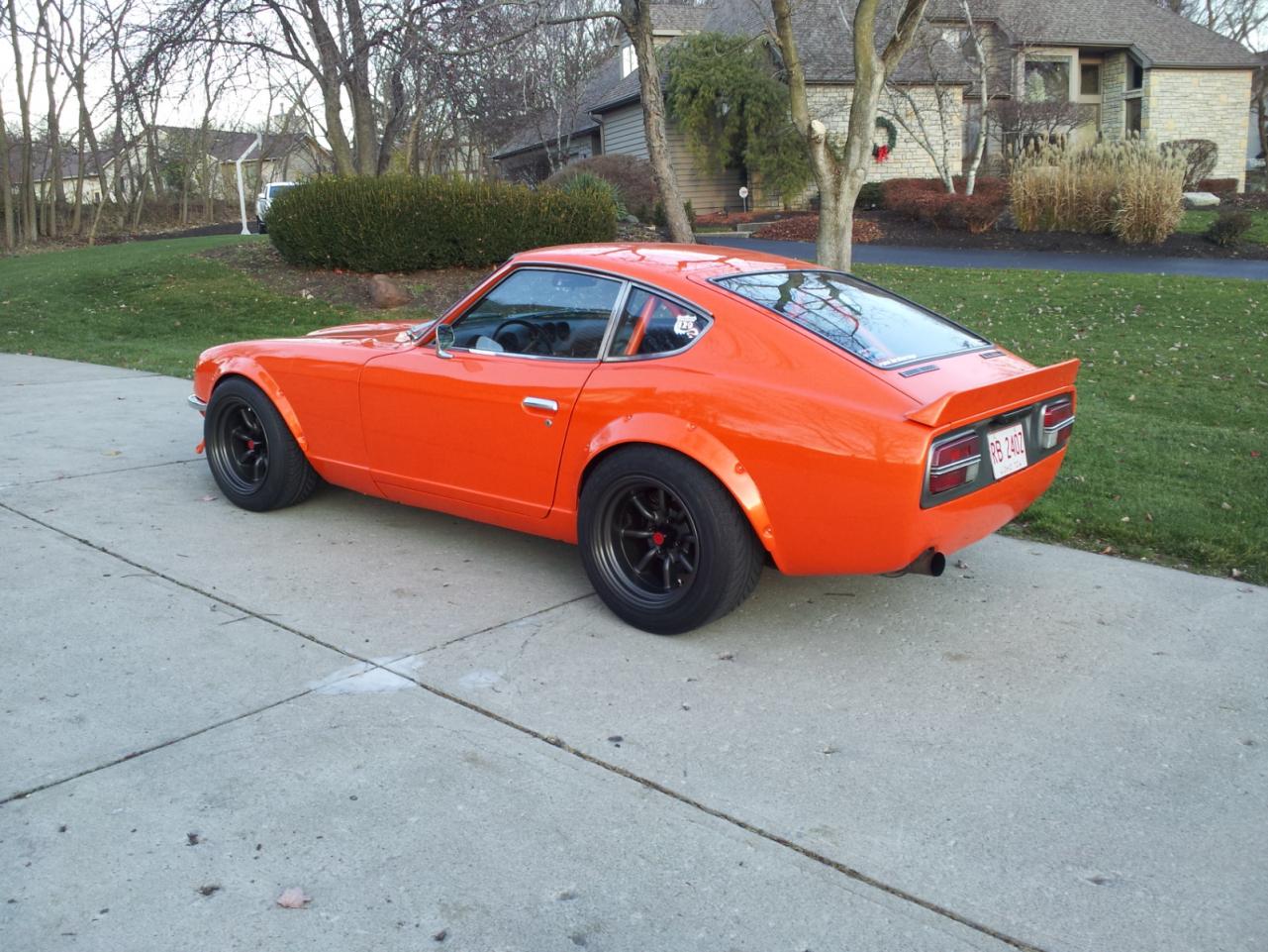

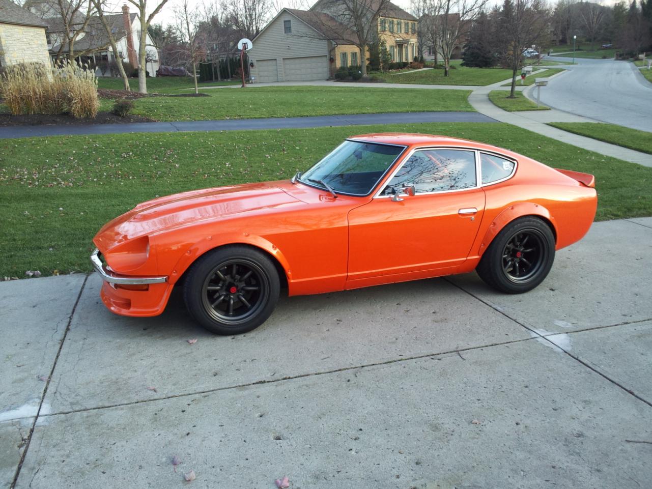

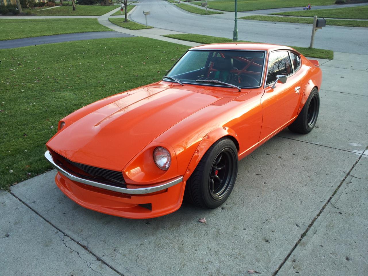

I went with the following wheel/tire combination
Fronts are Watanabe 16X9 -13 offset, 4X114.3 lug. Tires are Mich Pilot Sport A/S plus 225/50ZR-16
Rear are Watanabe 16X9.5 -19 offset, 4X114.3 lug. Tires are Mich Pilot Sport A/S plus 245/50ZR-16
Lots of mods to accept bigger wheels. Struts/springs/hubs/camber plates/:)...
Gord
[ATTACH=CONFIG]59303[/ATTACH]
[ATTACH=CONFIG]59304[/ATTACH]
[ATTACH=CONFIG]59305[/ATTACH]
Gord
Nice looking ride!
Those tires with those flares don't necessarily warrant all your listed mods. Those offsets and tire sizes should work with stock springs and shocks.
