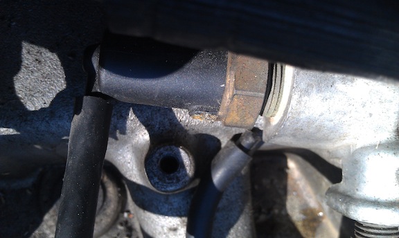

when i took the rail off i found a broken tube that was glued back on:
is this important?
i need it to pass smog so i can get my pink. anything else i can do to help pass? might have a shop help me out with this one.
Thats the Thermal vacuum switch. I broke mine too. There around $20 at Advance I think, used on many cars too. Couldn't get mine out so I did away with that whole coolant plate but I've no smog monsters here in Alabama. google it. glue it back in just don't stop up the hole. should pass, thing switches from ported vacuum to manifold vacuum after it heats up, I THINK. Not positive on that though
Edited by siteunseen
Siteunseen is right. Its the Thermal Vacuum Valve for the EGR valve. If you cant remove the EGR because of smog regulations in your state then try to repair or replace it:disappoin
The TVV doesn't allow vacuum to the EGR untill temp is above 45degC, 110degF.
The EGR doesn't work at idle or full throttle because their is to little vacuum to open it. The other condition is if the exhaust pressure is under +/- 30mmH2O the BPT valve won't let the vacuum open the EGR.
I had to order the screws when I replaced them. Took about a week to get them. You would think something like that would be standard, but apparently not:ermm:
Ace Hardware has a good selection of metric screws. You could probably find one that will do the job and replace them later if you want the hex head factory screws. A Phillips head screw isn't going to corrode in place and bind up in a few days.
Any hardware or electronics supply store will have them. You could also try allen head screws.
Size: M5x30mm.thread pitch 1.0mm
no i think i'll just glue it back, hehe. seems like it'll be fine.
should i be worried that it won't pass smog? it didn't smoke or anything but did shoot crud out of the exhaust before parking it. i thought maybe the leak was the culprit.
