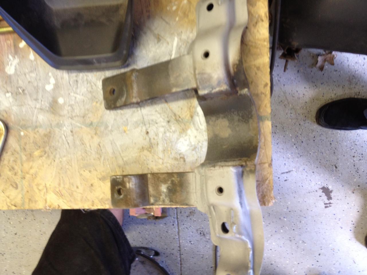

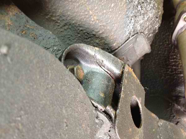

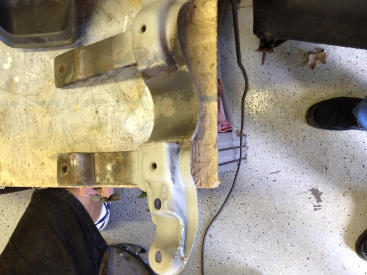

This was my clonking noise [ATTACH=CONFIG]57709[/ATTACH] and the remedy [ATTACH=CONFIG]57711[/ATTACH] only did it on reverse and was driving me nuts ;)

It looks like yours would be a one clunk as the part moved and until next reverse no problem. My clunking is "rotational" it clunks repeatedly and in direct relevance to the speed you are backing. Are we talking the same clunking?

Mine was more acute on reverse and if I hammer her , the clonk was there, after the magical weld no more clonk and I drive her hard at times, she likes it and she was overbuilt to take it . Metal fatigue , that mount is 40 yrs old ( well most of it , there was a mod made for the Q45 diff) , I have secure a spare just in case ;)
