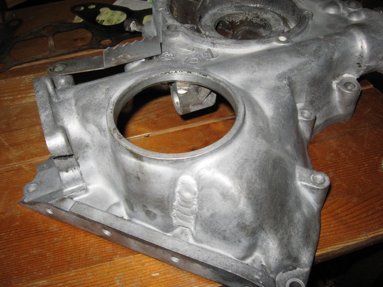

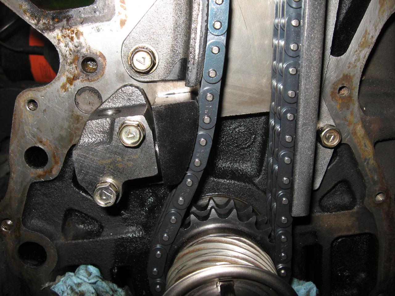

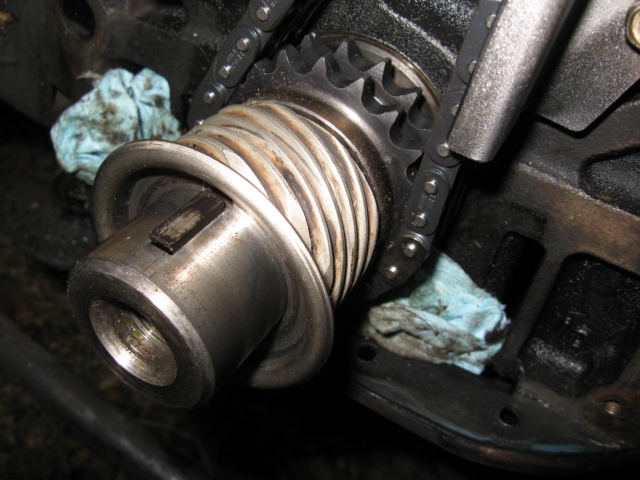

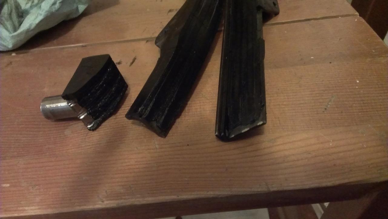

July 24, 201213 yr Author comment_396632 My bad, I though you were saying you could save it . Since it is difficult with pictures to really tell if the gasket is in shape, I just provided a comment. Good to hear for sure it will be replaced. No worries, My photos have not been that great. (my camera is starting to get greasy). If you need another cover let me know. Thanks but my old one is now repaired. My coworker even soda blasted it. He said it was to dirty to weld. I will post pics of it tomorrow. The old guides and tensioner: One strange thing that I noticed was that the bright links on the chain did not line up with the number 1 dimple on the cam sprocket. as a matter of fact the dimple was between two links. This may not matter as long as who ever installed the chain last counted the links correctly. Another strange thing was that I could find no dimple on the crank sprocket. At least till I removed it and found that the dimple was there just on the engine side not facing out. So now I am wondering how off my mechanical timing has been this whole time. Just a thought, Could improper mechanical timing have an impact on compression readings? Edited July 24, 201213 yr by grantf Link to comment https://www.classiczcars.com/forums/topic/43803-bad-noise-comming-from-valve-cover/?&page=5#findComment-396632 Share on other sites More sharing options...
July 24, 201213 yr comment_396635 Wow, the old tensioner and guides are toast. Your engine will be easier to time now that the crank sprocket is around the correct way, and you just might unleash a few more ponies. Link to comment https://www.classiczcars.com/forums/topic/43803-bad-noise-comming-from-valve-cover/?&page=5#findComment-396635 Share on other sites More sharing options...
July 24, 201213 yr Author comment_396641 Wow, the old tensioner and guides are toast. Your engine will be easier to time now that the crank sprocket is around the correct way, and you just might unleash a few more ponies.Yes very toasty. Note the worn metal on the chain tensioner, I think this may have been the source of the sound!Ok new question: Which way is the oil slinger "oil thrower" installed cupped toward the engine or front of car? or just leave it off? Edited July 24, 201213 yr by grantf Link to comment https://www.classiczcars.com/forums/topic/43803-bad-noise-comming-from-valve-cover/?&page=5#findComment-396641 Share on other sites More sharing options...

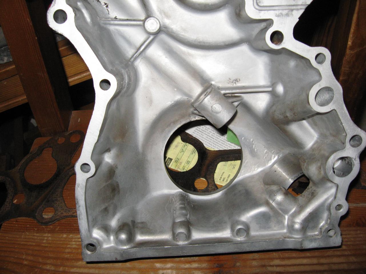

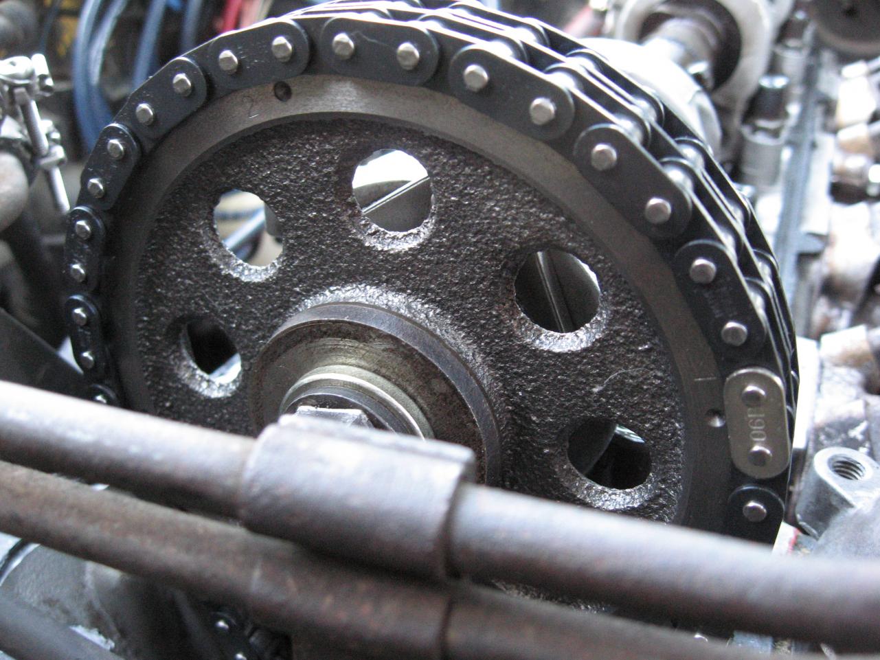

July 25, 201213 yr Author comment_396706 Progress today! First off I got the front cover back: If I did not work with a professional machine and weld guy I would have replaced the cover, but I am happy with the outcome. Also the timing set arrived today: I am happy that the mechanical timing is now correct and the chain is installed correctly. I think I noticed another error from who ever installed the last chain. The top of the passenger side tensioner was left slack I could tell from the bolt marks on it that it was tightened down in the loose position causing premature chain slack. Link to comment https://www.classiczcars.com/forums/topic/43803-bad-noise-comming-from-valve-cover/?&page=5#findComment-396706 Share on other sites More sharing options...
July 25, 201213 yr comment_396715 Looking good. Link to comment https://www.classiczcars.com/forums/topic/43803-bad-noise-comming-from-valve-cover/?&page=5#findComment-396715 Share on other sites More sharing options...
July 25, 201213 yr comment_396719 That FSM is handy for those kind of questions. Bet your ready to get it running!!! Link to comment https://www.classiczcars.com/forums/topic/43803-bad-noise-comming-from-valve-cover/?&page=5#findComment-396719 Share on other sites More sharing options...
July 25, 201213 yr comment_396720 Now that's a good looking timing chain! Can't wait for you to fire her up. Link to comment https://www.classiczcars.com/forums/topic/43803-bad-noise-comming-from-valve-cover/?&page=5#findComment-396720 Share on other sites More sharing options...

July 25, 201213 yr comment_396725 One question--- how did you get the cover so clean, inside and out? Link to comment https://www.classiczcars.com/forums/topic/43803-bad-noise-comming-from-valve-cover/?&page=5#findComment-396725 Share on other sites More sharing options...
