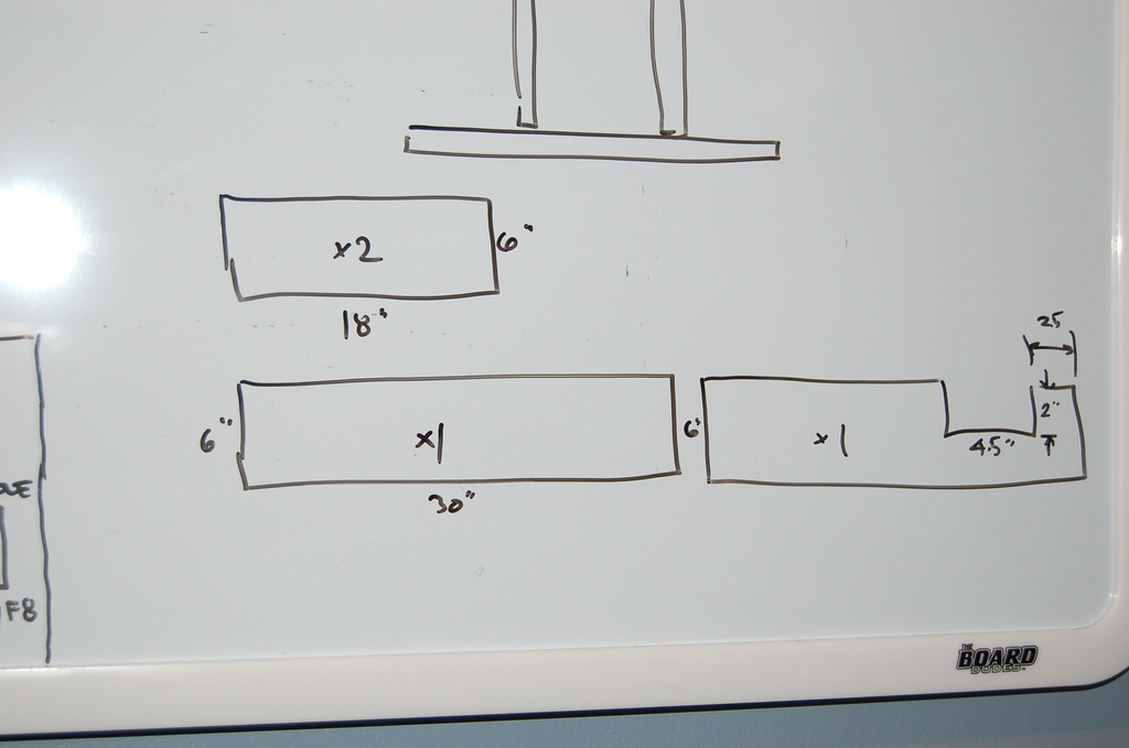

New engine cradle:
Plans dimensions for engine cradle.. You need a 2x6 8 feet long. You should cut it up into 2-18" boards, and 2-30" boards. One 30" board needs to have a notch cut in it 2.5" from one side. The notch should be 2.0" deep by 4.5" wide. Nail or screw the boards together with the 30" boards running length wise alongside the engine spaced 8.5" apart. This will sit on the oil pan flange nicely.
crude drawings of plans for cradle...
