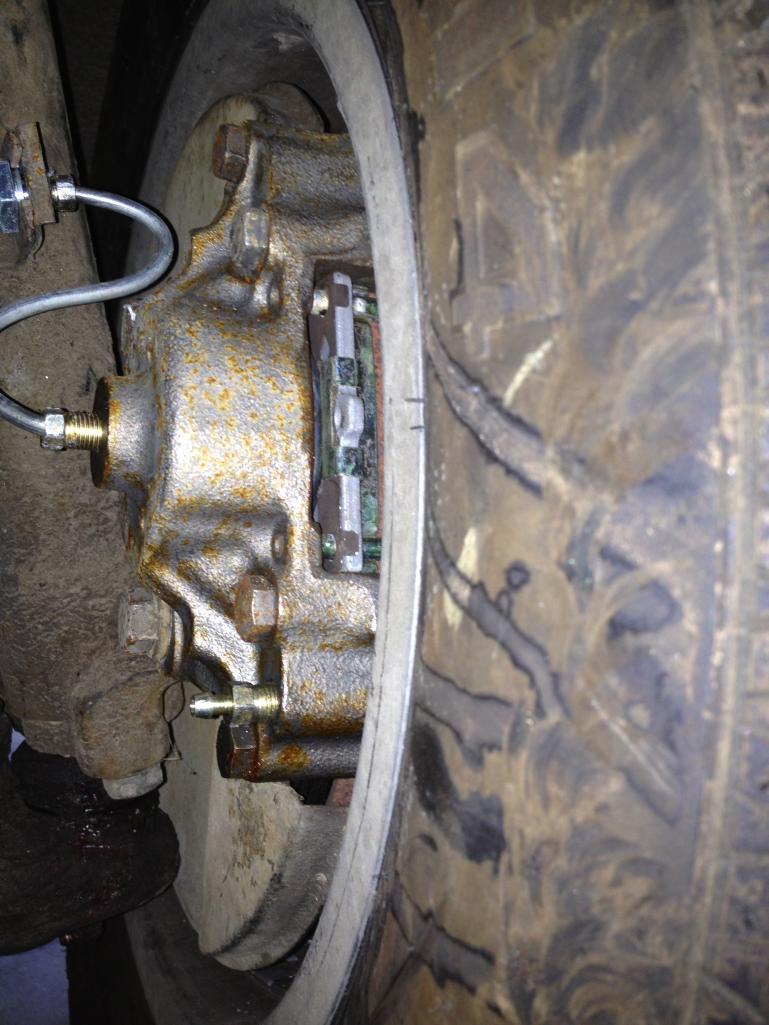

I had a similar problem (almost exactly, actually) when I got my car. The calipers were on the wrong sides. The bolt pattern is interchangeable, but they have to be mounted with the bleed valve on the top. If that's the case, just swap them quickly without letting the master reservoir leak down, give a quick bleed on the fronts only and you'll probably be golden.
I agree with Zed Head. While you're doing the brakes you might want to pull the proportioning valve off the firewall, disassemble it and clean it. They get a lot of gunk in there and stop working properly.
Chuck
First make sure that your calipers are on the correct side, with the bleeder pointing up as Zed Head said.

post-26127-14150818865866_thumb.jpg This is the right front wheel. Thanks for all the advice! I will swap the calipers, clean the proportioning valve and then re-blead as suggested. I appreciate the help and will report back on the progress.

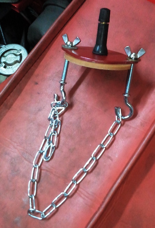

To bleed brakes now, I ended up building a tool made with a flat piece of steel, a seal bought at the hardware store, a valve I got at auto store, 2 hooks and a chain. I then use a fuel hose & 2 plugs so I can pressurize the brake system by using the pressure from a tire. I don't go over 1 bar (14 psi) to avoid exploding the tank because of too high pressure.
It's a very convenient tool & it works really well.
