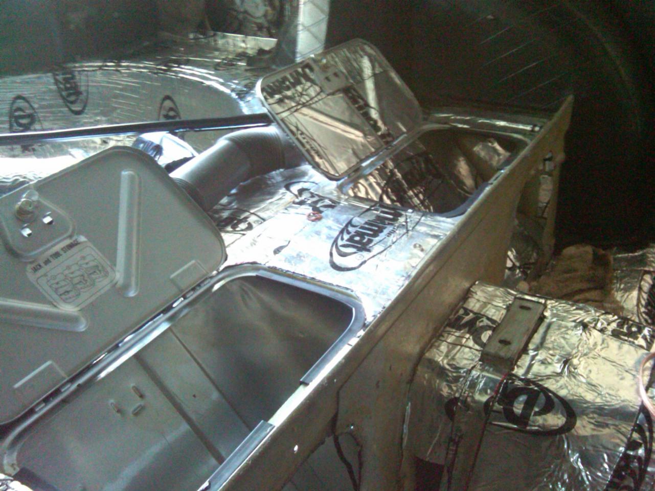

I'm in a similar mind set and going for a smooth ride cruiser Z and wanted a quiet solid sounding car. Went with Lizard Skin on the unibody, both sound and heat insulation. How does she sound? No idea... Need probably another year of weekends to find out...

Mike, PM sent with links to some gallery shots. Dave, when you knock on the panels prior to and after the insulation getting sprayed, the panels went from a ringing ping to a nice mid-tone with a steep fade off (no ringing)... So it might be worth it, don't know yet.

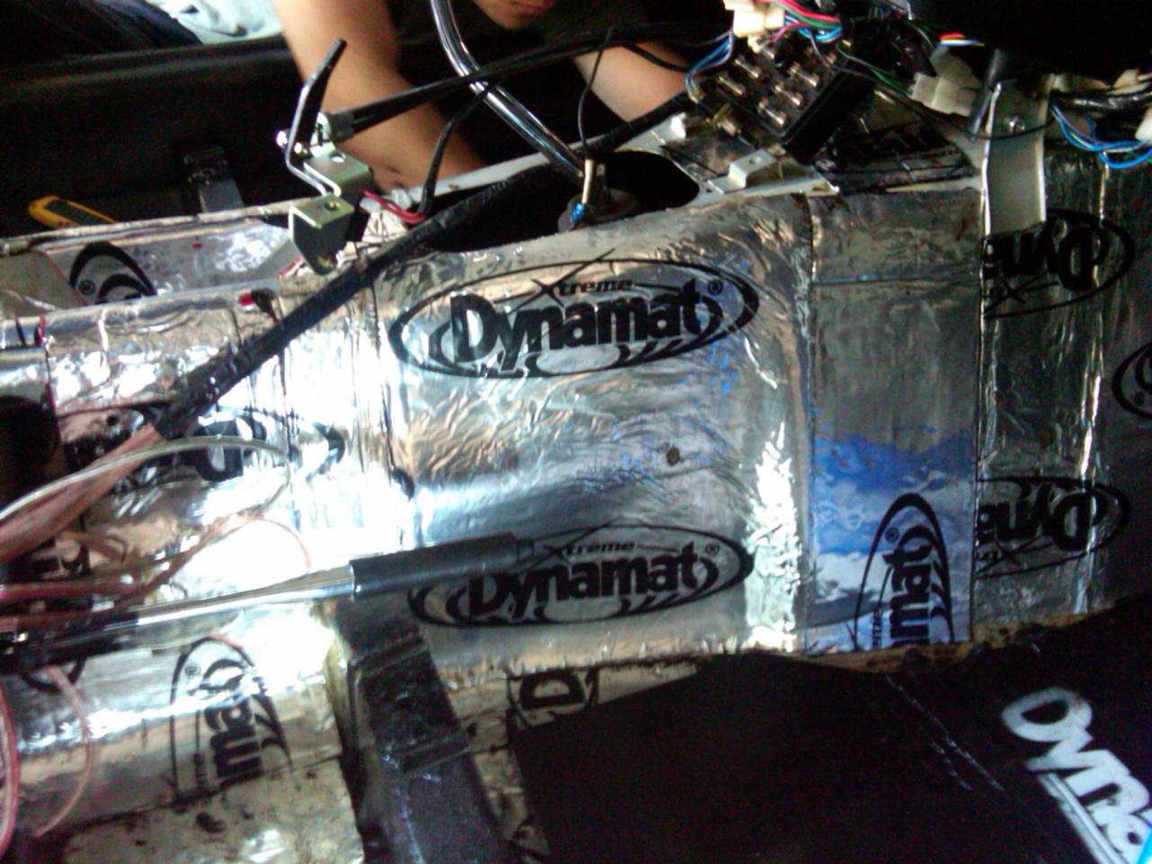

I was also seeking a quieter cabin, so a few years ago I put Dynamat on every surface that I could find, except for the headliner. I put it on the back of the interior plastic panels too, which stiffened them a lot. For the transmission tunnel I first installed Dynamat, and then .25" Dynaliner which is a foam material that sticks on. I used .5" Dynapad on the floors too. This was a lot of painstaking work, but the results are great. Much cooler and quieter.
