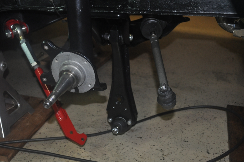

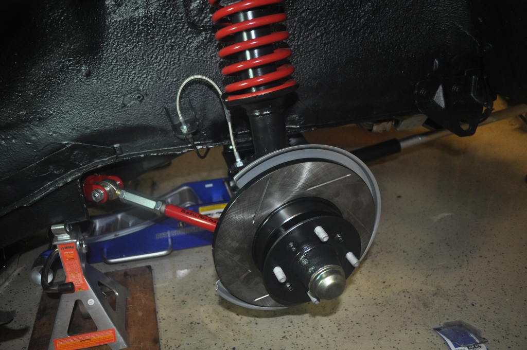

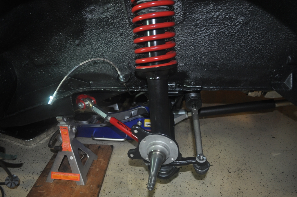

I just completed a total refresh of my front end, including brakes, master cylinder and booster, as well as an upgrade to the Techno Toy Tuning t/c rods.
They are an extremely well built upgrade to the stock t/c rods and also do give adjustability to caster. I did get a little concerned about using them after I read a number of nightmare stories where t/c rods were breaking due to the use of poly bushings on the rods. You are correct that the TTT rods bolt up to the frame member with no bushings at all, and that caused greater concern given the lack of any flexibility at the mounting point. Based on my concerns I did talk to Gabe at TTT about this. I believe that he is the owner as well as the designer of many of their products, and he assured me that I did not need to worry about this under any normal driving situation. He told me that the hime joint will absorb the energy from normal impacts and these would not be transmitted to the frame in any great amount.
So I installed them and set them at the closest setting that matched the OEM length. I had the car aligned right after this installation as I had also changed my rack and tie rod ends, but it turned out that the caster was pretty much where it was supposed to be so I really didn't get the benfit of having this adjustable.
I have only driven the car for less than 100 miles sinced I completed all of this work, but I can say for certain that responsiveness, tightness, etc are much better than before. I am not able to tell you the contribution of the new t/c rods to this improvement as there were so many other things that I changed / upgraded at the same time.
Finally, I can tell you they look great as well.
I've attached a few pictures so you can see them being installed on my car.
Mike.
