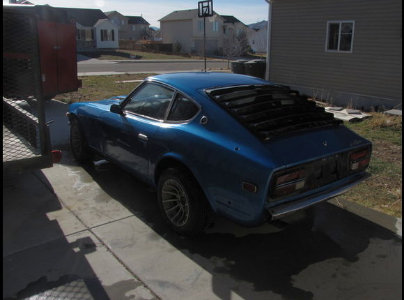

Looks like you have at the least done some homework. Check for rust (even with fresh paint). The car pictured has a 280z hood, missing rear bumper sides and a really strange looking front bumper (perhaps a front end incedent).

Agreed - the replacement hood and wonky front bumper suggests collision damage so give a good look where the hood mounts to the body and along the inner fenders / frame rails. How is the battery tray and surrounding area? Get inside and pull the carpets to check the floorboards all over and check the spare tire well. Run a magnet along the rocker panels and at the dogleg area. Check for rust on the tray under the hatch. Any repair records available from said mechanic? With a running engine but non-driver status, ratted-out interior, and visible exterior cosmetic items this is probably a $1500-1800 car IF you do not find other issues with your inspection. Remember - as a non-driver, you can't check out the driveline, brakes, steering, suspension. As the man said, good luck.

Another thing to look at closely - the rear louvers pictured are the type that require holes drilled in the tailgate for the hinges and lower latches. Those holes are a prime spot to develop rust.

I thought that the hood was wrong, but the seller isn't all that knowledgeable. He knew enough to know that when the car was going to be junked that it was a shame, but I don't think he's that familiar with the series. Also, shouldn't there be turn signals under the front bumper?
