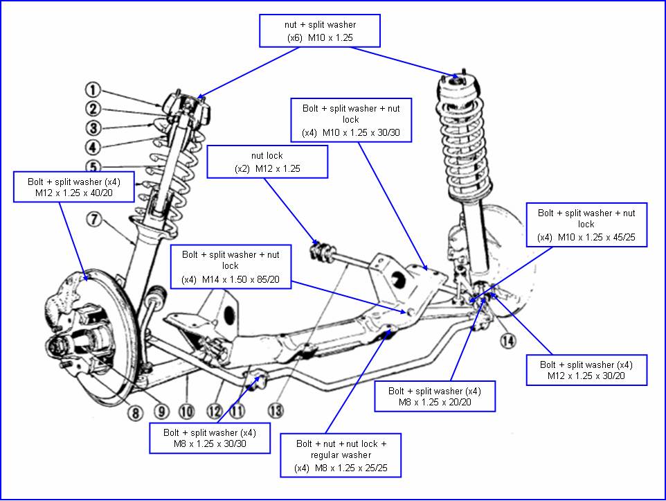

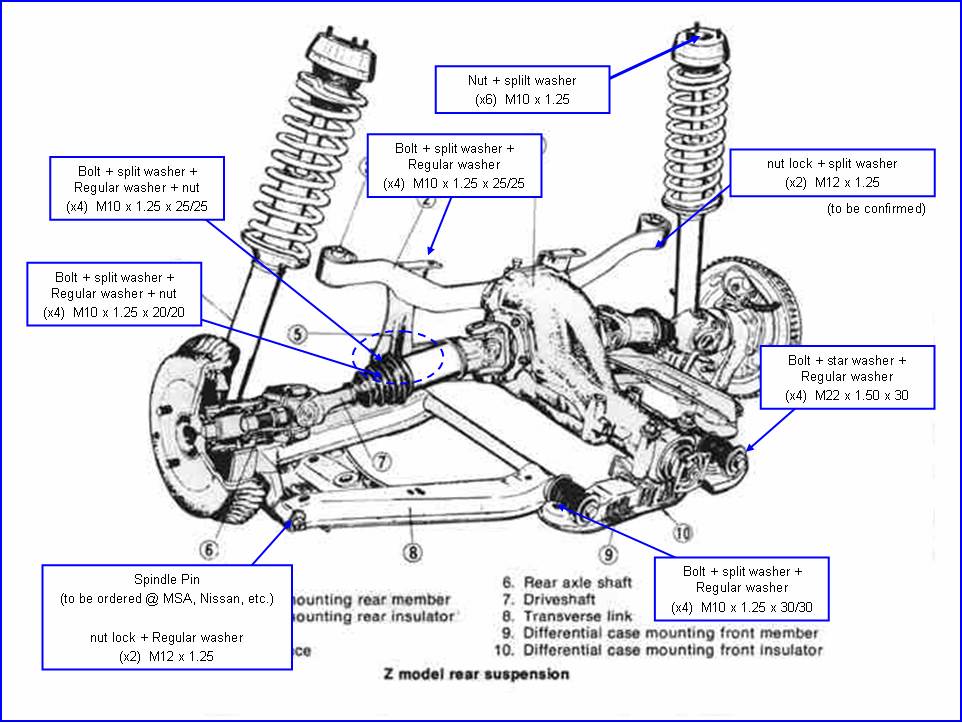

Check for size BUT also for grades! I've taken bolt in 10.9 form & nuts in grade 10.
I went thru the process last year, 100% of my suspension bolts are new. I wouldn't use also old bolts if you have the choice ;)
I did my own researchs to gather all the data, did a group buy locally (in France) to spread the cost with high volume, full suspension kit came up at 50€ total per person :)
See attached the file that should be helpful for everyones ;)
Credits are also for z240 on Hybridz who help me making this list
=> Suspension Bolts
