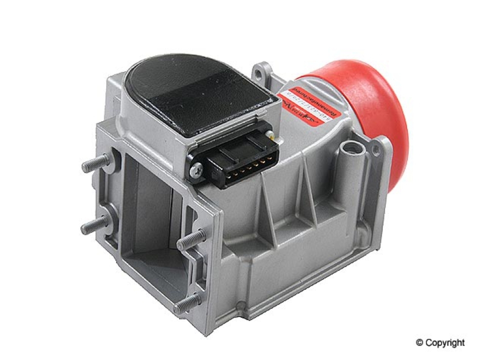

[i think I'll try the Cressida AFM swap, if I can locate one that fits what's in the wallet. Is the 83 model-year unit the only one? The 1983 Land cruiser AFM (4.2L engine) has a similar design
Also, Some of the Ceressida AFMs you see on eBay have a tubular design, and state it's for the 1983 engine.
[ATTACH=CONFIG]59806[/ATTACH]
[ATTACH=CONFIG]59805[/ATTACH] (eBay auction link)
I found this info about the cressida AFM. the AFM is p/n: 8208-22250 and the round thingy is p/n: 8208-17875? Or it might be something else.
(8208- )
Page 2 - 1983 Toyota Cressida 11148 17-03 Air Cleaner Parts
http://www.dragtimes.com/parts/OEM-83-84-TOYOTA-CRESSIDA-AIR-FLOW-METER-22250-43140_160528909071.html
Edited by EuroDat
Second link didnt work
There seems to be only one thing left ot of the Cressida AFM swap. The inlet side of the AFM doesn't have the round connector for the air ducting. I think you could just use the one from the Datsun AFM, but I would have to dig up my spare AFM and confirm it.
