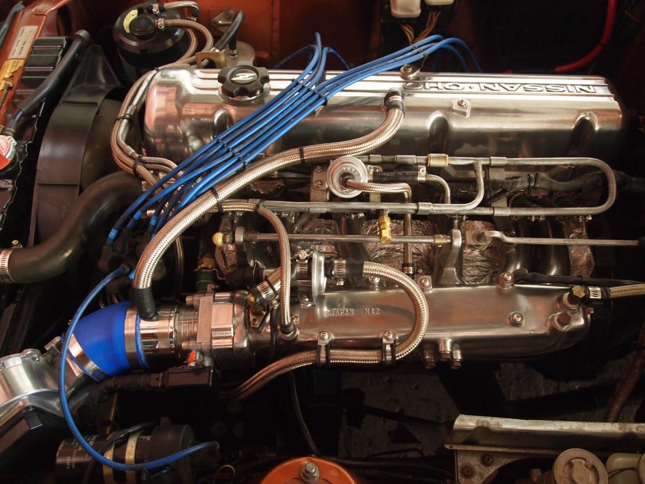

Started by polishing and porting an N42 Manifold to a 60mm throttlebody and spacer. Began to build a billet fuel rail, but my experiences with ethanol and aluminum have taught me they don't mix. I might have the steel rail chromed at some point. Anyway...Rerouted the FI harness from the firewall and from the coil area. Bought new injectors. Removed the CSI, AAV, and thermotine switch. Used an intake tube adapter with vacuum ports to install the valve cover breather and dist. vacuum lines. Also polished thermostat housing and AFM.

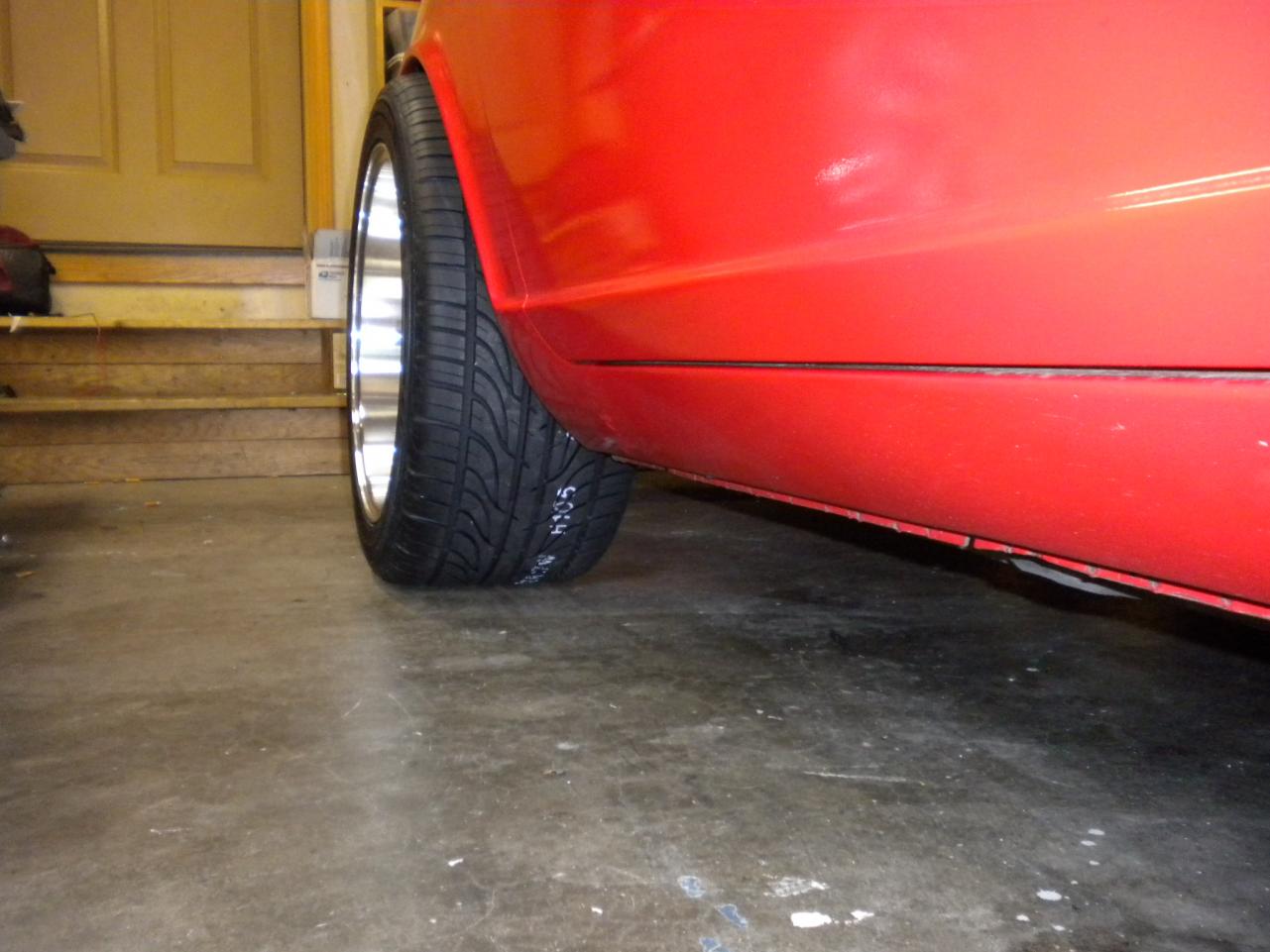

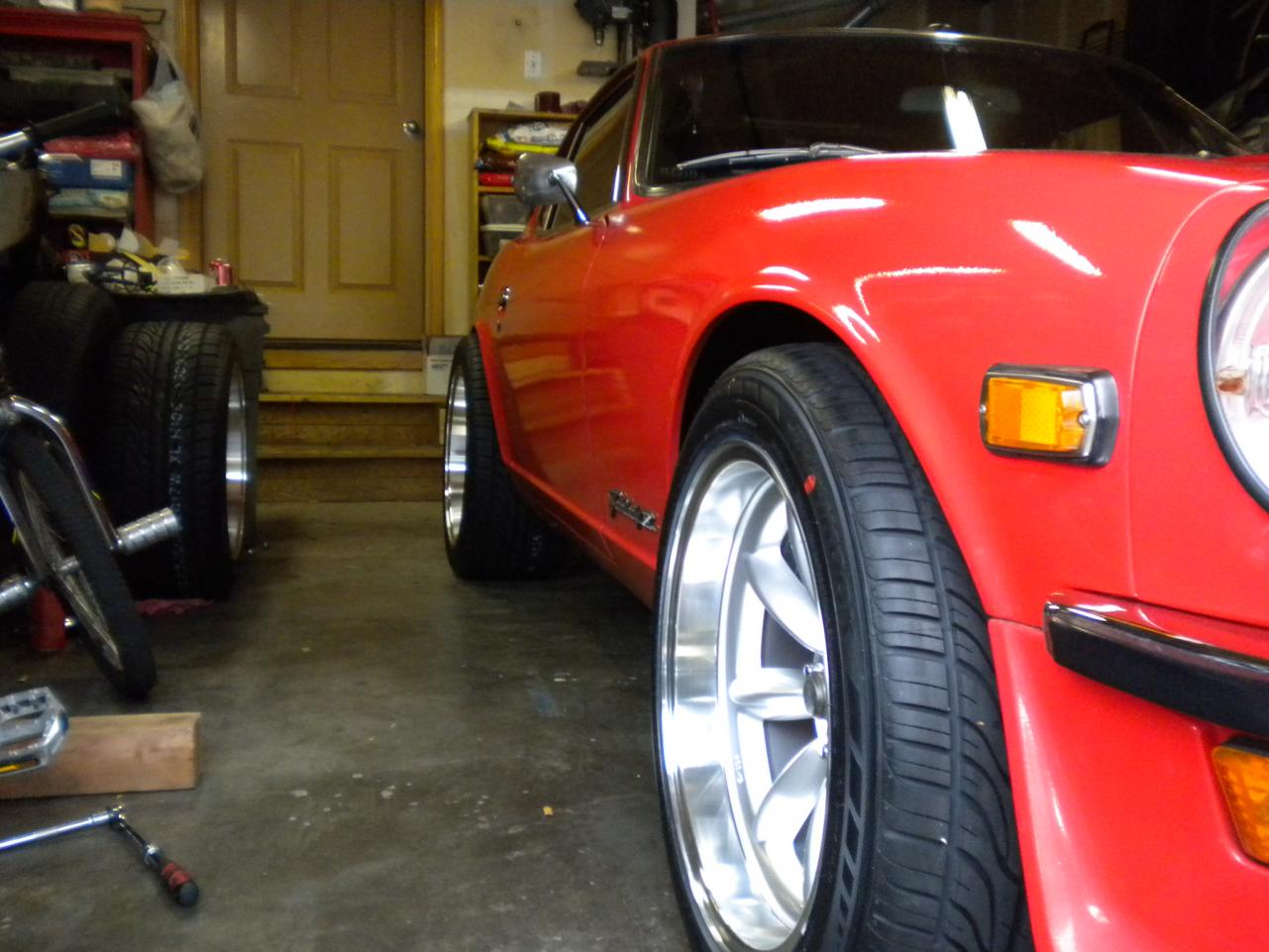

I will be going to the MSA Zcar event at the end of April. And with that, I've decided to use the 17x9.5" Rota's with 275/40ZR17's in the rear and 245/45ZR17's in the front. The problem is they WILL RUB with a full tank of gas,luggage and passenger.....
So my big contemplation is to cut the fenders a bit, for clearance and instal the ZG flares. It's gut renching to think of cutting into my baby but I LOVE THESE WHEELS so much!!! If I do it right and tastefull, it will be worth it. But should I ever decide to change, I'm screwed.
I'll likely do it either way as my heart is really set on doing the ZG Fender flares and wide wheels. But I thought I'd see what you guys thought, or at least get it out there in script so I can look back and say "Well, at least I thought about it first, this time"

I'm not in love with ZG flares, Dave, but I don't hate 'em either. And I will say that IMO the Rotas are WAAAAY better looking than the Centerlines.

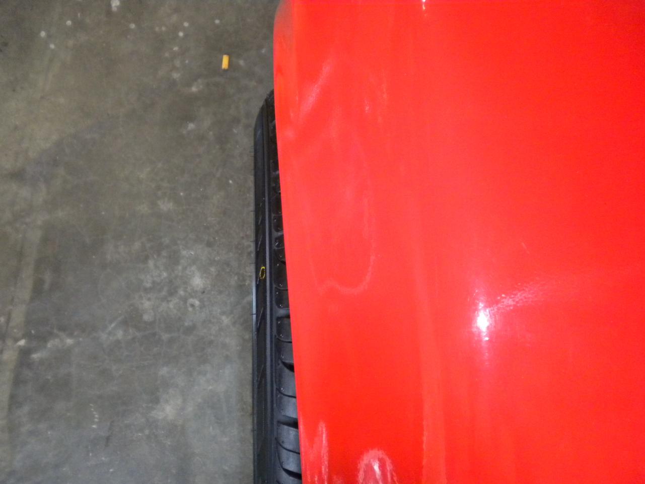

Here's my issue(s)
Rears rub when the car is loaded and with dips in the road and do stick out about 1.25 to 1.5 inches.
Fronts barely stick out but will rub on dips in the road at higher speeds.
