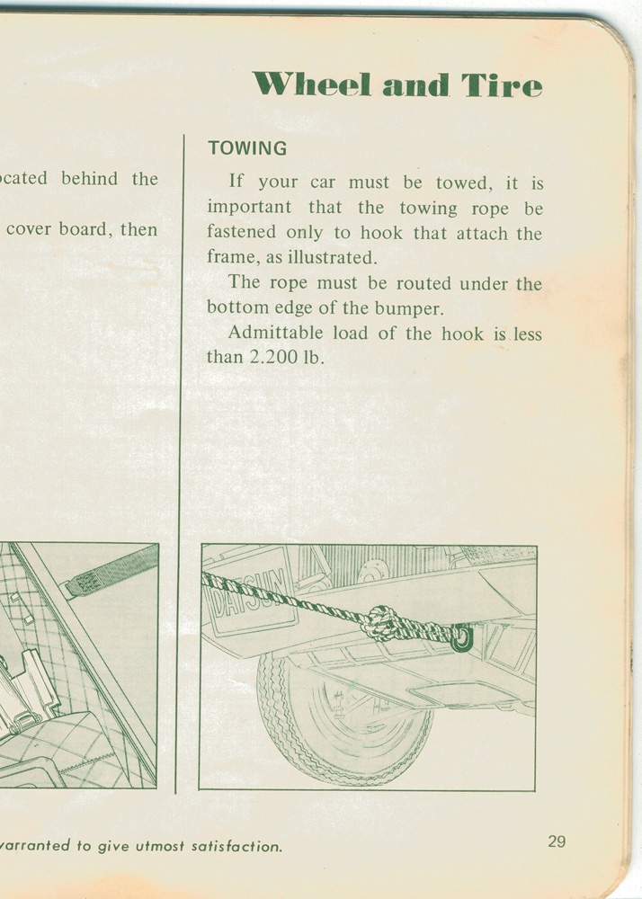

Ahhh...owner's manual has the answer - page 29.
