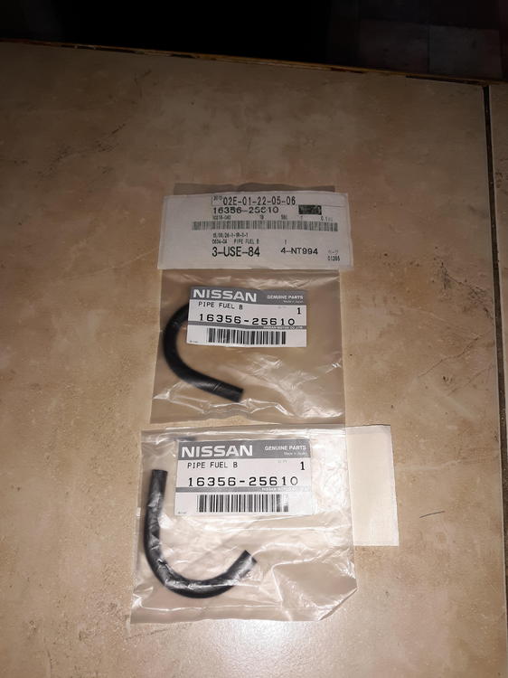

 thank you so much for the reply I'm going to check the height of the float and someone said to replace the hose on the bottom of the floats they get old and suck in restricting fuel
You are welcome and correct on those hoses. They're still available from your local dealership if you ask them to search by part number, not car.
