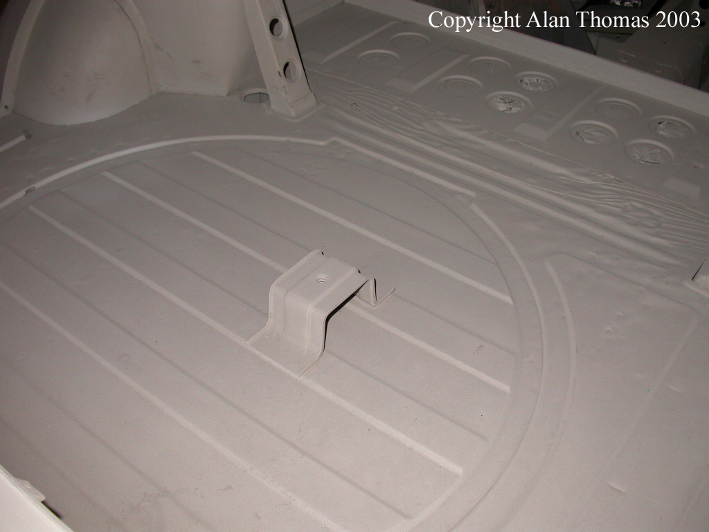

JDM-car-parts.com is offering this http://jdm-car-parts.com/item-for-sale/z432-z432r-fairlady-z-flat-panel/. They're not offering a fuel tank to mach, but the tank doesn't look too difficult to replicate as it seems to be constructed from two end plates and a piece of sheetmetal wrapped around.
This is a picture Kats posted,thanks Kats!
I assume the hight and dept of the fuel tank to be the same as the standarad 60 liter tank so the dimensions are somewhat easy to estimate. It would be nice to know the correct measurements though.
If you have any information on, or pictures of the tank, please post them!

Is the pressing profile of the panel in the advertisement correct?
The ribbed profile is correct ( although it does not have the spare wheel retaining clamp bracket on it ), but the description is mistaken;
'PS30' model 'Fairlady Z432' had the 'normal' spare wheel well and 60 litre tank same as all other S30 models it was contemporary with. Only the 'PS30-SB' model 'Fairlady Z432-R' model had the deleted spare wheel well, flat top panel and 100 litre tank. Nissan works rally cars and works circuit race cars got the flat floor and 100 litre tank too, but with a slightly different tank on the rally cars.
Surprising that 'JDM Car Parts' says the normal 432 had the ribbed "flat" floor and 100 litre tank. That's not correct.

Hello Alan,
There was an error on our thred. Only Z432 R had 100 Litter gas tank. I am sorry for the confusion.
We currently do not have this flat panel kit for Z432 R due to incredible "hand made" cost from Japan. It sure comes with spare tire braket, which does not appear in our picture.
However, we can have exact duplicated gas tank and straps made in Japan if you have lots of $ to spare..........:ogre:
