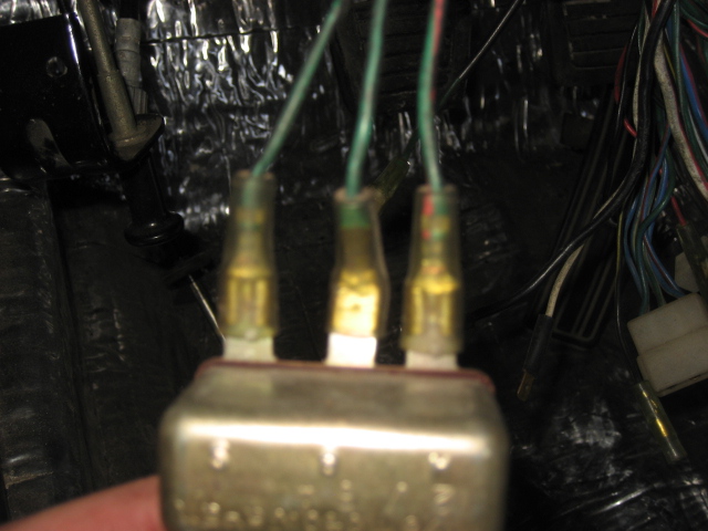

Am trying to install some new interior light door switches in my 1970 240z and had to remove the kickpanel to access the switch. In the process, I had to disconnect the relay switch that is suspended from the hood cable release mounting in the car. While there, I had the brilliant idea of disconnecting the wires from the relay in order to clean the contacts, but failed to label the wires for re-connect. This relay has 3 wires, and has labels that read "H", "B", and "S" on it. I could sure use some help on determining what the purpose of this relay is, and, more importantly, in finding out which wire connects to which contact on the relay.

After scanning the FSM from Zedhead's link, it looks as though this relay is for the horn. There are 3 wires in total, 2 green ones and one green/red wire. If this is, in fact, a switch for the horn and no other purpose, I would just need to know which wires to attach to the respective terminals on the relay.
It is the horn relay. "H" is to the horns. "B" is the power from the battery. "S" is the switched lead from the horn button. The relay must be mounted directly to the body as it is self-grounding.

I think your mechanic is correct. The "L" probably means "Load". My car only has the one single relay on that side.
Green/black on the left, Green center, Green/Red on the right.
Hope that clears it up.
